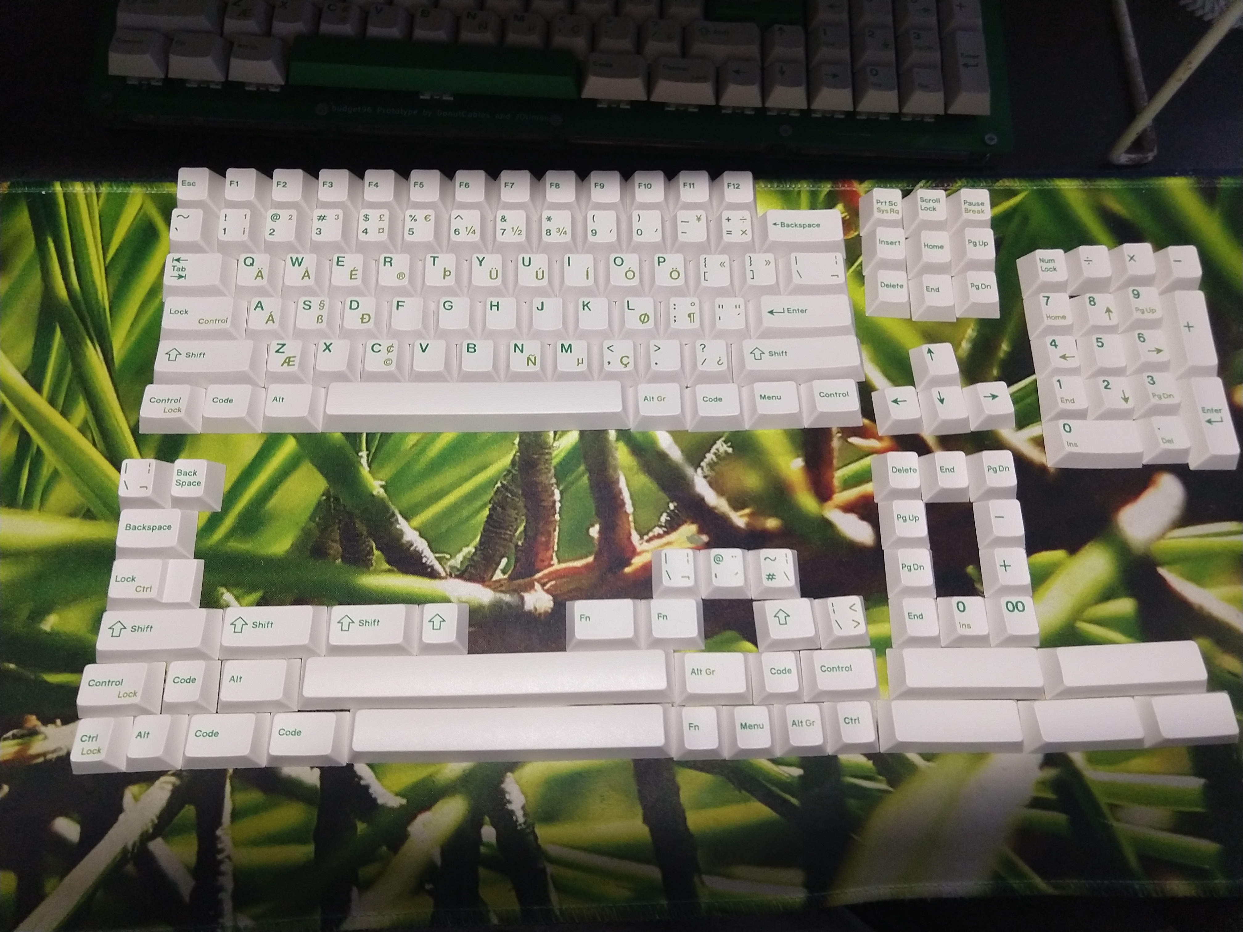

Got a chance to open the set up and see what’s what:
Base kit - notice I’m missing the ISO Enter

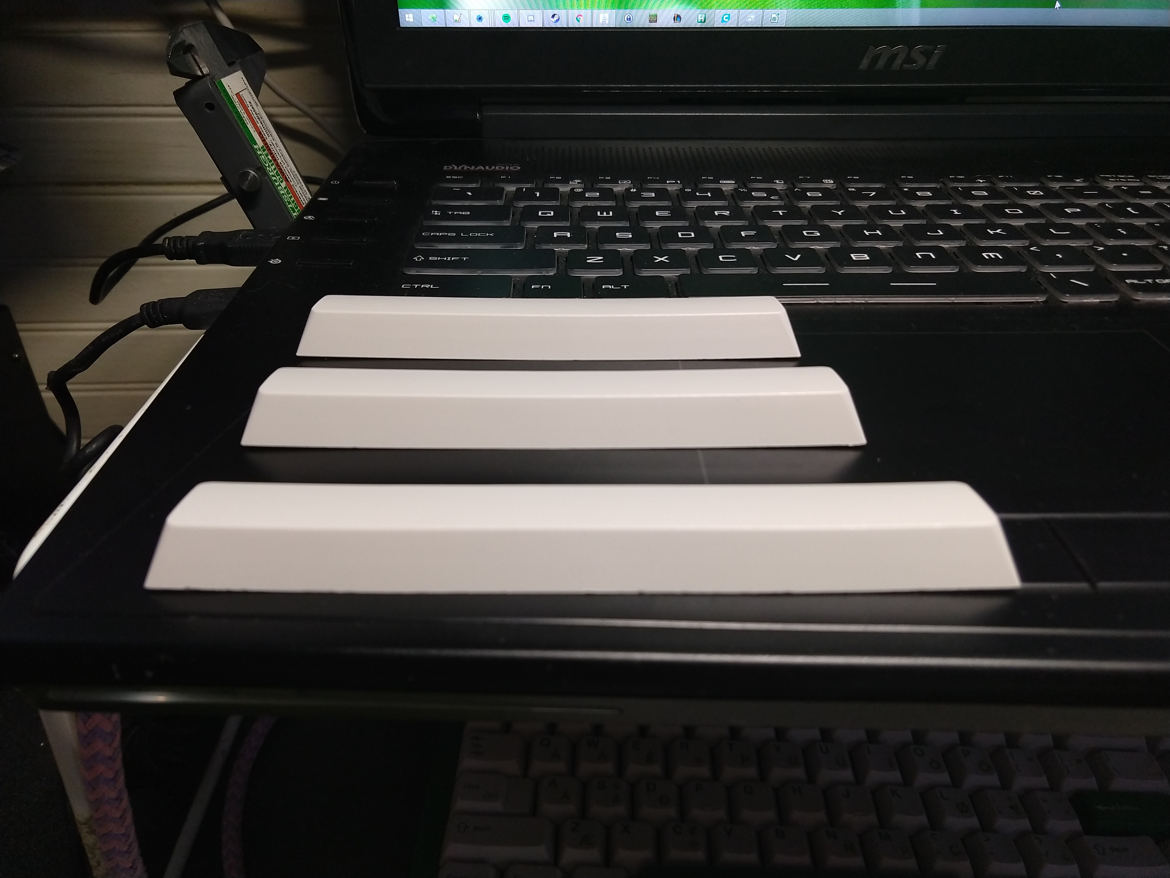

Looking at warping in the big spacebars

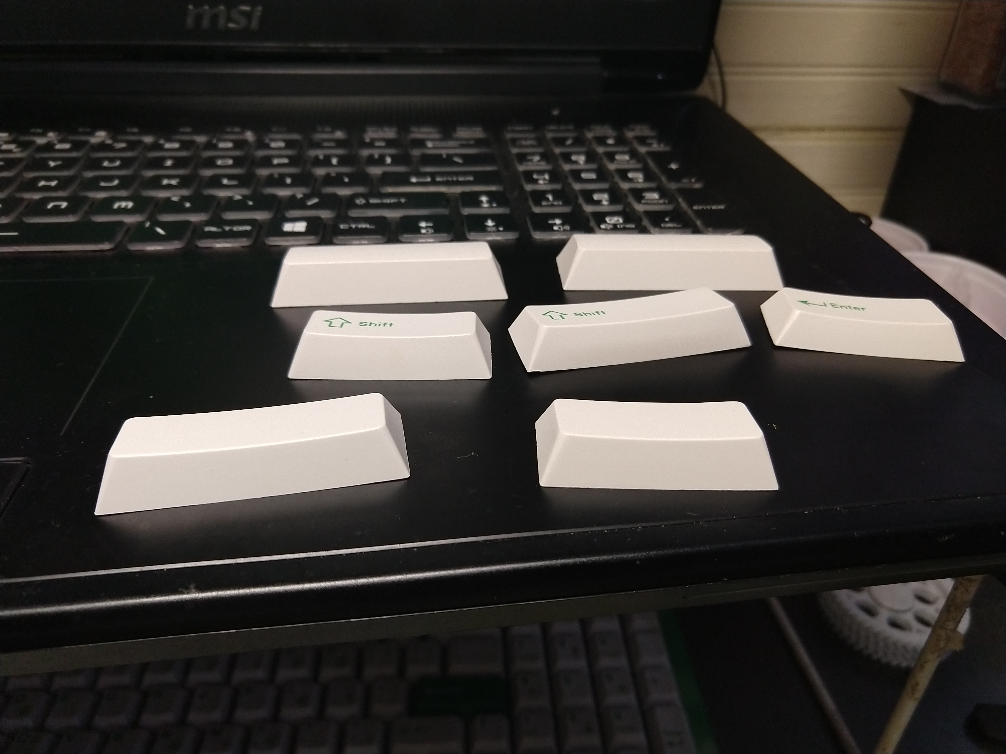

Loooking at warping in the other longer keys

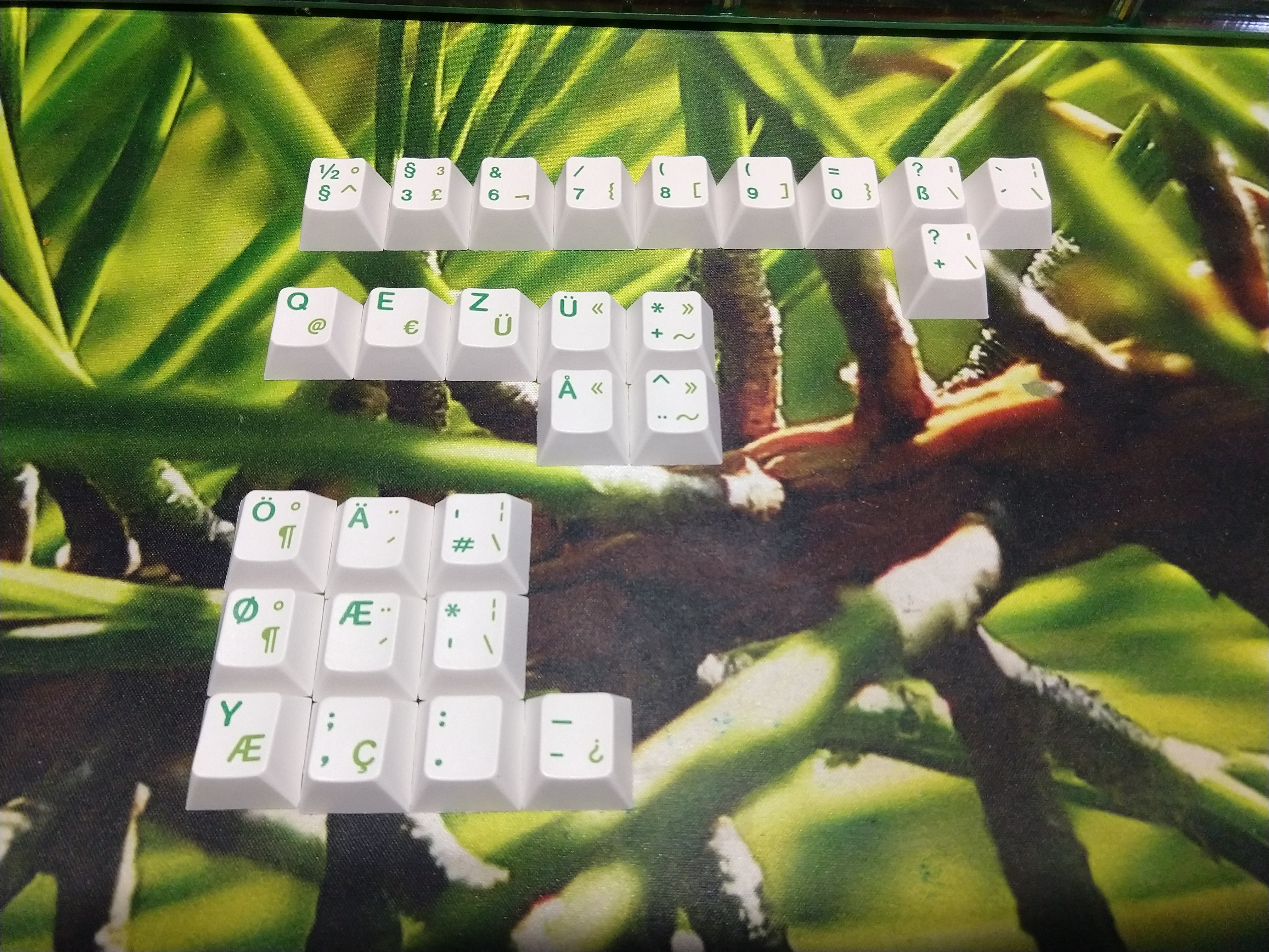

Good news: It looks good. Alignment seems quite good with many of the special characters being much improved.
Bad news: Long keys are pretty warped. In the very small amount of time I’ve had to check in on stuff I had seen some mention of recent ePBT stuff having more warping due to changing colors. When I get in touch I’ll try to see if there’s any info about working on that before the set is ready to run.

However, I still don’t have much confidence in ePBT creating good stabilized keys. I had a set of ePBT from 4 years ago that was great. But in the past few years, I have ordered 2 sets from KBDfans and both had the same issue. The larger keys were a bit warped, but the big issue was that they don’t work on cherry stabilizers (or zeal).
I thought it was just bad luck, but I’ve found the same thing on my more recent ePBT slate set too. And those larger keys look good. No warping at all. But because the plastic shrinks, you can see the keycaps are about 1.5mm shorter than their GMK equivalents. This is a big issue b/c it also effects the distance between the stabilizer inserts. Too close together means stabilizers bind.

Finally had the time to get the set onto a board. Consistency and alignment are much better across the board than the first batch. I’m pretty happy with the current look of the set.
I did put what long keys I could on stabs to see how bad the warping would affect them. The long spacebars seem fine, a couple of the 2u-2.75u seem a little sticky, I couldn’t test the 3u. I’ll talk with them and see if the warping was just this sample being rushed out and if for the GB QA for warping will be a bit more stringent.

Of note is I’m also currently in a situation concerning the “international kit”: ePBT’s MOQ is 200, so I’m almost sure an international kit wouldn’t hit that, but on the other hand it’s a lot of keys to tuck into the base kit. I’m not wanting to ditch it completely but I’m sure keeping “unnecessary keys” in the base is of concern for people. Something I have to think on.
