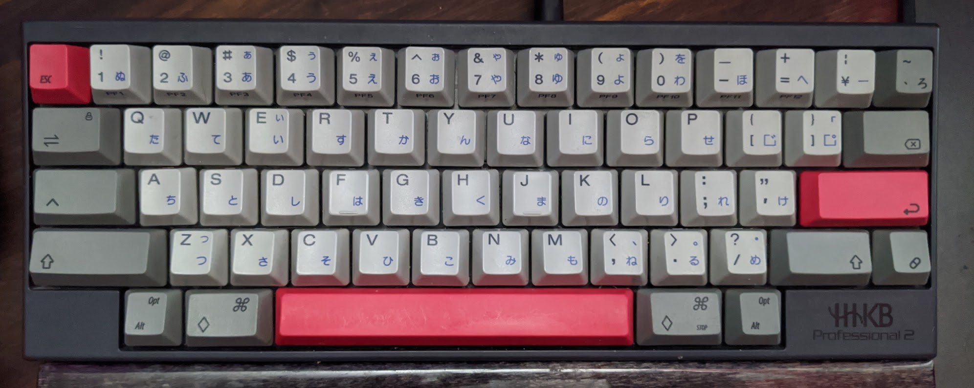

I was going to go the Hi-Pro route, but I have a US layout Hi Pro and couldn’t find a JP layout to fill the gaps. So, I left the Hi Pro on the Norbaforce, and used Sony News keys instead.
I’m sitting at two Norbauer cases, and this will likely be my third. Norbatouch is probably my favorite sounding and feel, but I’ve always preferred HHKB layout, so definitely getting stoked for this one. Hoping it’ll close the gap on the Norbatouch and let me use my favorite board.
