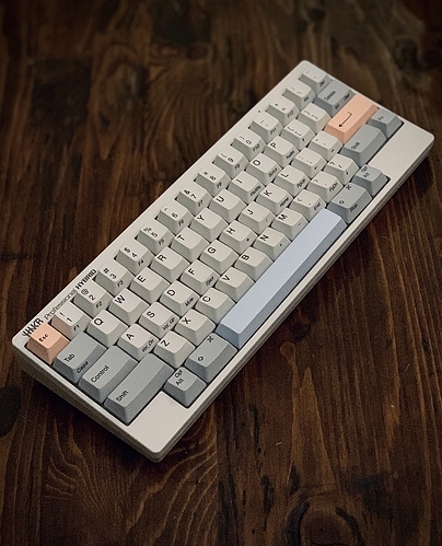

My body is ready: 55g Lubed/Silenced HHKB with Novatouched spacebar
