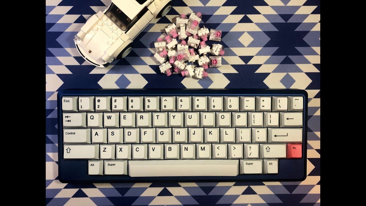

Are the Inks better than Zeal’s Pink Rosélios & Sakurios?
TL;DR: Generally, I’d put Inks and Zeals on the same level of quality - but for reasons I’ll explain, I’d still recommend the Inks over the Zeals for now unless you prefer Zeal’s colors enough to spend more.
Gateron manufactures Zeal’s switches anyway, so it’s not too surprising to see them cater to the enthusiast community with their own products.
I have a few sample Zeal switches, but haven’t gotten to use them in a full board yet. Comparing individual ones, though, the smoothness is so close I can hardly tell a difference.
However - I’ll note that the example Helio (just like Sakurios, but 1.5g heaveir) switch I’m using has a flaw in common with all the other silent Zeals and normal Gateron silent switches I’ve seen - the top dampener pad is too short, allowing the stem to sit too high in relation to the housing and leaf, in turn negatively affecting the travel and feel of the switch. The Inks, however, do not appear to have this issue. (I imagine that subsequent runs of Zeal switches will have fixed this as well but that’s just speculation on my part.)
Most people don’t seem to notice or be bothered by this issue, but I’ve confirmed it with a few others and personally it drives me nuts - so just be aware of that possibility with Gateron-made silent switches excluding the Inks. (Gateron Silents, Aliaz, Zealios, Helios, Sakurios, Roselios)
One other note about the Helio that I have; the play is very minor, but there is a tiny bit of wiggle between the top and bottom housings. This can be fixed with switch films - but that’s more cost on top of the already expensive switches. The Inks that I have fit snugly together and don’t need films.
Even if they were identical, I’d go for the Inks because they’re at least ~20% cheaper. That said, we’re essentially talking about picking between two of the best possible options, so I don’t think you can go wrong here.
