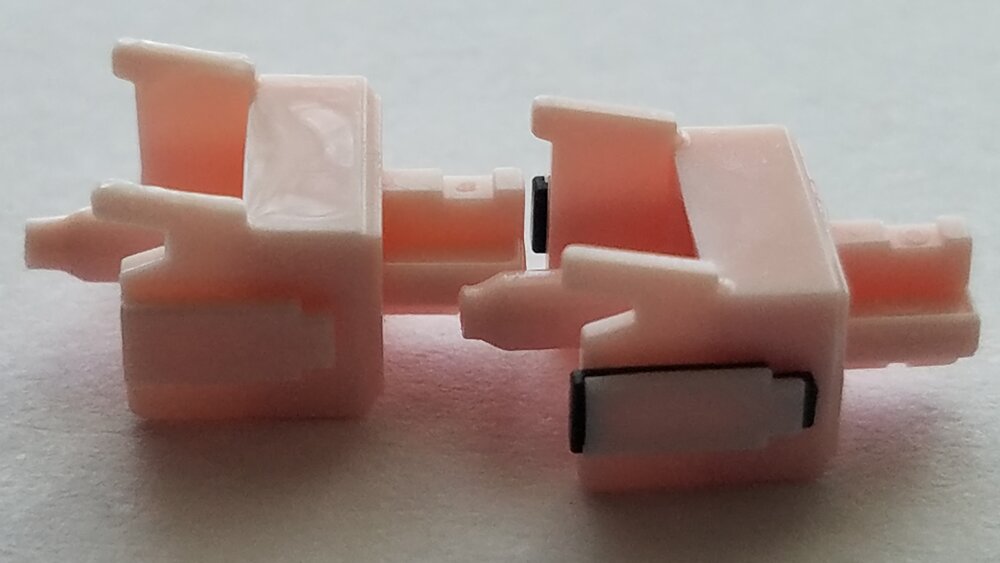

Old post, but was wondering what the collective thinking is with silent linears that use gasket style dampers fitted on the stem sliders versus those that have them integrated instead. Is one design “better” than the other?
Think it was @Deadeye 's serikos that the gasget could slip of if lubed on it.
My bad, it was @pixelpusher
I personally don’t like the reduced travel and the fact that they come off fairly easily.
They’re decent silent switches, but I don’t think it would take much work to come up with a vastly superior implementation. It’s probably hard to r&d something that has to appease such a wide audience and then put it through millions of press tests. But even on paper, the design seems weak.
