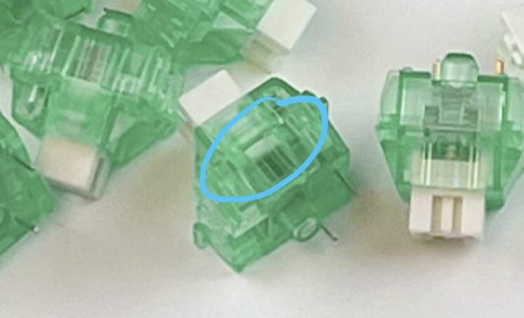

Might be the first time I’ve seen the leaf called “shrapnel” ha
That looks like a leaf-spring / pliant leg to me, but it is kinda hard to say for sure.
