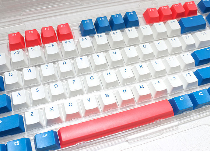

HK Gaming dyesub PBT $40-50 139 keys highly questionable ethics but available on Amazon and often recommended by people who don’t care
