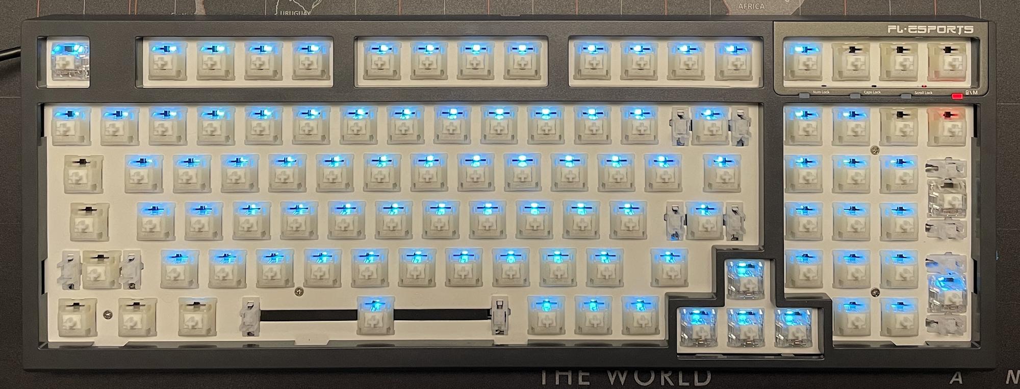

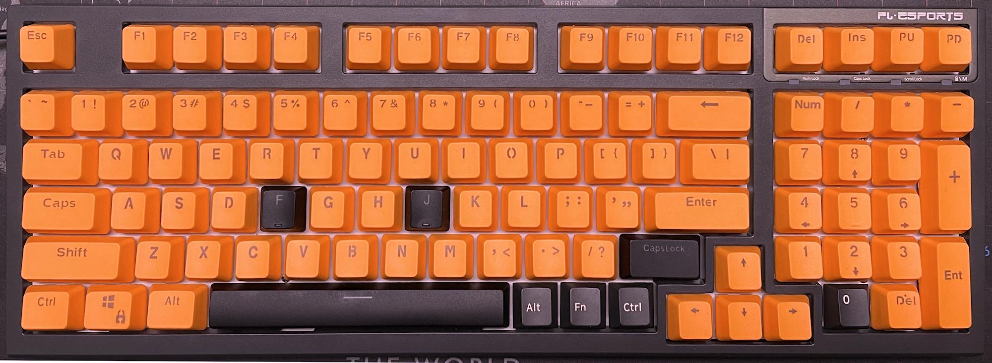

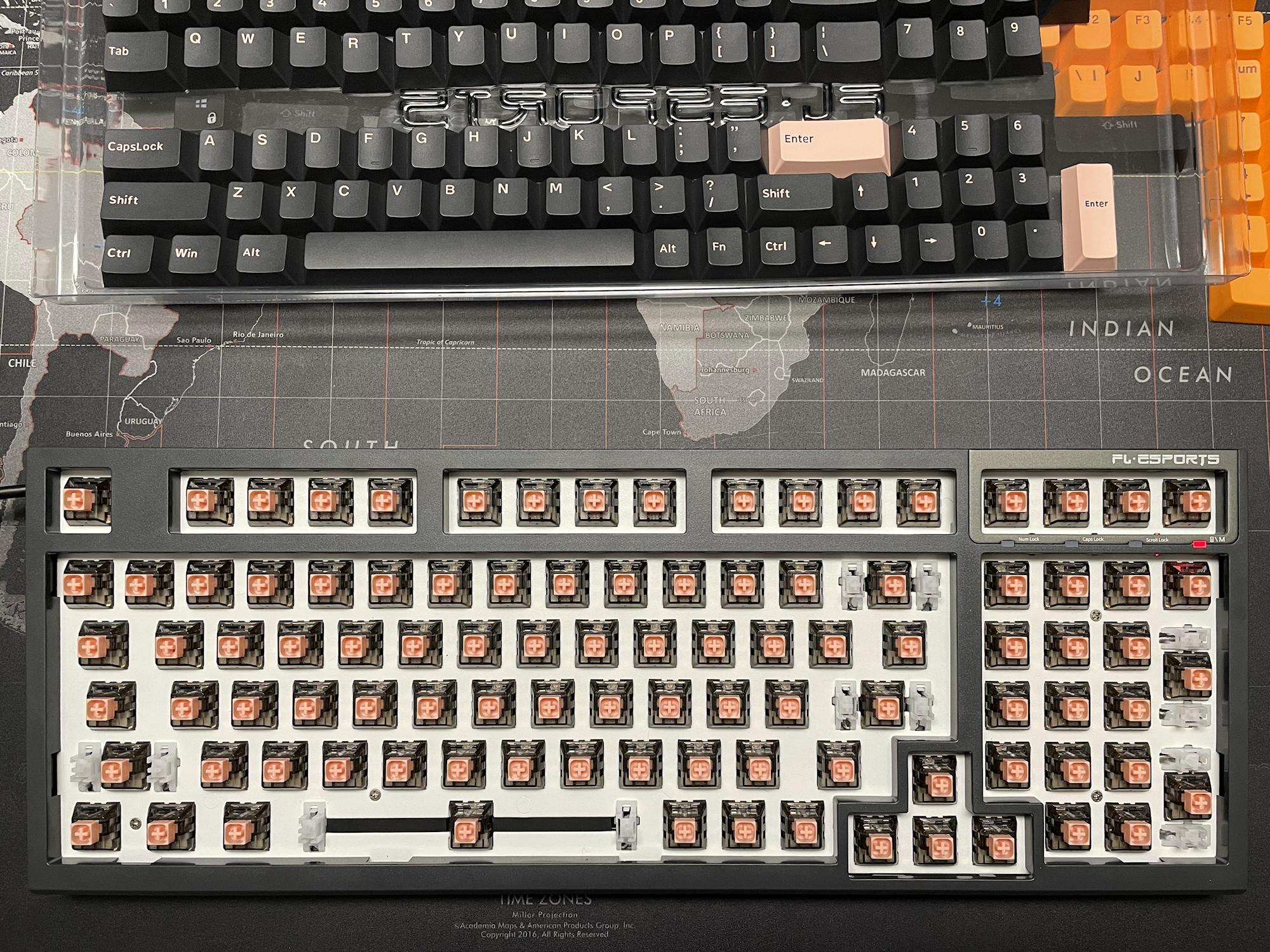

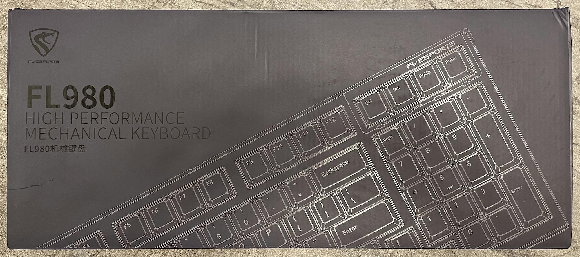

Thanks to the recommendation of @milneraj I got the FL980 from FL Esports. Also based on a lot of reading/research, I ordered Boba U4 Silent tactile switches. I am now on the hunt for (a complete set of orange pbt backlit) keycaps. I installed a set I got from Amazon but you’ll see the set doesn’t have full coverage. The mismatched keys/colors drives me crazy. The contours are off, I still need to figure out PrintScreen (although there is a key combo built in) and the space bar is sticking but it’s a start. So here it is:
There you have it; my work in progress, compact, wireless, led, hot-swappable keyboard. What have I gotten into?! I must say, I thoroughly enjoy the Boba U4 silent tactile switches. If I ever get the keycaps all sorted out, I’ll post final pics. Thanks again to @milneraj for pointing me to the FL980 three-mode. Have to start somewhere, right?
Wow this is fantastic! Glad that you managed to pick up the FL980 - I’m tempted to pick one up myself! I just got some “Unholy U4s” (U4 stems in Halo housings) and am also thinking of a board to put them in :slight_smile:
In terms of the keycaps, the stock ones are in Cherry profile while the orange set you got is in OEM profile, hence the differences in contours. One way to remedy this will be getting a single color shine-through keycap set with compatible modifiers, and use those for a two-tone colorway. Something like the Tai-Hao set I’ve linked below. If you’re not keen on the PBT Oliva Dark keycaps you got there, you might be able to find some luck selling them on the aftermarket (r/mm, ebay, your local discord etc).

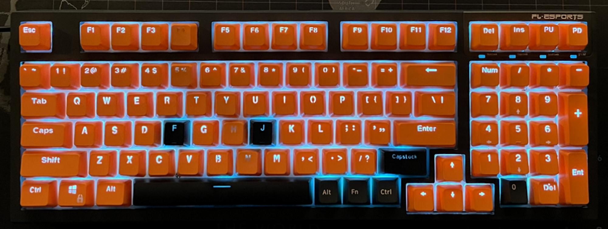

I posted a “final” pic in the “What’s on your desk today” thread. A couple of the keycaps aren’t in the right spot–but it all matches.
The programming software was only for the two mode so muscle memory it is for the keystroke binding for PrintScreen. I think I only hit “Delete” instead of Fn+I a couple times today. :slight_smile:
Awesome build! I saw your pick on the thread :slight_smile: I especially like the “><” key as your numpad 0, that was a creative touch! Really happy to hear that you managed to pick up and customize a keyboard to your liking - that’s the best part! Would definitely love to have you around the threads, reading and sharing anything that appeals to you
