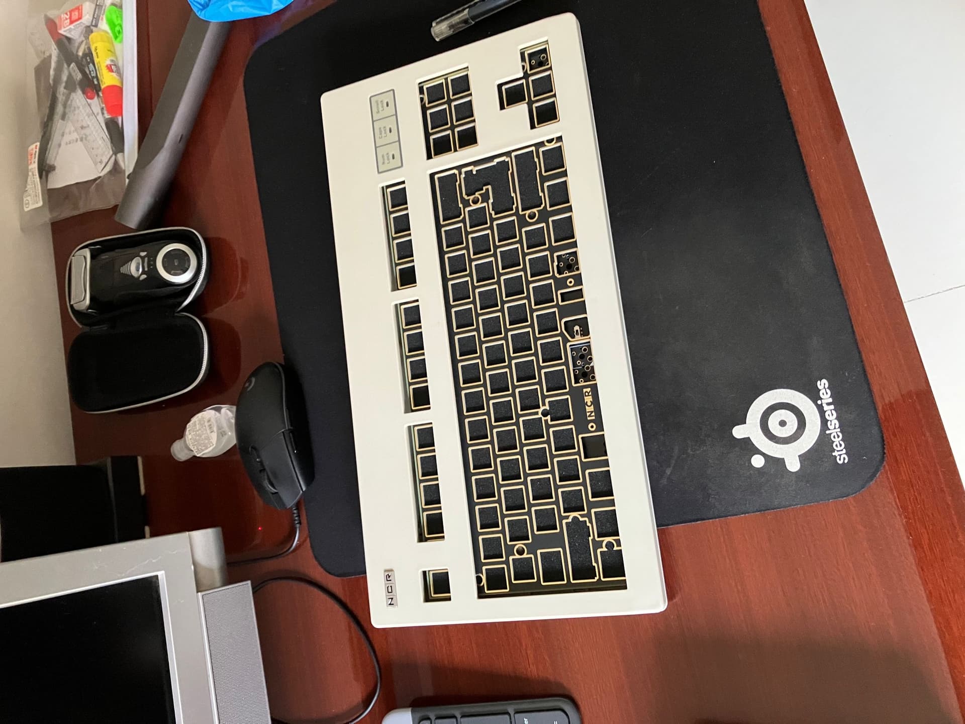

The carbon fiber plate is nice, but I think I am going to go plateless. I might have to buy some more pourable silicone and put that in the bottom. The ridges in the plastic are perfect for containing the silicone while it cures.
It looks like in theory you could probably do pourable silicone in the top too, but I am think gravity would probably cause it to fall out over time.

I donāt have a hotswap version to be able to test that well. However the carbon fiber plate seems to be of nice quality. In hand it seems sturdy, which is kind of the reason I donāt think I want to use it. Seems rather rigid.
My memory of what carbon fiber plates are supposed to feel like is a little rusty, but I thought that people like them for the sound, but that they are quite firm.
I think some of what you and others have posted about the classic Cherry boards being plateless and my love a soft bottom out leads to think that is what I would prefer.
