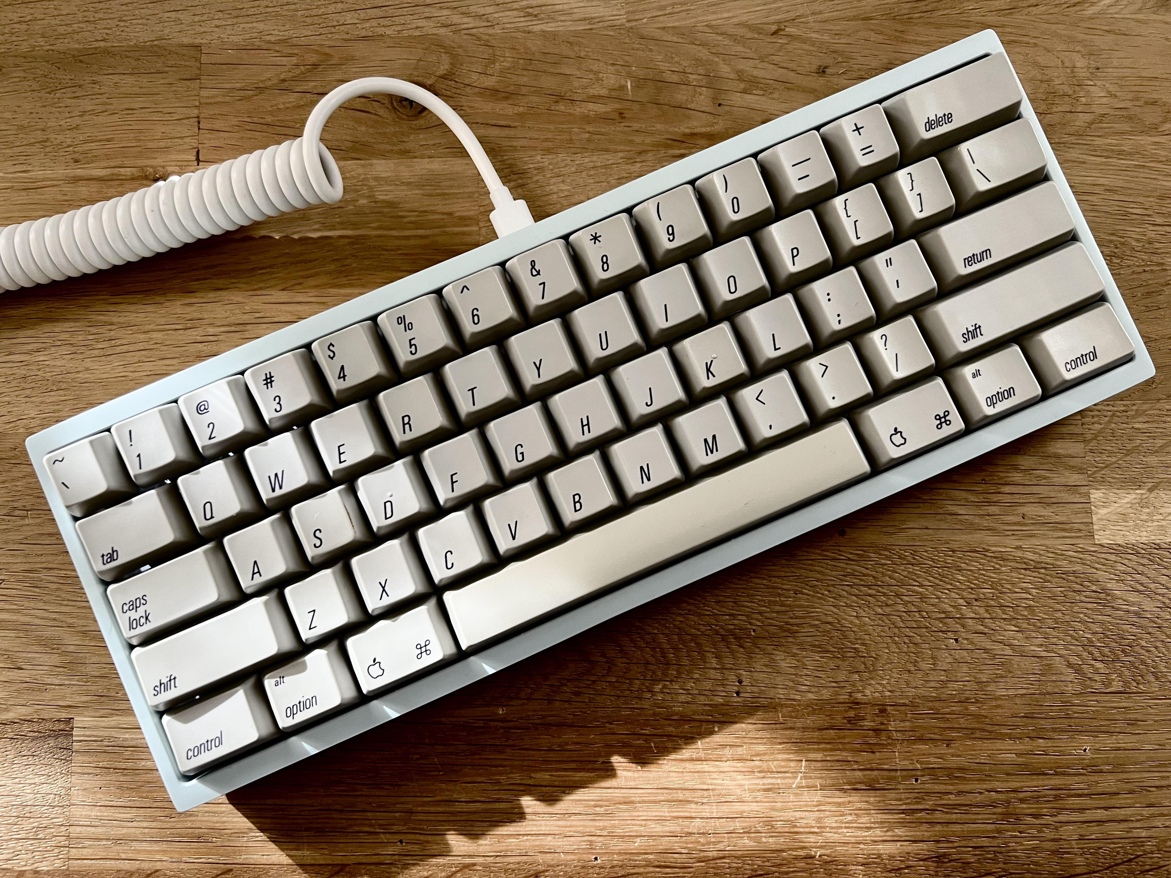

- Sky Blue Bakeneko60 from Cannon Keys
- Steezy60 Alps PCB from Keebmeup
- Salmon Alps
- Vintage AEK keycaps
- Lots of jank mods to make the o-ring work properly
I call it BakenAEKo
I call it BakenAEKo
That’s really nice looking. What do you think about salmon alps?
I am slowly coming to the conclusion that I like click alps the best. Tactile alps aren’t that much quieter, even when clean. This was a good batch of Salmon Alps and I am not in love with them. They are a good tactile, but Alps always has me expecting more (perhaps due to the hype). I should have used my Blue or Amber Alps for this build.
I know what you mean. I felt that way with my salmons and blues. I actually prefer pine whites over them. Probably a spring weight thing. Anyway, looks great
Did you have to come up with a solution for removing the board? I am trying to make a Fakeneko as well and since I’m not using the standard plate and PCB I need to figure out how to remove the board.
I use the Allen wrench that came with the bakeneko. I hook it under the plate where the cut out are for the side screws.

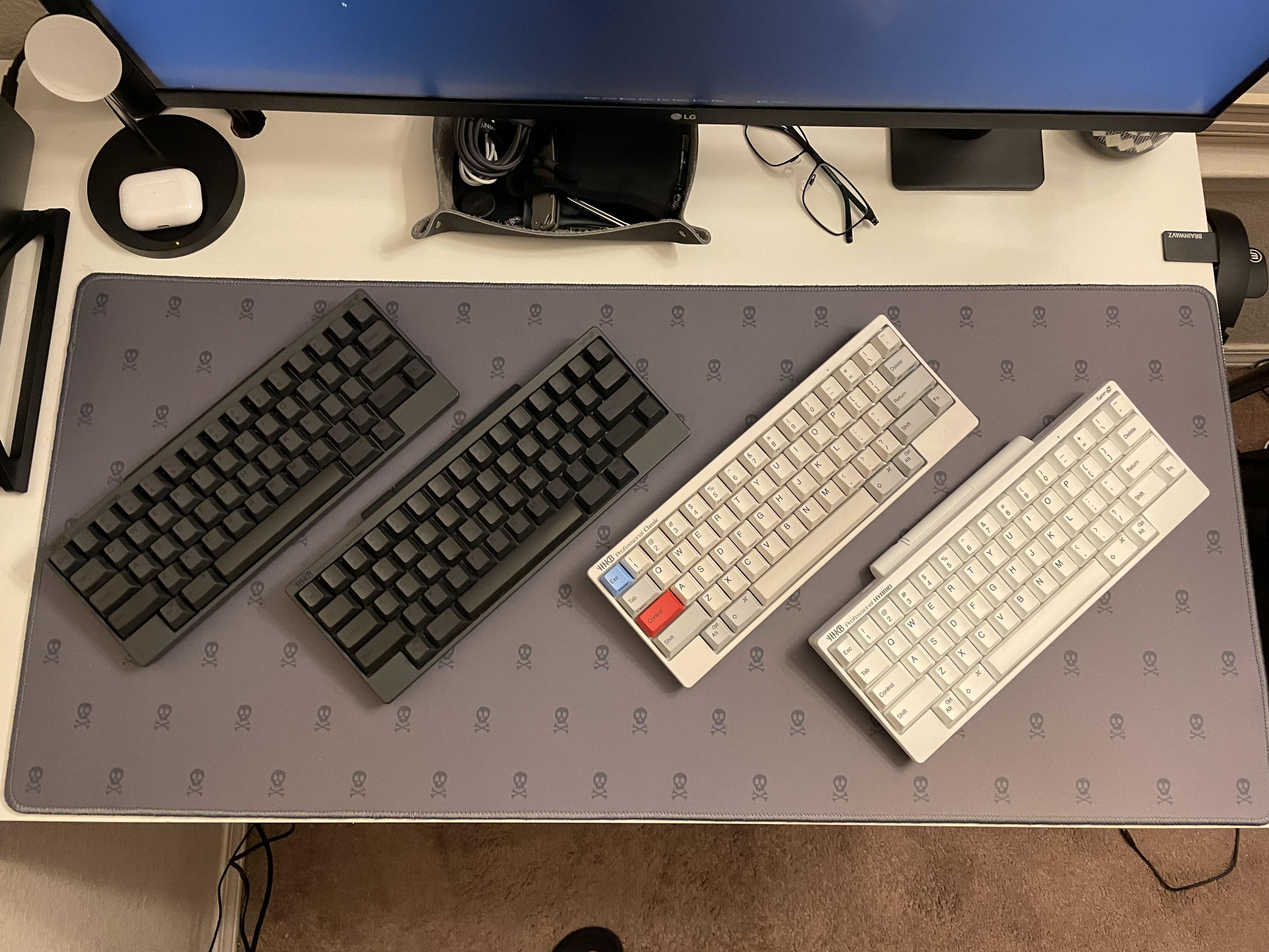

Small little collection update today on the rare occurrence where all of them are in one place. Hopefully a couple of these will get norbauer housings soon Excuse my crappy photography.

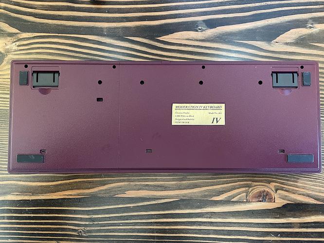

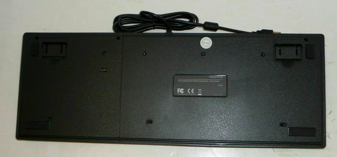

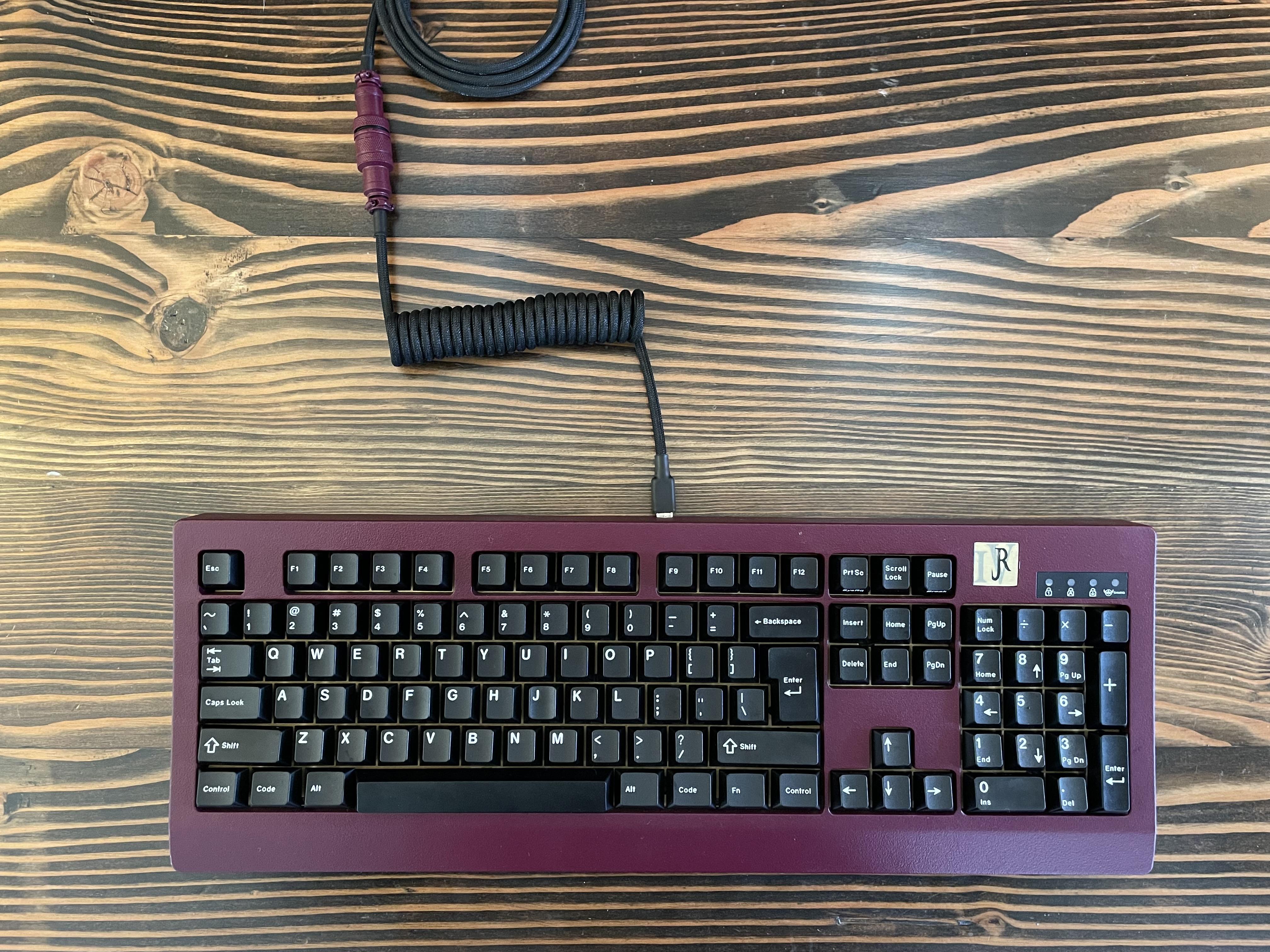

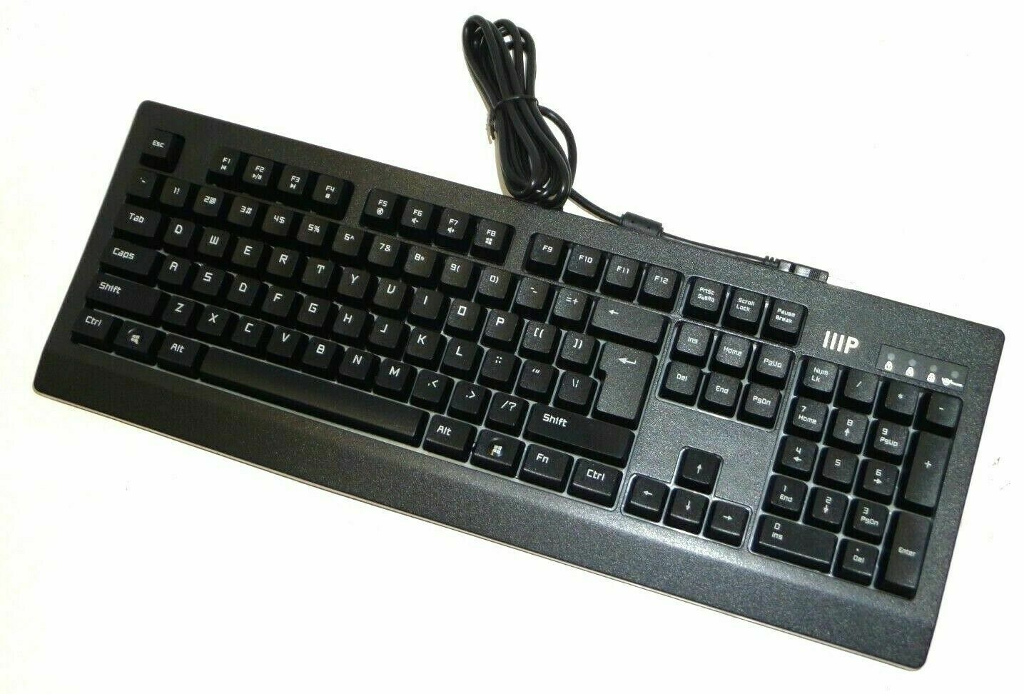

My best friend asked me to make him a custom but gave me a bugdget of only $150
So I bought the Monoprice keyboard, a cheap, not that great keyboard and turned it into this gem:
Before
After

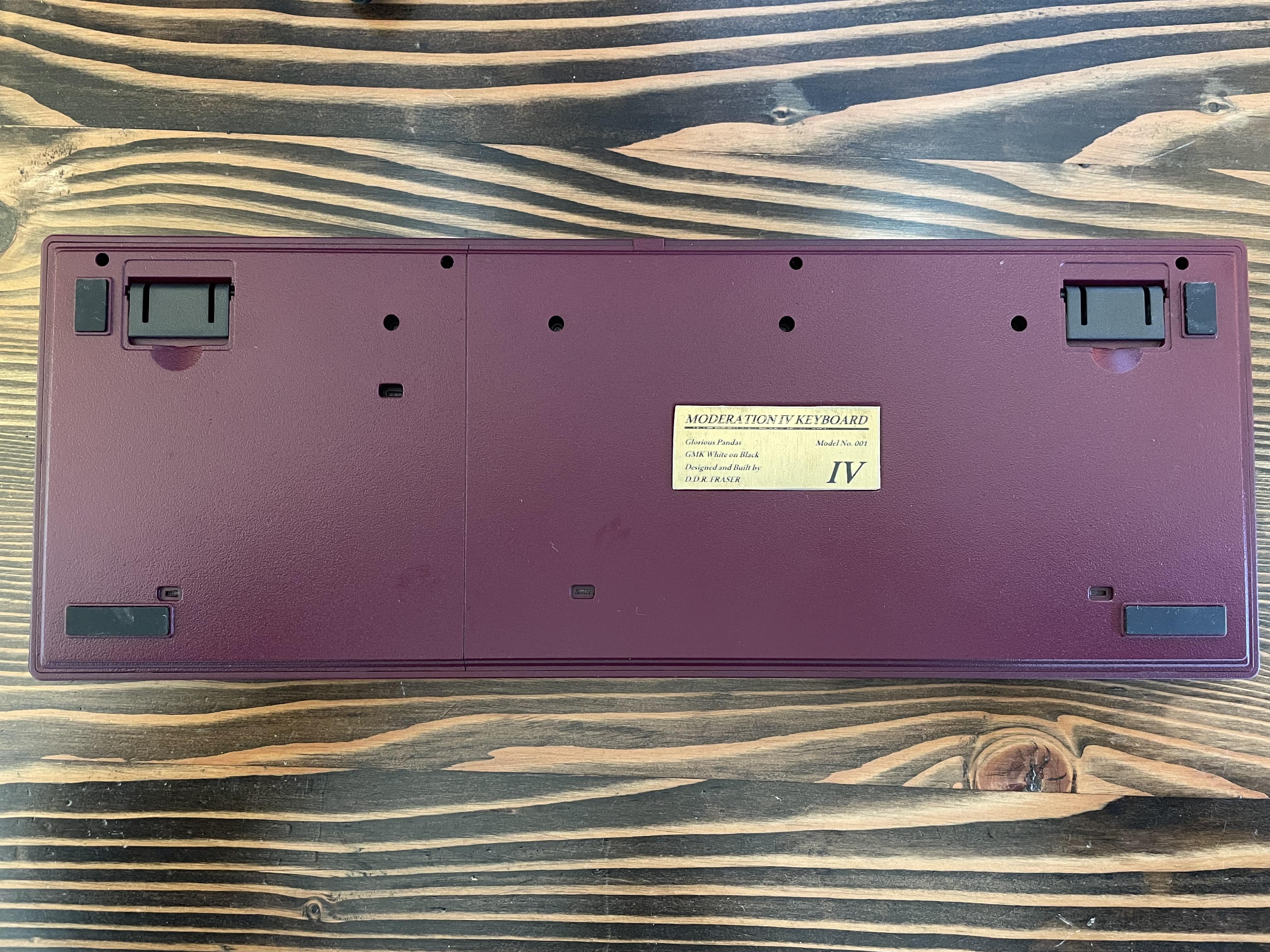

Back
Love the custom badges!
So good!
Awesome build, I hope your buddy loves it! To me this is the peak of the hobby. Sure it’s a great feeling getting a true custom & building it, but for me projects like these feel far more satisfying!

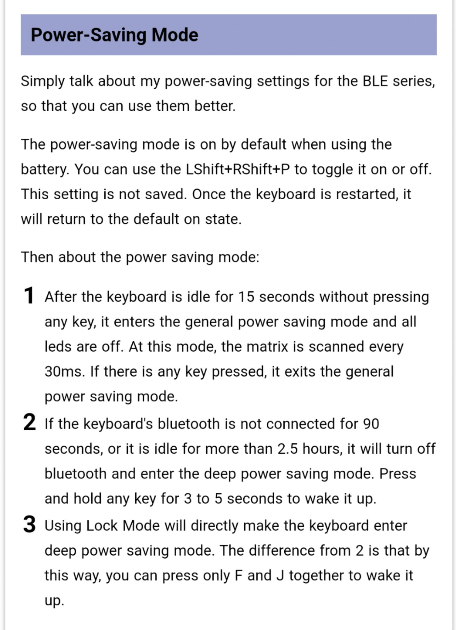

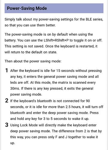

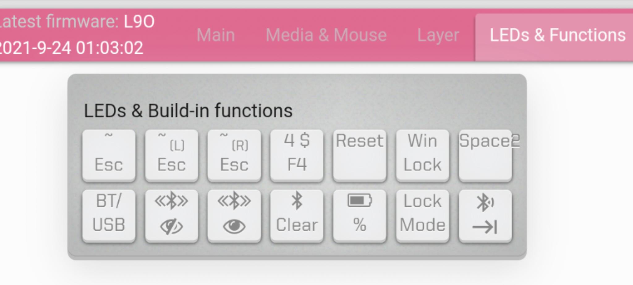

The only things about this keeb I would change if I could:
I’d add a physical power switch for the bluetooth module;
it has a “bag mode” but I’ve had a little trouble figuring out exactly how to work with it. I’m now in the habit of turning bluetooth off on my phone when placing this keeb in the bag after getting locked-out of the device for half an hour; the keyboard had been butt-dialing the password screen enough for that to happen.
I would add a slight bevel to the seams between the top and bottom half to help them feel more resolved and intentional.

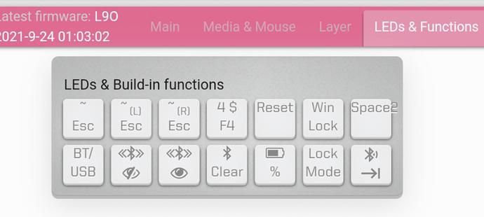

So, you’re @Deadeye which makes me pretty confident you’ve already tried these things, but I felt like I should kick it your way just in case. Yang has some decent documentation for ydkb.io here.
From that, on the BLE page, I found this information regarding power saving. Seems like using the. “lock mode” button will put it into a deep sleep and disable the BLE. You have to hit F and J together to bring it out of this mode.
And fwiw, the lock mode button I believe he’s referencing.
Still, no substitute for a physical switch.
Aha. I think that’s what I was missing. I was confusing the Lock Mode function with power-saving mode; I thought I was telling my keeb to go to “deep sleep” but what I was actually doing was telling it “don’t bother saving power” - derp. Thank you!
Speaking of those badges, what were they made of and how were they printed?
They are brass plates that I cut out with a Dremel. I designed the logos/text and then printed them out on transparent sticker paper and laid on top. Then sprayed some clearcoat on top for durability. I cut a 1x1 hole in the top so the square badge would be inset.
Wow, great result !

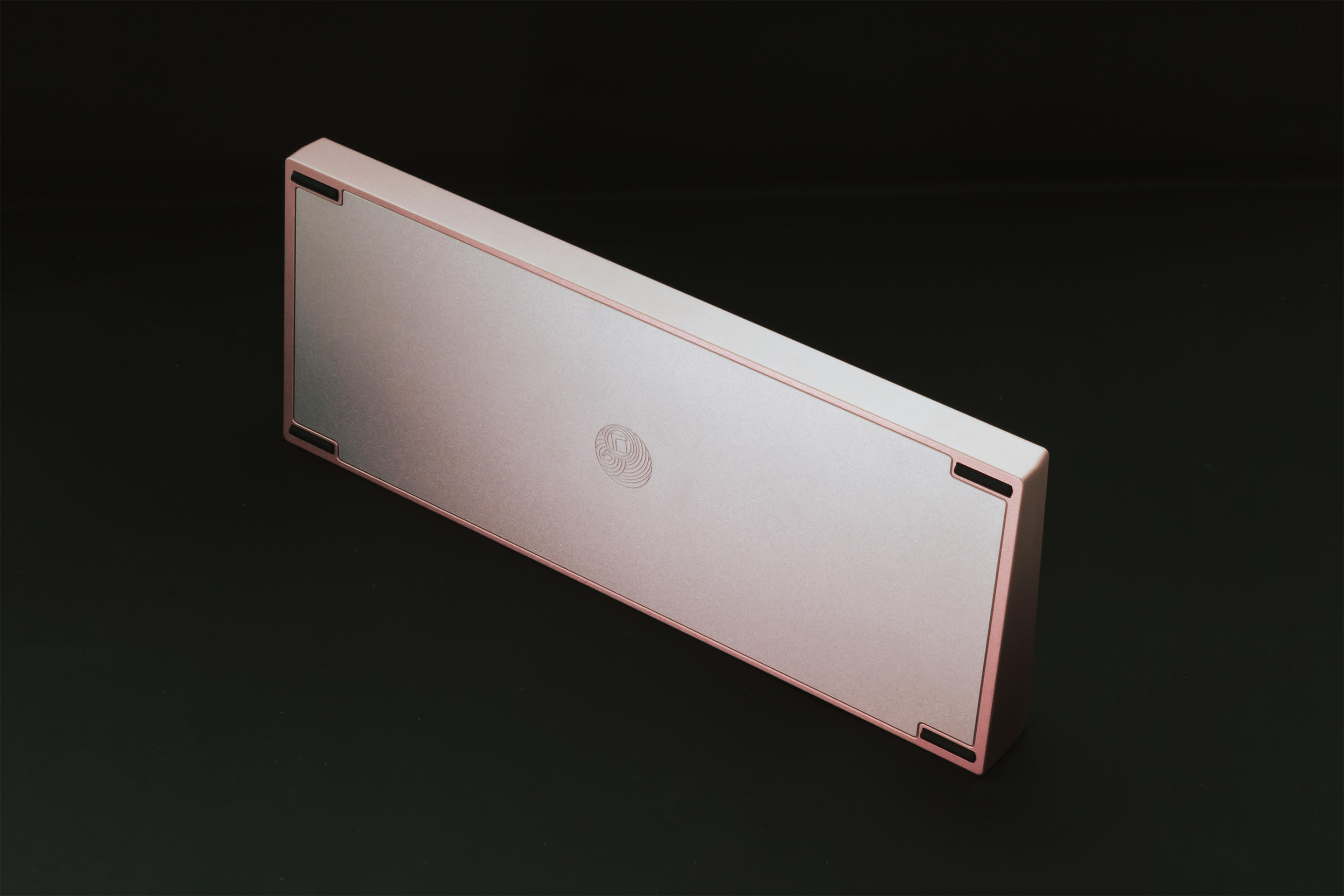

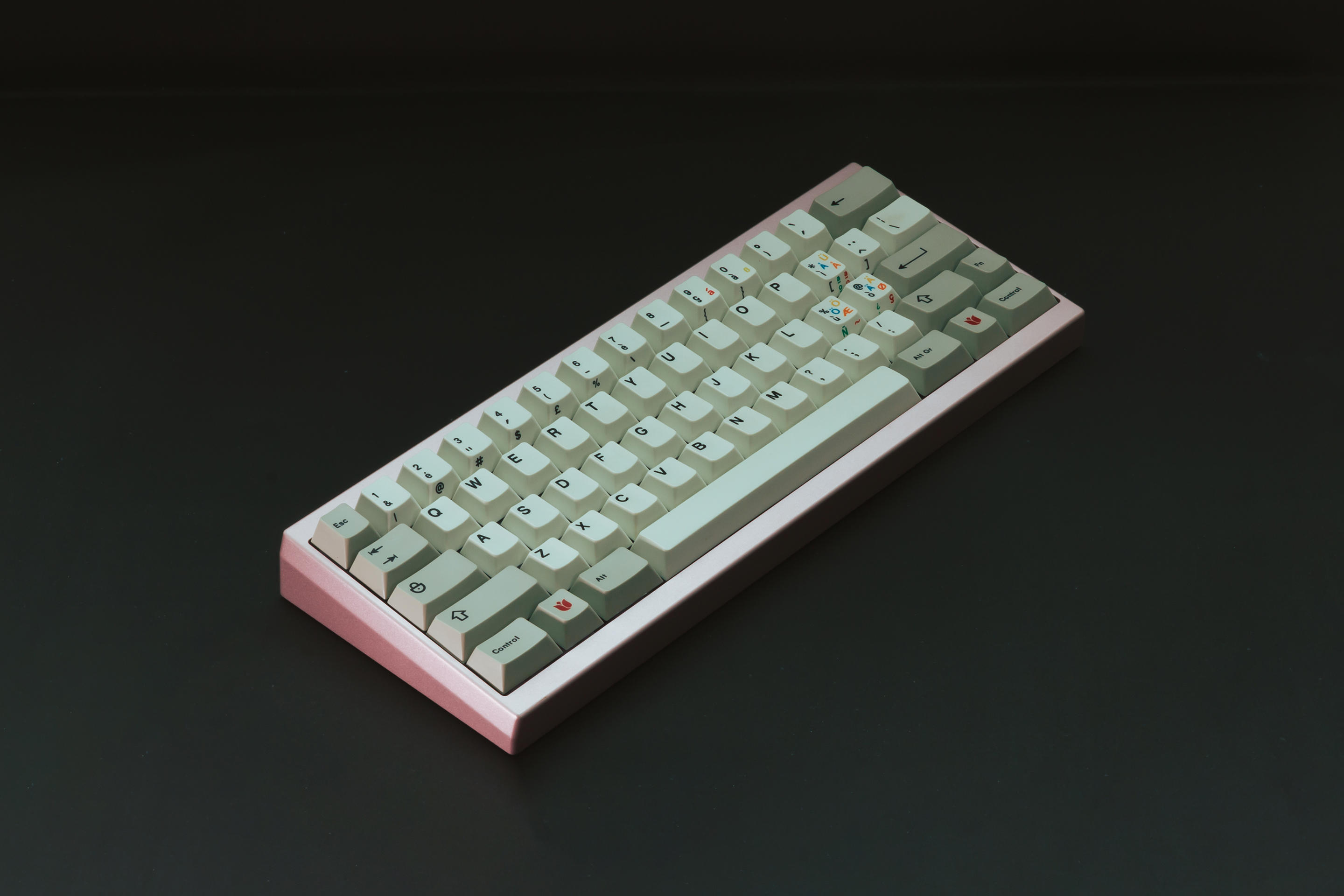

Wanted a deep, muted board without going the silent switch route for work.
Incredible photos, geez. This is just so very classy, yet still fun. Tulip on pink is a win. Do you have a sound test?
Thanks! Ill have a sound test up over the weekend. Thing is pretty muted, tbh, dont know if i sound test would do it justice.
