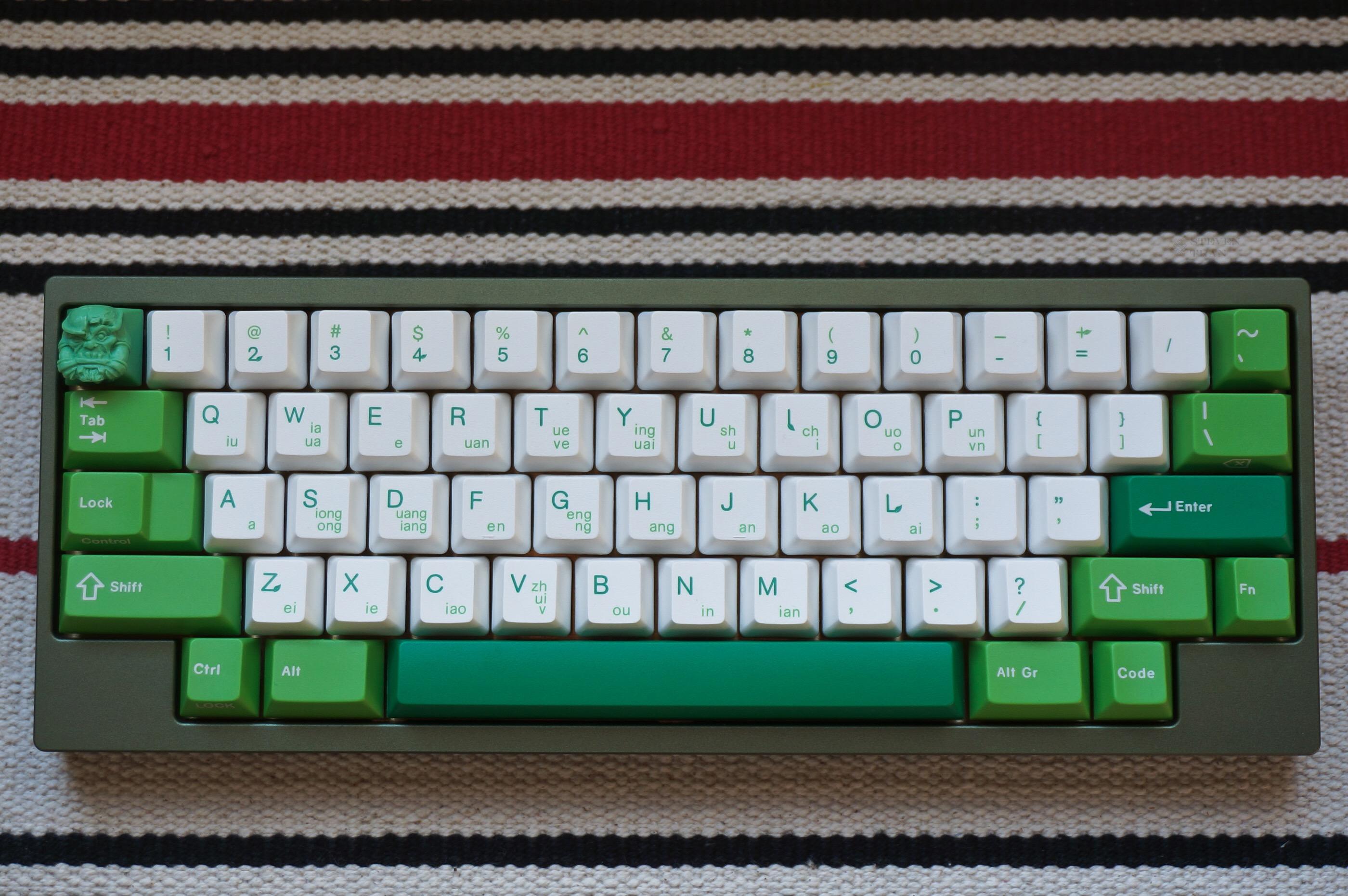

New set of ePBT keys came in missing the right shift so I guess this is what finally forces me to switch to a 7u bottom row going forward. Just waiting on stabs.

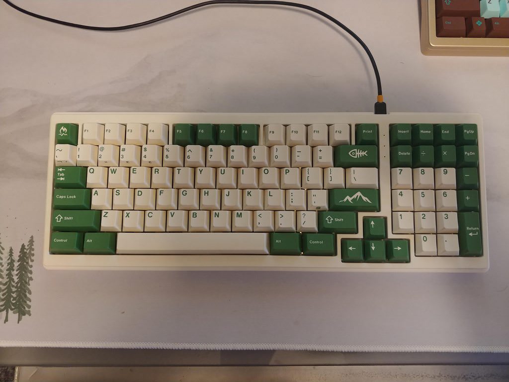

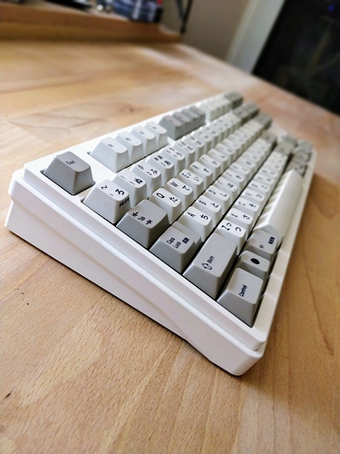

White TX-CP
Stainless Steel Plate
Zealios with 78g Progressive Springs
Lubed 3204 and Switch Filmed
The Zealios with the progressive springs feel really weird, its real easy to push through the bump, which seems to be moved even farther down, with actuation at the end of the bump. Then it’s just a short but cushioned travel to bottom out. Kinda makes travel feel shorter despite it still being 4mm.
They also seem to make a slight “whispy” sound around the time if actuation, which is more noticeable if the key is towards the periphery of the board (edit: maybe this is normal and it’s just more noticeable on this board depending on location)

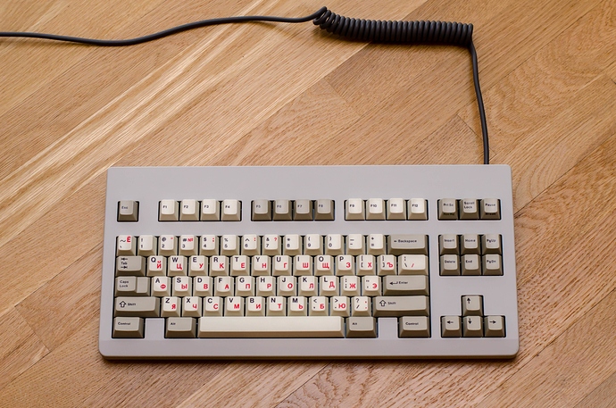

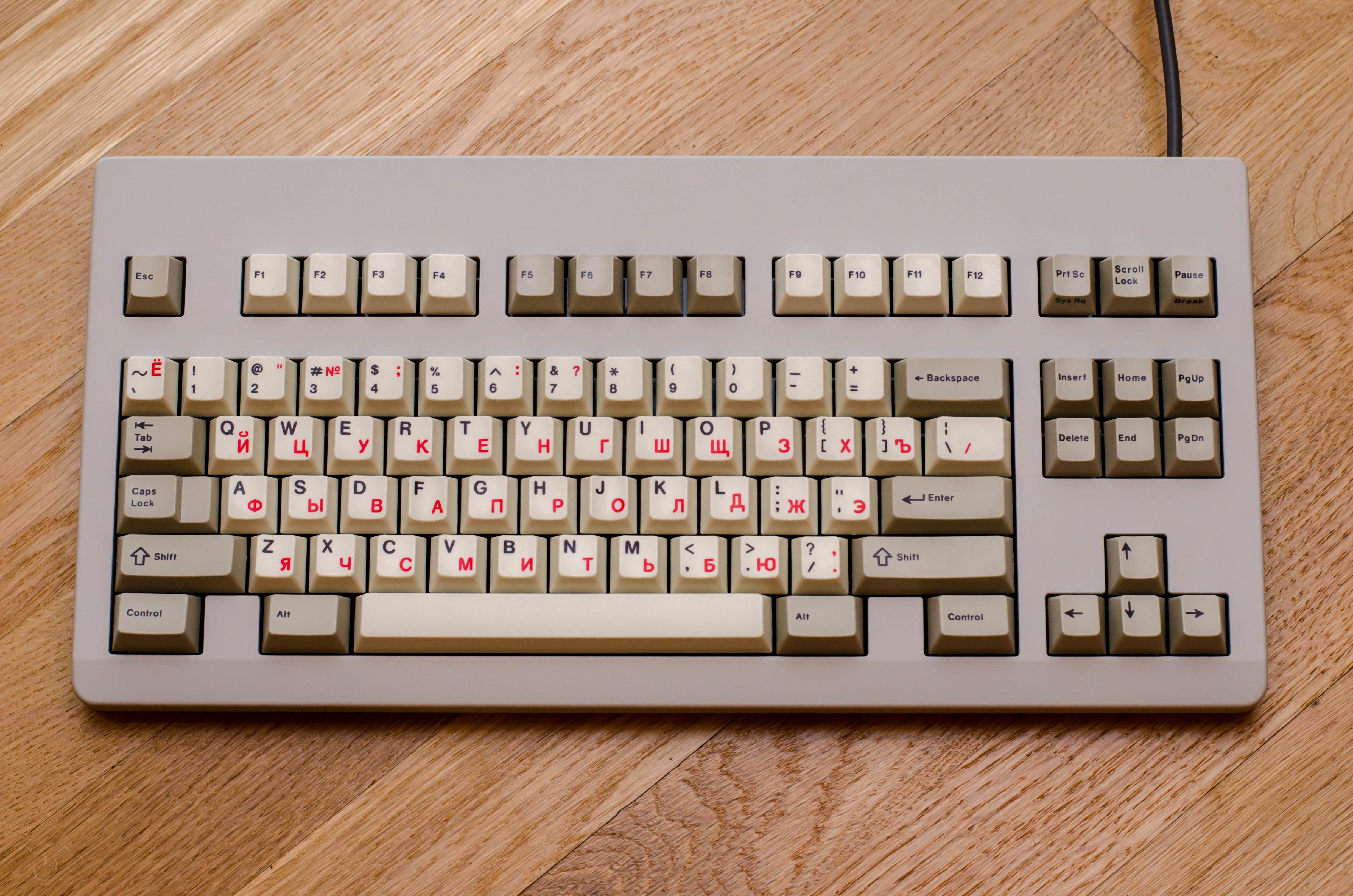

Oh my god that is absolutely beautiful! What switches do you have inside?
JTK WoB on CM Novatouch. My Norbauer case is with a friend for a matte wrinkle black powder coat. I’ll be sure to show it when it returns to me.
Thank you sir! It has vintage blacks.

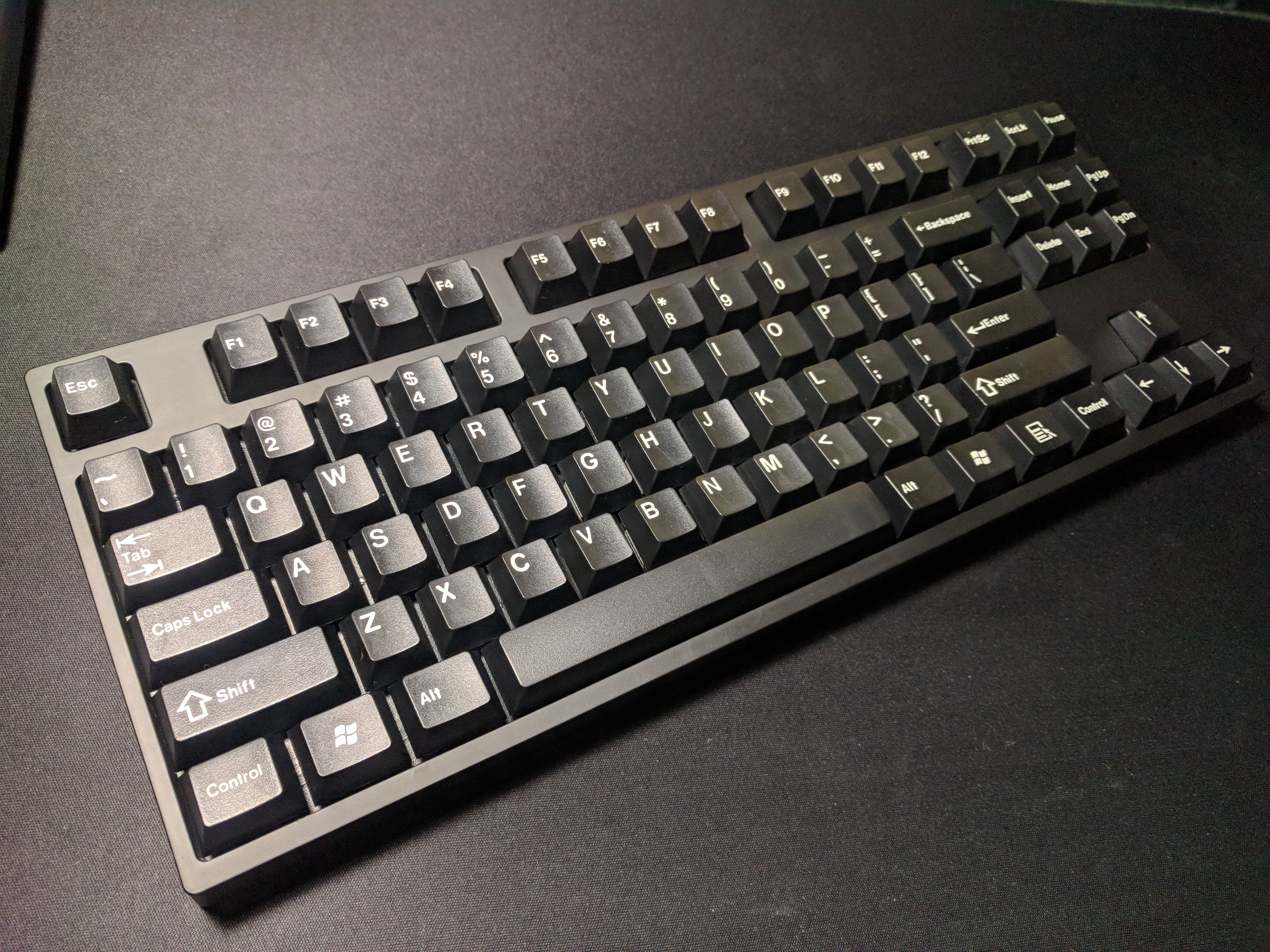

Guys! I my friend dropped this off to me this afternoon!
It’s a custom wrinkle black @norbauer Novatouch case! The wrinkle is incredibly consistent and it just feels so tough and refined. If any of you remember, this case was a Glossy Candy Purple just a few months ago, but having access to a friend with a powder coating shop let’s me try out new finishes and gives him something to practice on ![]()
Anyway, the specs are:
CM Novatouch, stock 45g Domes, KBDfans Silence-X rings, and JTK WoB
Do you know what kind of powder was used for this? Like what brand?
I’m not actually sure what brand was used but if you look up Wrinkle Black Powder Coat it’s actually a pretty common finish for automotive parts. His brother runs a fabricating shop next door to his powder coating shop for track cars and this is kind of a standard finish since it tends to wear better than something glossy.

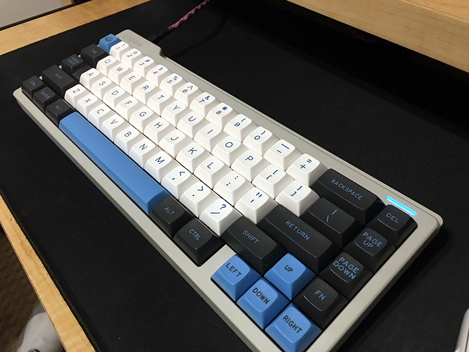

all put together but not yet soldered. thats the plan for tomorrow.
lubed retooled mx blacks
DZ60
steel plate
tofu acrylic case
ePBT keycaps
first time lubing mx style switches and stabs. really sounds nice, but i feel that using dielectric grease for lube on the sliders for the stabs was a mistake. makes the key feel mushy ![]()
actually i think that the mushiness is because my left shift stabs are backwards. nevermind.
