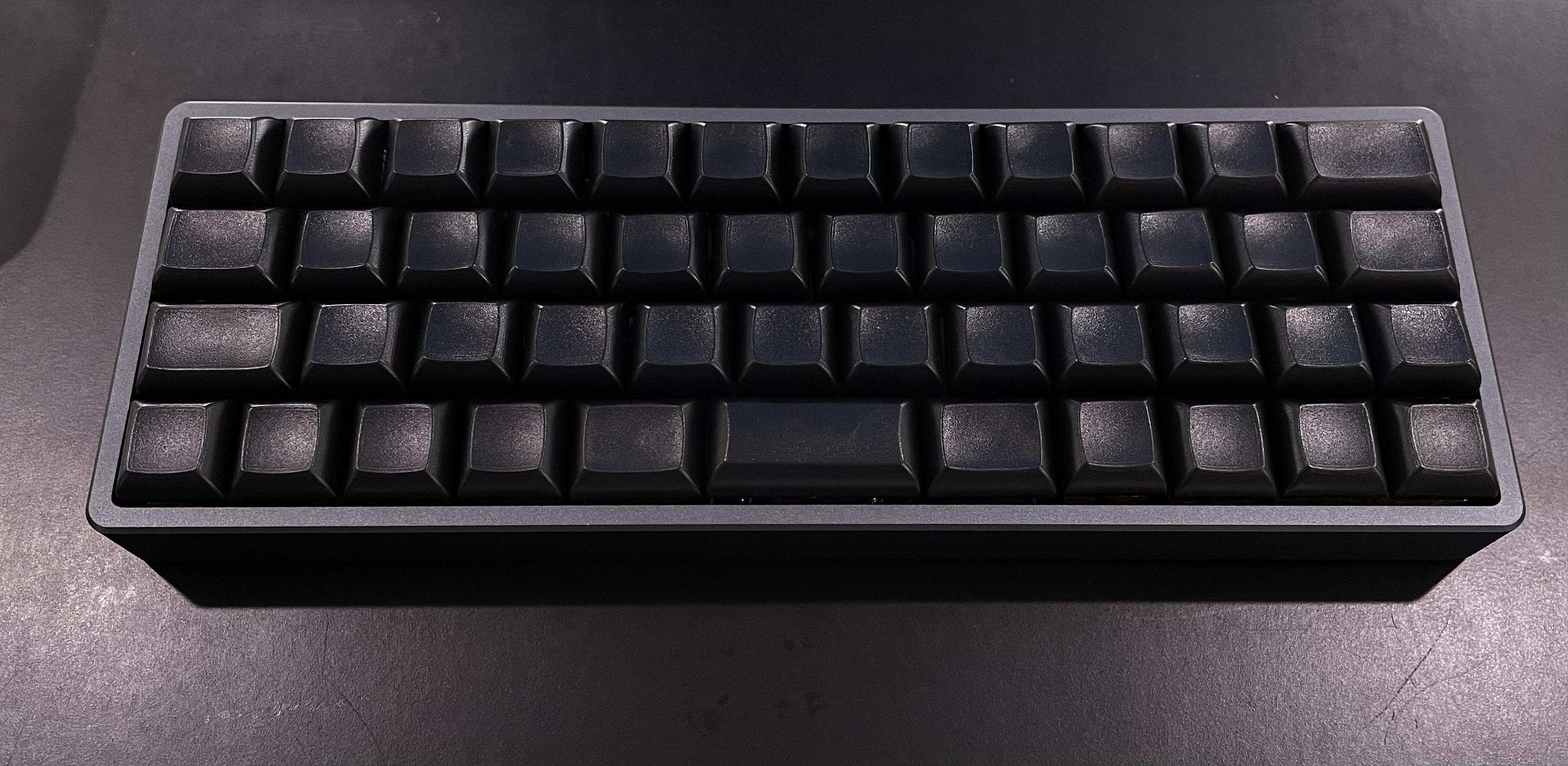

Acrylic frosted clear with PETG plate. I want to challenge myself to use less keys :sweat_smile:

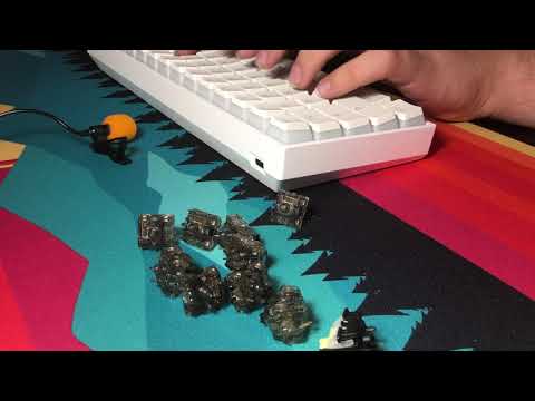

Aluminum UT47.2, case foam, o-ring mount, FR4 plate, Lemon Lush frankenswitch 205g0, HuB caps. Vocaroo | Online voice recorder
I just love how quiet and yet tactile these frankenswitches are.

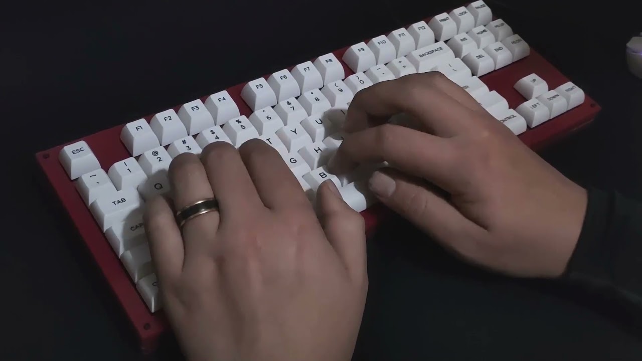

Cajal E-white, FR4 plate, Tactile frankenswitches (Boba U4 housings 205g0, UHMWPE AEBoards tactile stems, 57g TX springs 16mm), GMK caps.
I enjoy these tactiles more than the few U4T switches I tried. My interpretation is that they are smoother with less tactility, which is right up my alley.
