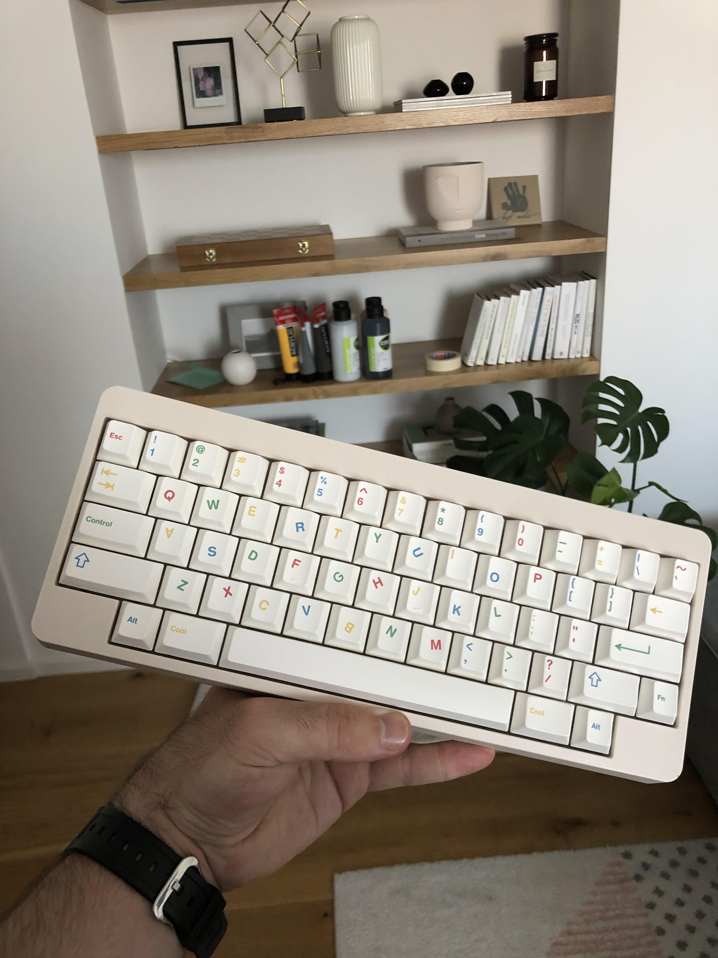

I HAVE FINALLY RECEIVED IT TODAY! WOOHOO first Rama board to land on my doorstep!
So far I am liking the typing feel and it looks way cuter in real life

I also thought it was hard to get a nice pic of it, but I say that a lot considering my camera is of the phone variety
yeah agree, it’s super hard to capture the Azur colour with my camera phone and even trying to edit it takes quite sometime and yet still can’t fully get it right
