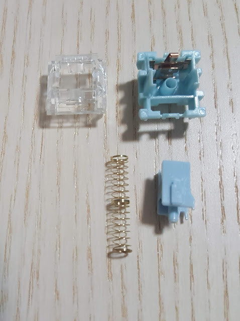

I’ve spent some time using the stock switches. Can confirm it’s like a half-silent switch because the bottom out is muted. I opened the and checked the stems, but there are no dampeners. I’m very keen to find out how the switch is muted on bottom out. It can’t just be the long spring?

a small silicone plug at the bottom of the center tube of the bottom housing - but I do wonder if it’s just the spring. Can you see anything down there?
I can’t confirm for sure, but in terms of surface the of the bottom of the tube is different than the floor of the housing. I also tried poking and it feels softer. That might be it!

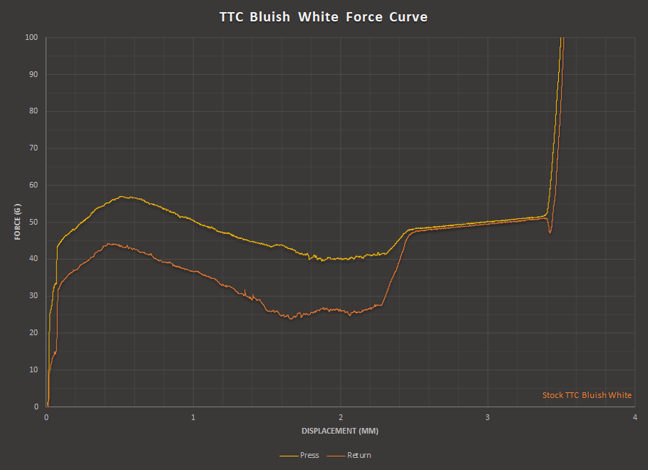

There is evidence of some dampening in their force curve, it doesn’t just shoot straight up, there is some slope there that is similar to other dampened switches.
EDIT: Poked around on the switch, there is some kind of dampening pad in the stem hole.

So hey - if I sent you some frankenswitches (and $ for your time), could you do force-curves for them?
ditto honestly, would be really interesting to see how different contact leaves actually impact force curves.
