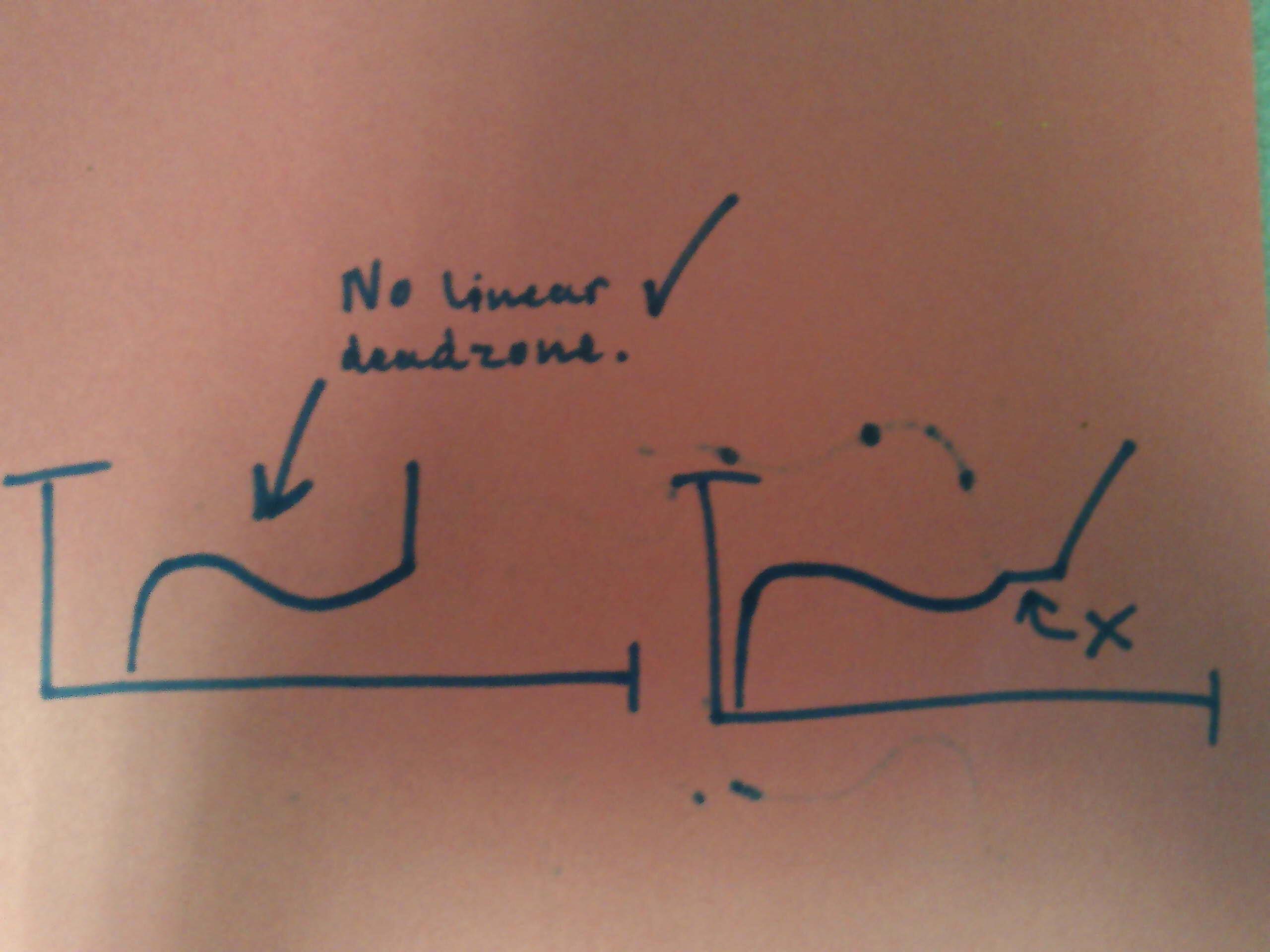

Very specific tactile:
I like tactiles, but never could find a specific kind I like.
Is there any tactile (with a heavy bump) with no linear near the bottom out? I want the–flicking the light switch–feeling with no linear.
I know this is specific, but I want to see if there’s anything like this.

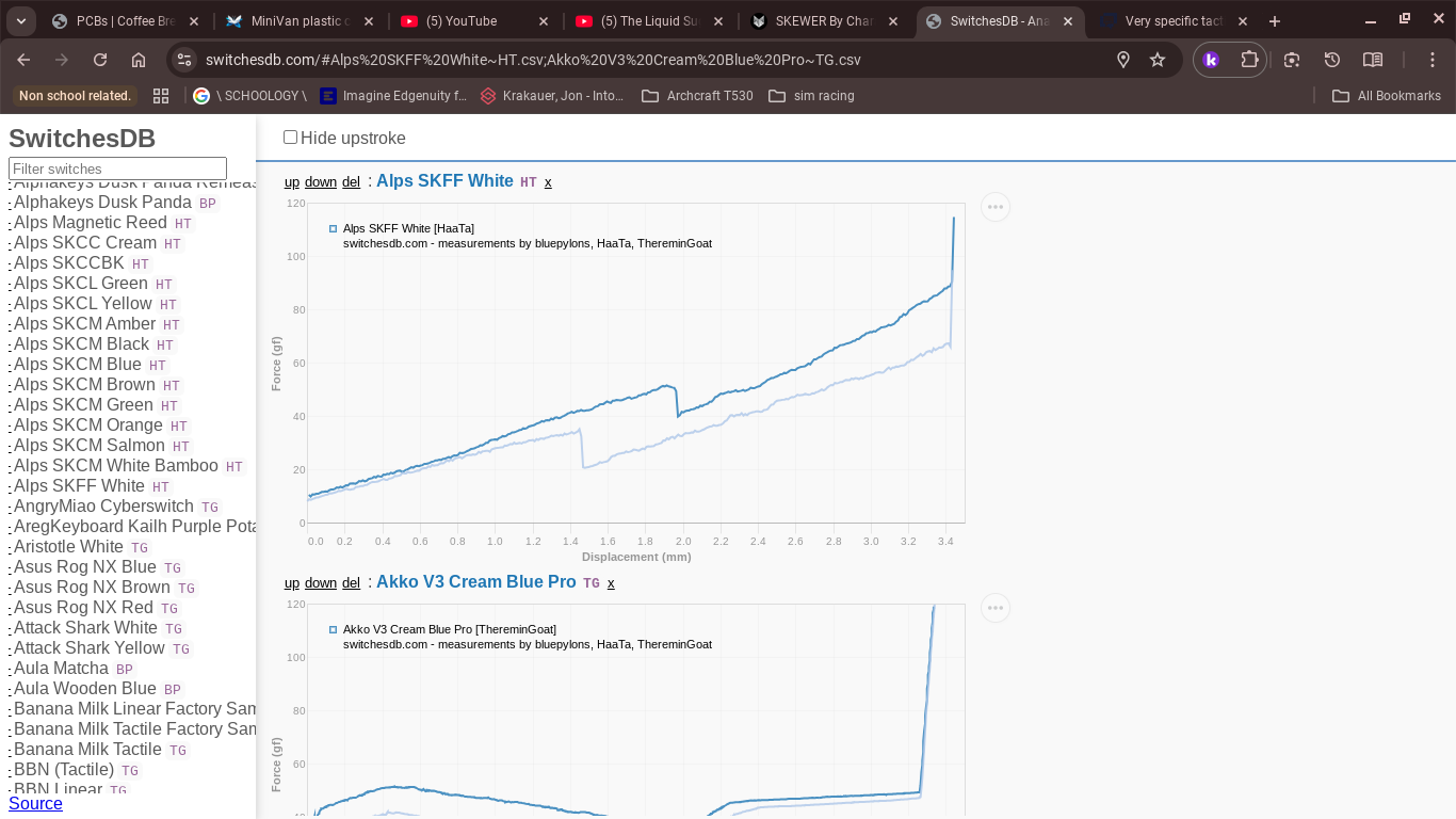

You might want to see if you can find someone to let you try an Alps tactile board. The force curves are very different, but they might be closer to what you’re after.

  • In just about every way, I think the absolute most index-y switch I can recall is an obscure franken made with the painfully expensive Moyu Black / Everglide Dark Jade stem in the housing of a Kono Midnight. In terms of the graph you drew, I think this is the closest MX option, but I hesitate to recommend it because it’s dumb expensive. It’s one big, round, clean bump with absolutely nothing else.

When you said that Alps switches are very different, I wasn’t expecting a linear graph!

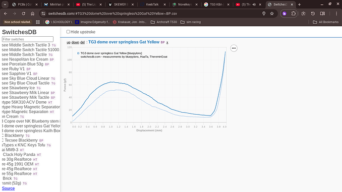

So I found the mod of placing a very specific rubber dome over a switch (from that cop car keyboard), and this graph looks very interesting.
my minor problem is finding the “TG3 KBA-(n)BLT” keyboard to harvest the domes from.
Going to be honest, those style of boards really don’t feel great imo, a rubber mat over an mx switch just feels mushy and not as clean as you’d hope for (at least the one I’ve tried). I also vote topre modded with bke redux or similar domes (maybe or aged 55g realforce), but I’d also consider some vintage rubber dome with slider boards like older qtronix or btc dome boards, those were pretty dang tactile and binary feeling for a rubber dome (stock topre in comparison were softer). A rubber dome just naturally is going to give you that constant roundness and more binary nature compared to a mx based switch (snap down, snap up, little pretravel with heavier and more aggressive domes)

Yeah I was gonna chime in the other day saying rubber dome or a handful of tactile ALPS would be your best bet for that specific feel you’re looking for. Although either way you go you’re looking at pretty rare & expensive switches. SKCM Neon Greens would probably be exactly what you are looking for unfortunately those are unobtainium of the highest order. SKCM Creams (not damped) would be another very binary feeling ALPS tactile, definitely a lot more accessible than Neon Greens, but your still looking at around $3 to $4 per switch. SKCM Browns might fit the bill to & are the most accessible of the 3, but still pretty expensive. Around $4 to $6 per switch, but you can get them much cheaper if you can find a board with them in it. Magnavox Videowriters have been my goto to get good condition Browns without breaking the bank.

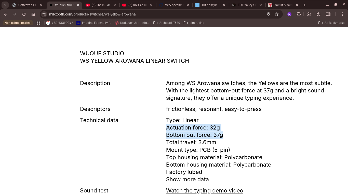

Very light linear (there may be lighter though somewhere else).

Sounds like this new switch might fit the bill, depending on how rounded you’d like your light switch style resistance curve to be.
This looks very intriguing.
