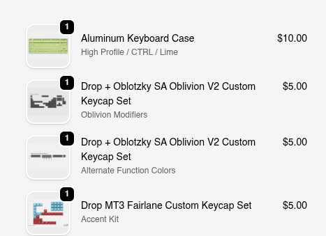

The Fairlane Accents should let me convert my knockoff Boston to MT3, the Oblivions should go well with several sets of Alphas, and the green CTRL case with that integrated plate is going to be handwired if I can fit in a small MCU, but if not there are lots of other options, from sourcing a PCB down to testing the laser on anodization.
I finally ordered an MTNU set. Let’s see how it feels!

I just ordered six of those :sweat_smile:
Worst case, I spent 60 bucks in vain, which I can afford.
Best case (pun intended), I get six cases for TKL-builds.

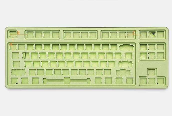

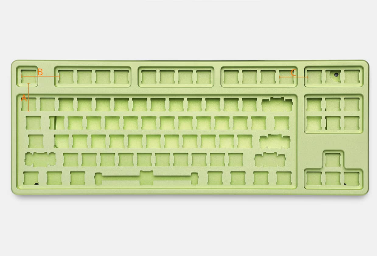

Mine just arrived. I haven’t checked, but I think the screwholes are M3. I’m also not sure there’s enough vertical space for the bottom row without their LED diffuser, but that shouldn’t be too hard to fabricate if necessary, and with an older design like this it’ll probably be needed as a force break anyway. The final hitch is those two USB openings are very close to keyswitches so you won’t be able to simply park a Pro Micro there, or even most breakout boards that I could see. My current plan is to use one of these with copious amounts of hot glue and, if necessary, a small grommet on the outside to make it flush enough. They designed it for their PCB and their PCB only.
Could you do me a favour and measure the following dimensions (A, B, C)
as precisely as you manage?
I ordered a Realforce 87u R1 off of mechmarket for $200. I remember like, 15 years ago (?) seeing the Realforce 87u online. I was just a teenager with a minimum wage job. I loved the aesthetics of it, but got into MX before I ever touched Topre. I’m excited to dive in :grinning_face:
Should be able to grab that for you tonight.
@63N
A and C are each ~28.5mm
B is ~38mm
I measured the back of the top case, because it’s flatter. Note that A has a chunky standoff right in the middle of it.
Thanks a lot! :+1:
That helps looking for a pcb that might fit.
Modifying the case would not be much of a problem, if only the cutouts for the switches align.
For everything else there are mills and other means of engineering I have at hand :wink:

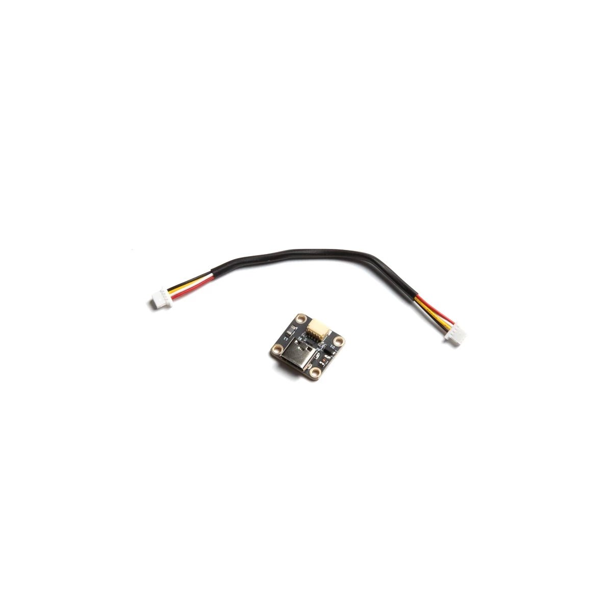

Ordered a Geon daughterboard so I can swap my Realforce board over to USB-C. Pretty much the last thing left for me to handle keyboard wise. I just can’t take the permanently attached cable anymore. Should be a fun little weekend project.

Nice! Would you mind linking which one you picked up? I just got my 87u and want to do the same. I figured out some methods, but they’re a bit involved.

I’ll have to cut one end of the JST to solder to the Realforce PCB, and then potentially file the case to fit the port, and then just hotglue the daughterboard in.
Gotcha, thanks! For a second I thought you found a Geon daughterboard that was compatible already haha. If only. I suppose I’ll get around to doing something similar. I’ve seen someone do similar with the OG RF cable + a usb-c breakout board as well.
