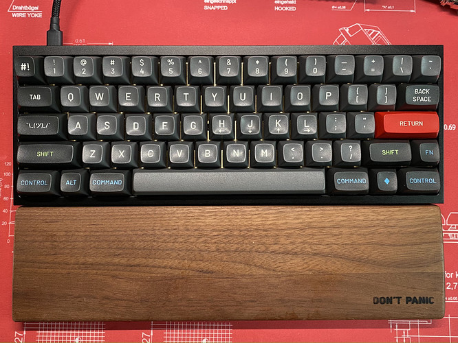

HHKB ruined me, started redoing all of my MX keyboards into the split-backspace/split-shift layout
Started yesterday with my Tofu 60, Box royals inside. That felt just optimal before, now it feels way too heavy, I guess I need to find new “second best” switches in the MX World now

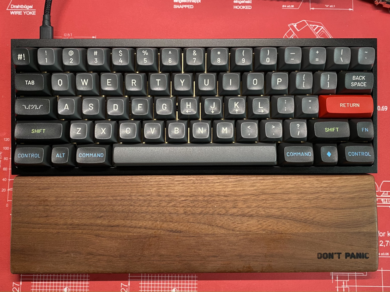

2.) I once knew someone with “DON’T PANIC
” tattooed above her lower back, in the style of the Hitchhiker’s Guide movie artwork.

Before December and my switch to HHKB, I’ve preferred heavier switches. So, no, but I also think I am giving up on tactile MX’es and will go on MX to linears only while tactility I leave to Topre which is doing it good. ![]()
Would there be any copyright issues with a “Don’t Panic!” novelty keycap? I’d love to see one of these.

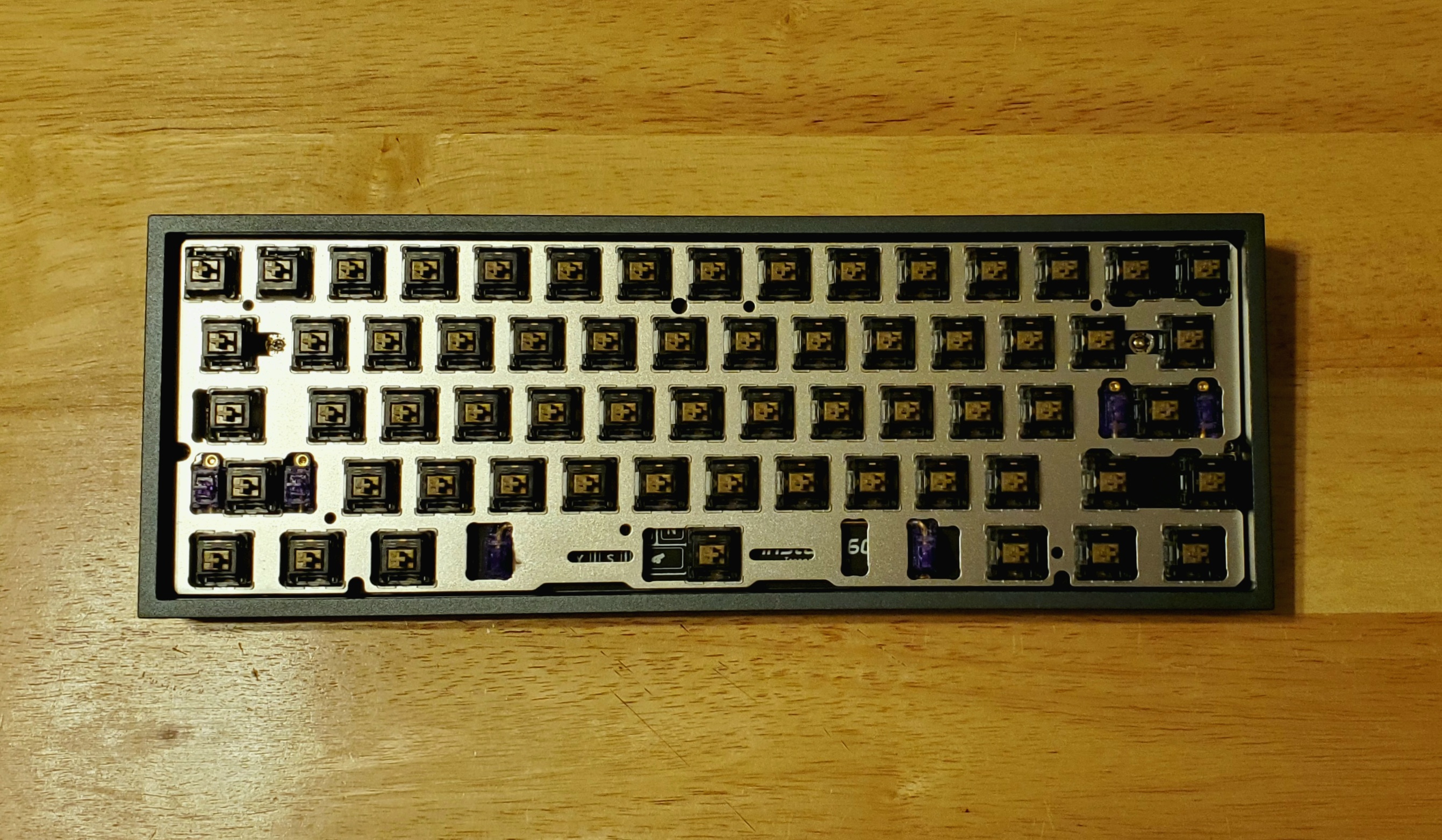

Was messing around with my Pewters loose & decided to just throw together a quick hot swap build with them just to see how they perform in a board. I didn’t mod the switches in anyway, just cherry picked the best factory lubed ones out of my batch for this. Threw them on a Instant60 Tsangan, with a Duck Raven MX Alum. plate, purple Durock V1 stabs, & threw it in my Klippe (Rd.2 Klippe I think, the one with the removable middle standoffs).
Been typing on it since last night & I have to say these are some really nice switches! A bit louder than I’m used to cause I haven’t used tactiles in quite awhile & they are not manually lubed. I do expect the sound to tighten up some with a proper lube job, although these will have a higher pitched bottom & top out even then since they have PE blend housings. So I won’t judge the sound too much till I get these properly lubed.
Feel wise though I can give some more solid thoughts on them. I would say they ended up creating a much smoother ergo clear rather than an upgraded brown with these. Which is actually a better feel for me TBH. Any browns I have ever tried are just a tad below what I’d prefer for tactility while ergo clear like tactility has always been my fav for MX tactiles. The 58.5g spring in them really compliments that ergo clear feel too!
All in all, now that I’ve tried them in a build I would definitely recommend these switches for anyone looking for a light but noticeably tactile typing experience. They actually have a flow to them when typing at speed, which I feel the hyper tactile switches do not have simply because their tactile event is so huge bottoming out is unavoidable. I still have to give the Penguins & Mode light tactiles a try, but Pewters have given me hope that light & mid tactility switches are not dead!
