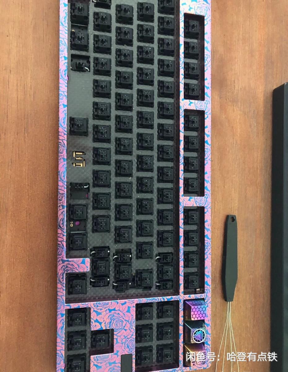

A really custom, custom keeb case. It’s not mine, but I thought it was cool enough to share in this thread. This is a titanium case that’s possibly had the rose pattern dye-sublimated/water transfer printed onto the metal, but the info I got is for aluminum…it also looks like it’s been heat blued prior to the whole rose print thing.
I also asked caustic customs weeks ago if he could do something like this. He gave me a hard no on both titanium, and the doing of the pattern.
That’s all I got from my research. Seems the exact process is typically trade secret stuff for any firm that can do it.

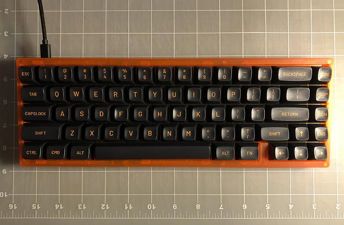

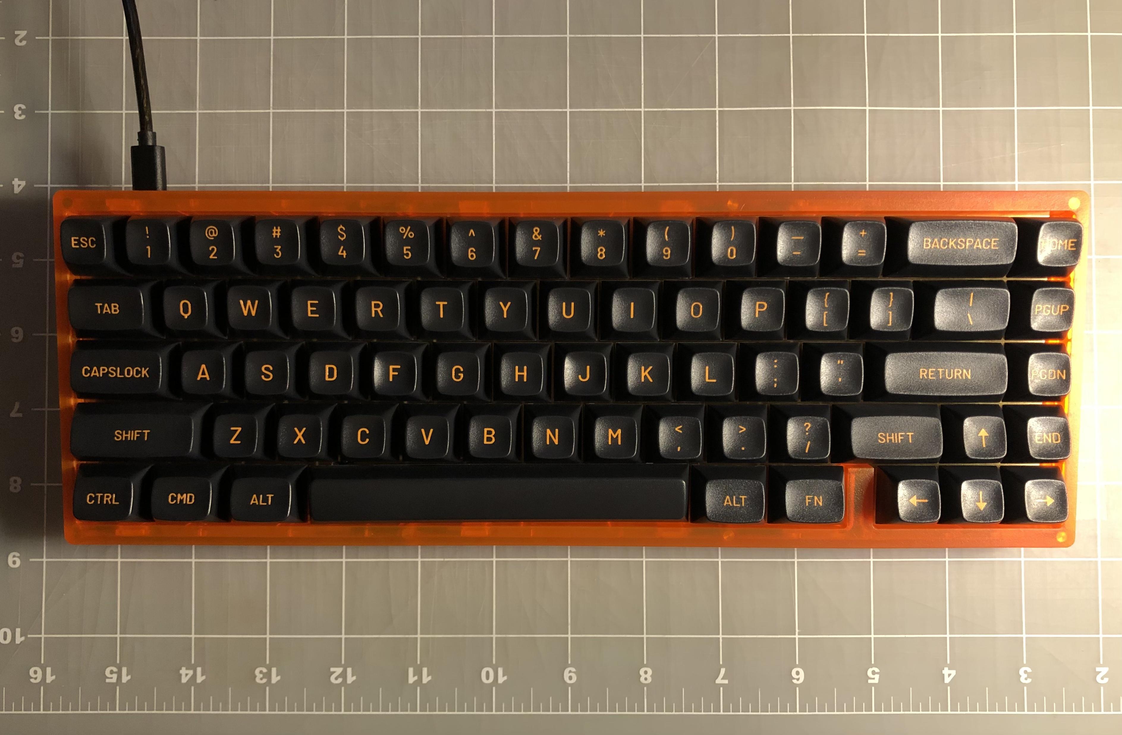

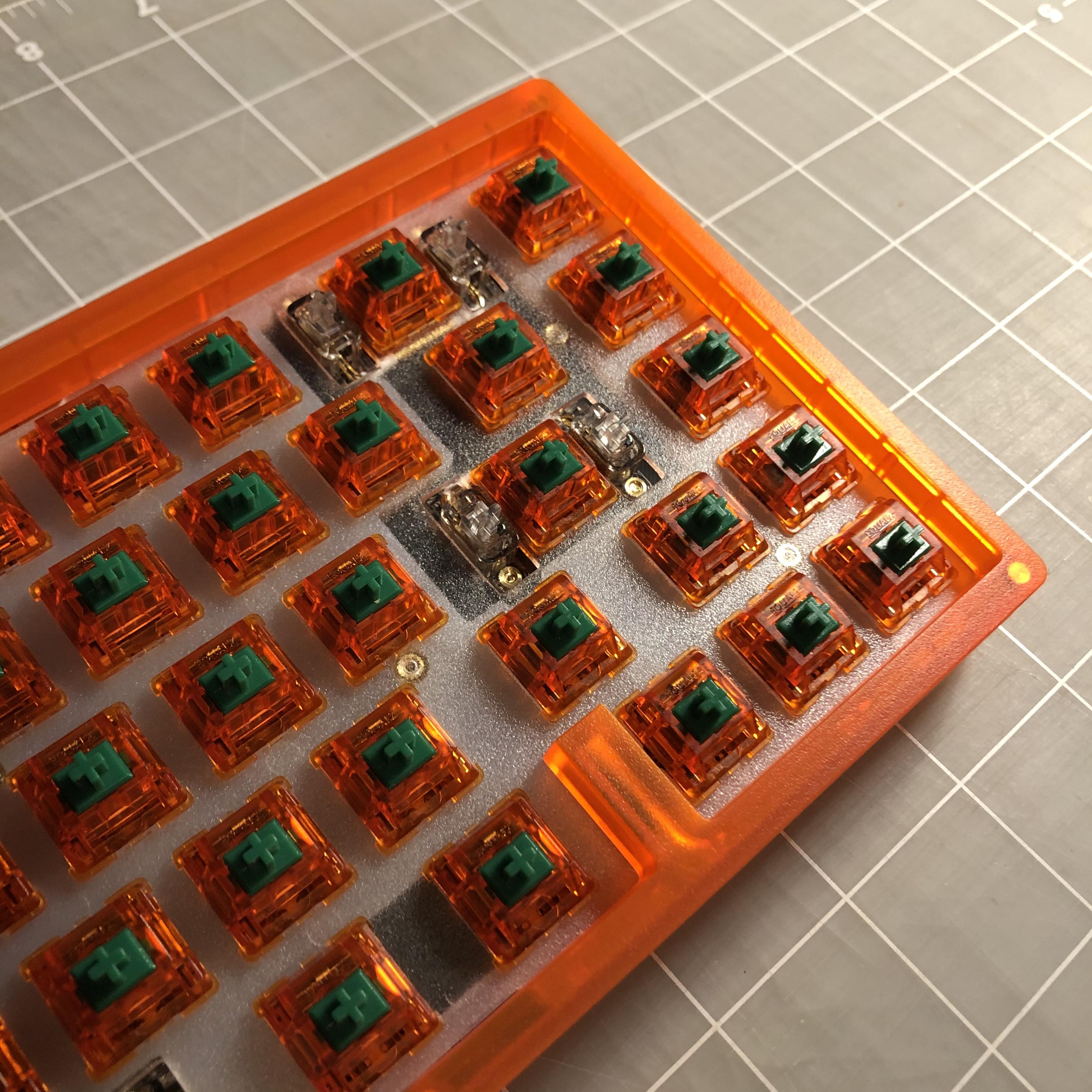

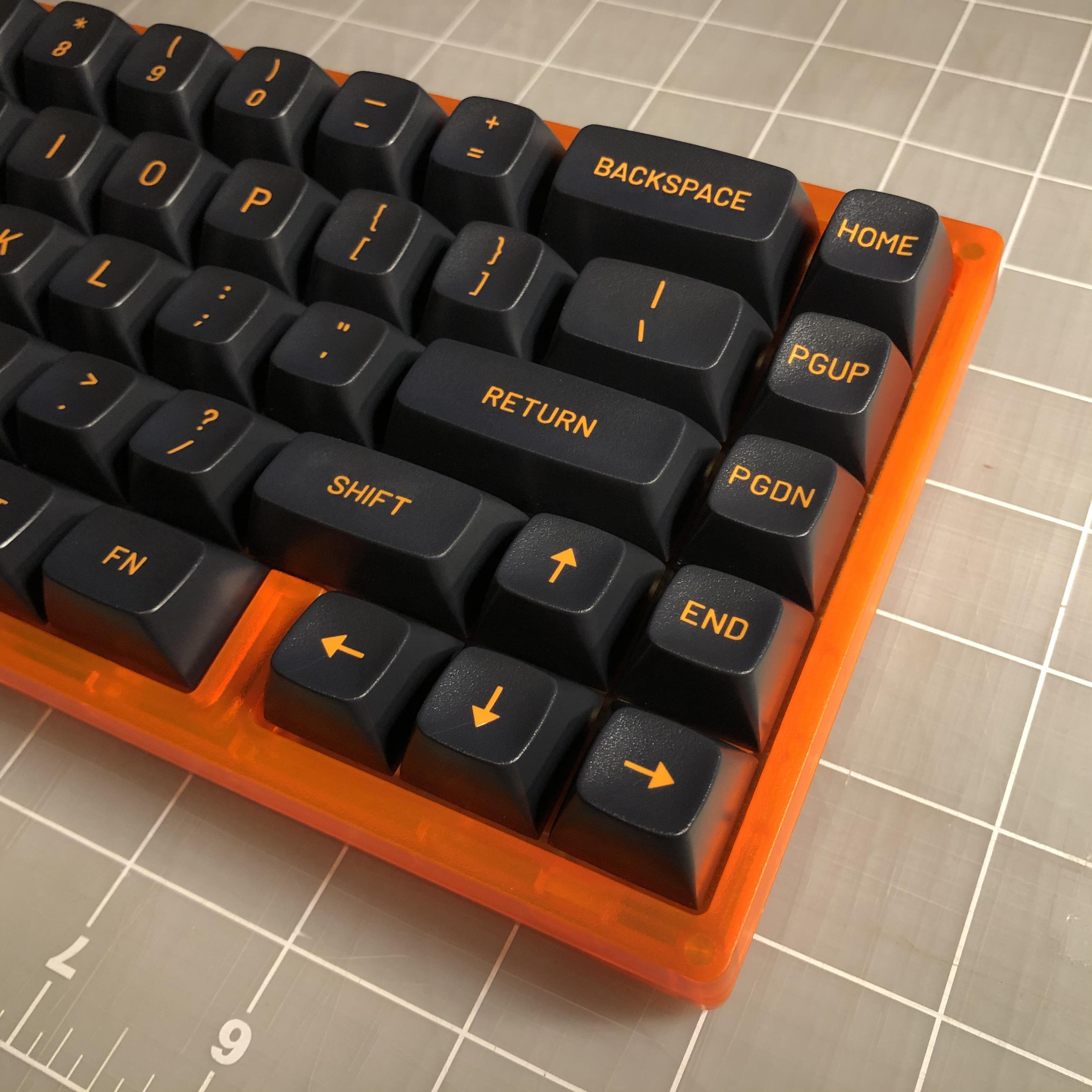

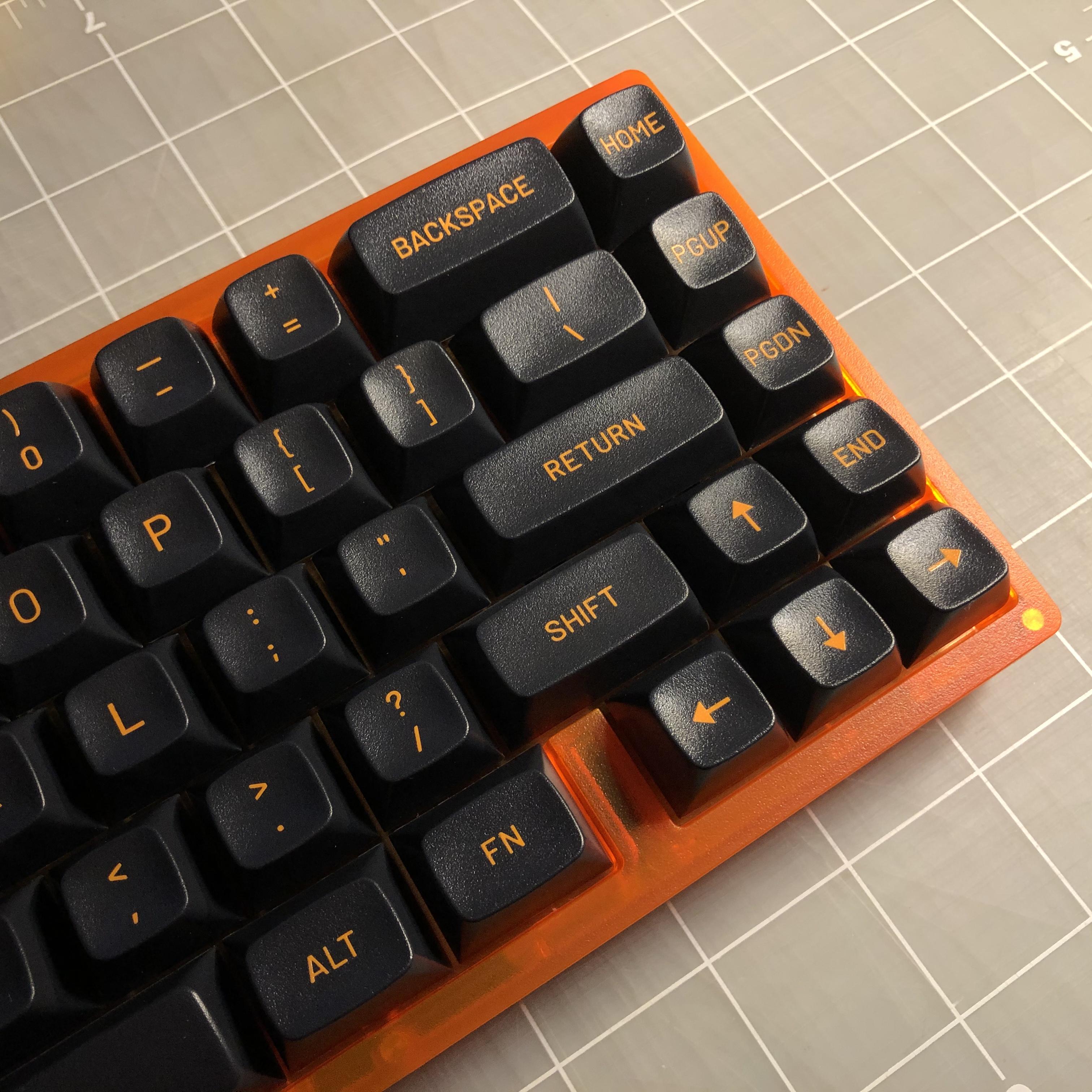

  • KBD67L R3
  • KBD67 MKII RGB V3 wired PCB
  • Orange case
  • Brass plate (KBDfans)
  • Boba U4 silent tactile switches
  • KBDfans polycarb stabs
  • MT3 SKIIDATA
I didn’t know what I was going to do with the orange case, but I knew I wanted to do a build with it. When Skiidata came along in MT3 profile, it just sort of fell into place.
I had a model F-14 Tomcat as a kid, made of the same nuclear-orange plastic - maybe it reminds me of an old favorite toy, maybe I just like brightly colored translucent things.
I had Tangies in with a poly plate at first, but I didn’t like the sound.

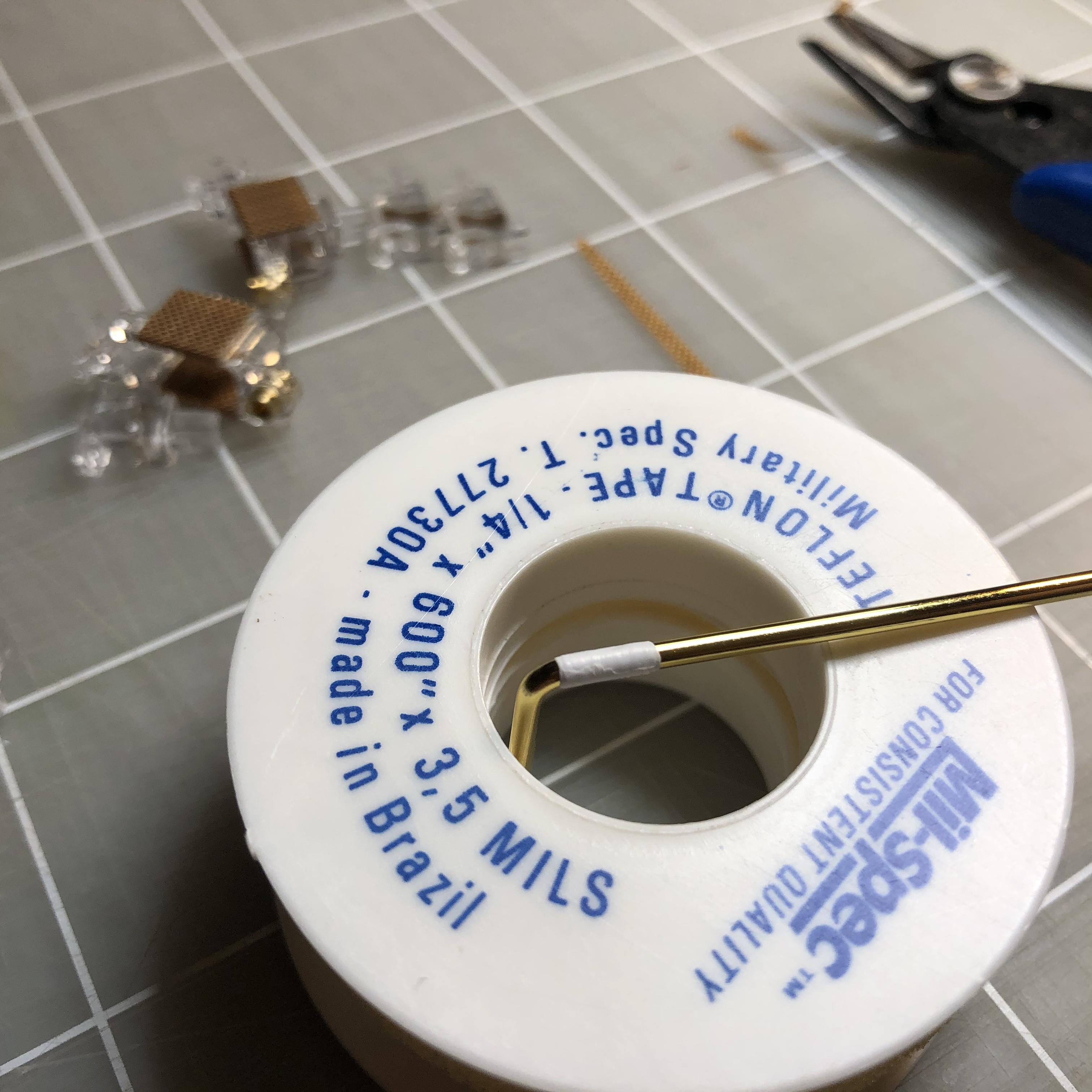

Oh yeah! I tried this with the stabs:
Fiberglass PTFE tape in the stems and housings, PTFE thread tape for the wires. Surprisingly effective for an all-dry tuning approach, but I think the KBDfans stabs have a bit too much forward and back play to get totally satisfying results with it. I’ll have to try it with some other stabs next time I do a build.
That looks awesome. I got word that Skiidata shipped for me too. Now if they actually shipped it UPS I’ll see it next week. If by Fedex, probably next month.
Gosh. I gotta try them PTFE tapes some.
So true. My results exactly.
Just comparing notes, do you tape both the top and bottom of the stem (big ramp and little ramp) or just the top? I can’t ever get the bottom tape (little ramp) to stick after adding any kind of lube.
So far I’ve just tried this with the KBDfans ones, but that experience has me thinking it’s going to depend on the stem. In the case of those particular stems, there’s barely enough vertical clearance for the wire to allow for one side to be taped. I’ll be trying the mod in some other stabs at some point; I have some GMK and imitation Cherry screw-ins coming and I intend to do some testing with those.
So this I haven’t tried yet, but is next in queue for testing. So far it seems like the thin strips of tape have trouble sticking with any introduction of oil on a surface before sticking-down; I’m talking just my fingers here. I’m borderline obsessive with how much I wash my hands, and the oil on my fingertips is enough to compromise that adhesive when it comes to very small or thin pieces.
It also seems like it has trouble in general if there’s just a small flap after a bend, with the force of it wanting to straighten back out overcoming the adhesive if the initial application wasn’t just right.
I’m thinking at least when it comes to stems, the effectiveness of this tape will depend a lot on the dimensions of the stem, and how well the adhesive can grip its surface.
When it comes to housings, I already love its capacity to tighten-up tolerances and provide a slick surface without lube, but I definitely have a lot more to learn when it comes to getting the most out of the three different PTFE tapes I picked up recently.

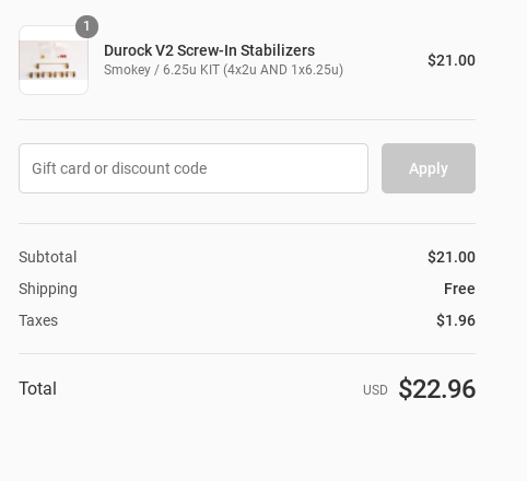

Really want to keep these stabs because dropping 21 bucks on durock stabs is painful. If anyone has any way to get rid of tick please let me know. I’ve wire balanced, lubed, holee modded, and broken them in.

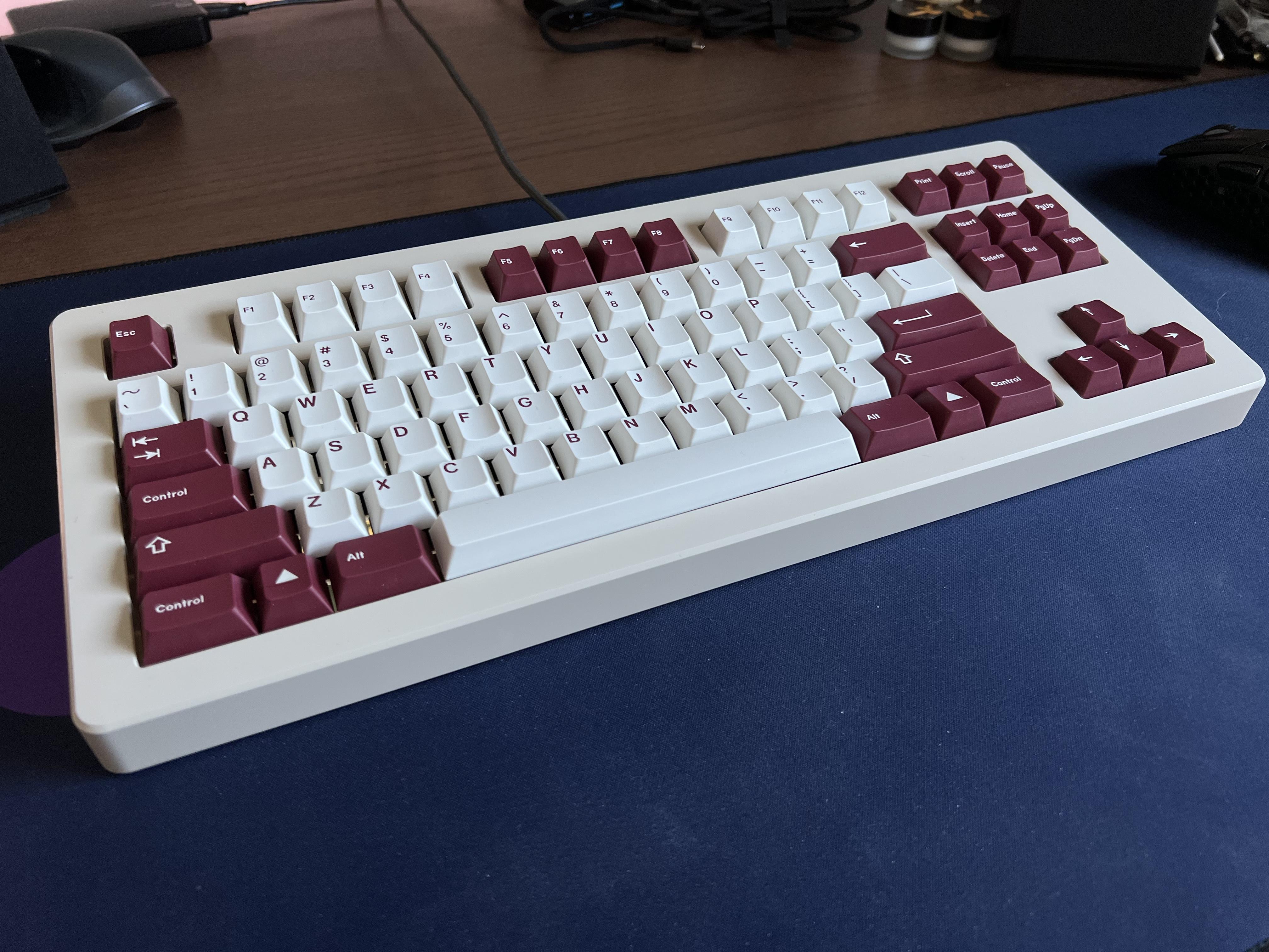

Not the best photo but I’m enjoying the classic, no-frills typing of this KFE CE. Top mount, alu plate, Greetech browns, & CRP dyesubs. Sounds and feels just right.
