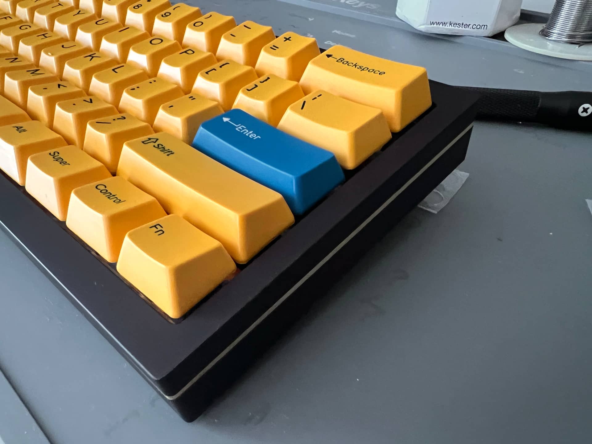

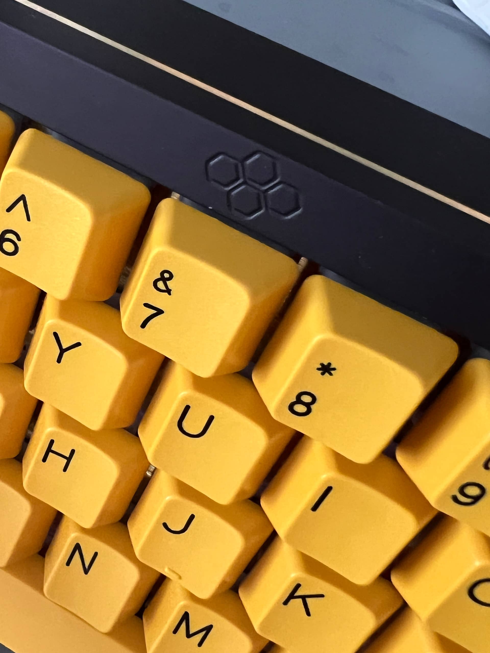

LOVE the little quacker! A little display niche definitely going in my list of ideas to steal.
Thanks. There is a little magnet glued into a recess in the bottom of the case so it can be swapped out.

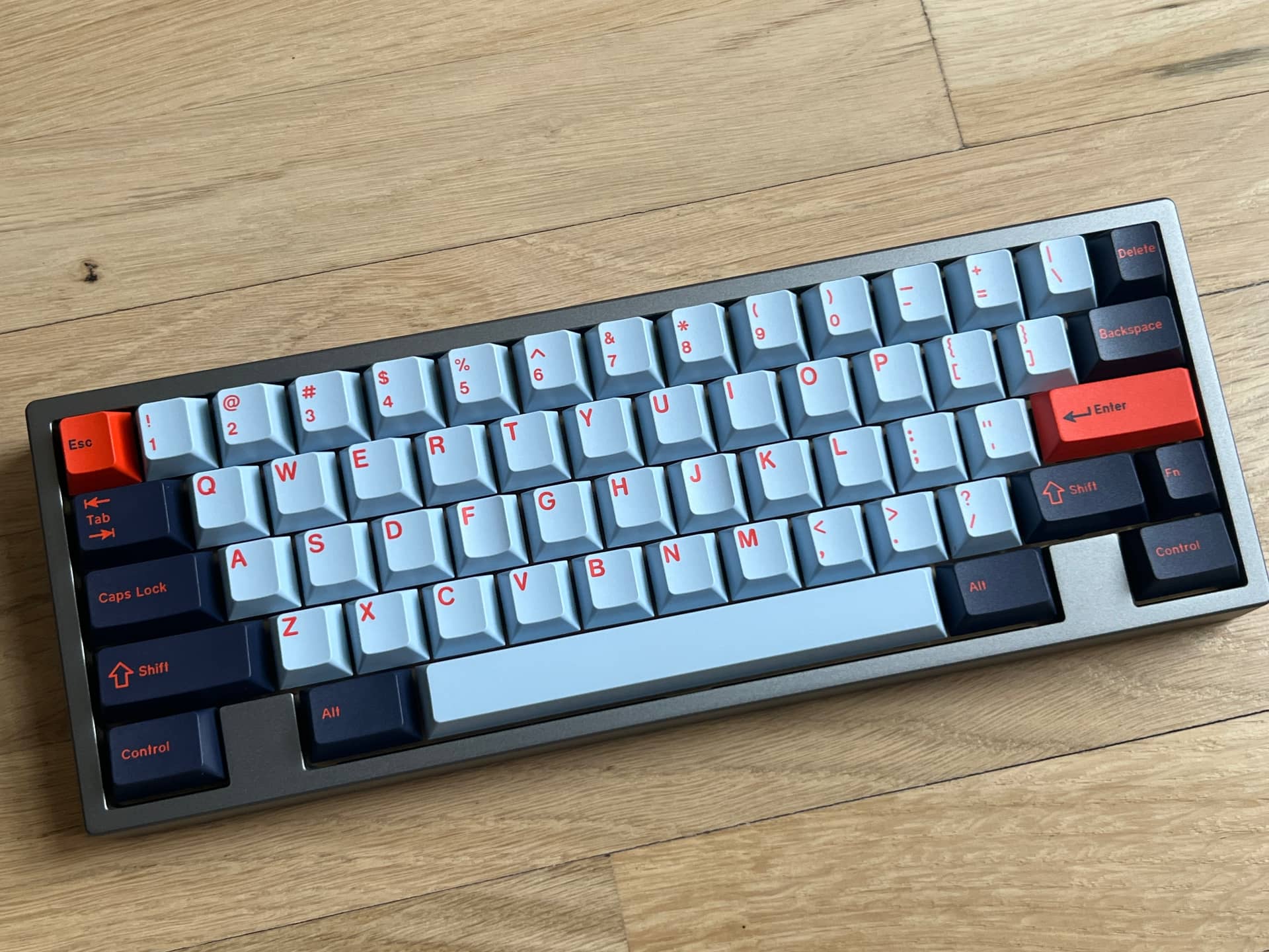

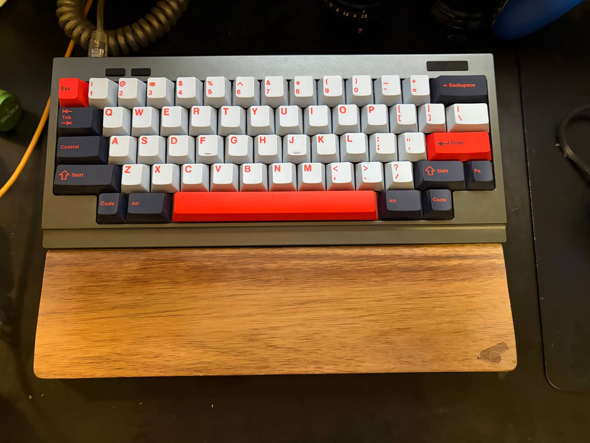

Today I built the s58m keyboard that I picked up on mechmarket.
Not bad for $80! It’s a nice board with a little work.

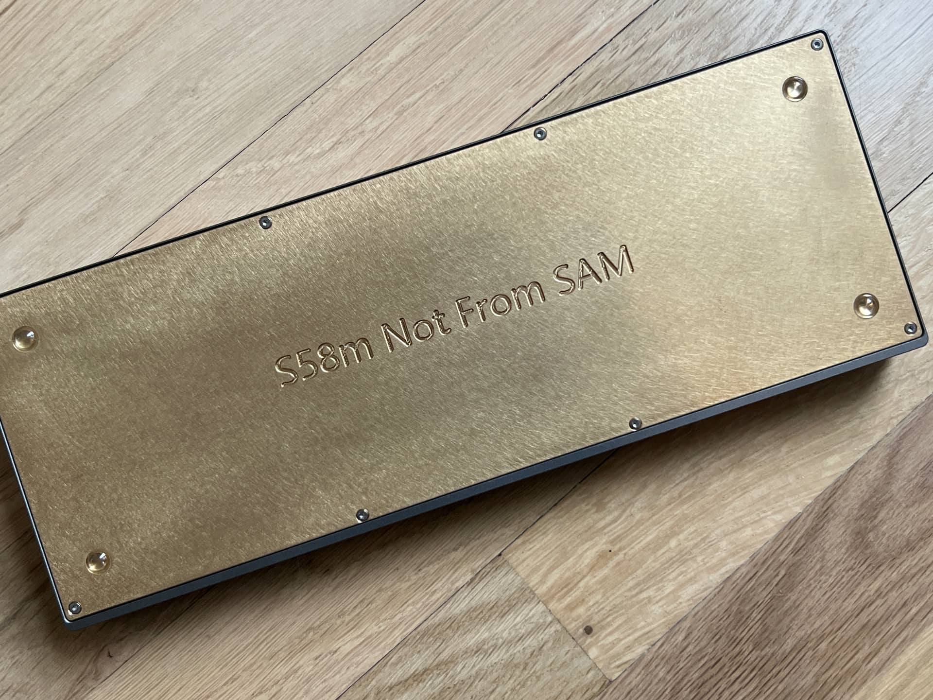

I love the vibration finish on the brass. It had a lot of patina and was very orange when I got it. A little bar keepers friend and it’s like new. Added a coating of mineral oil and it has kept it from oxidizing as quickly.
It is top mounted. Brass plate with BSUN maple sugars.. I added small orings as gaskets between the brass plate and top. That fixed 75% of the feel and sound. Then I added a strip of painters tape around the bottom brass section to isolate it from the top case. That was also a large improvement.
It’s compatible with all standard 60% PCBs so I used one of the WT60 Hotswap PCBs that I recently picked up from Novelkeys on clearance.
Speaking of that… I ordered 3 PCBs and got 4! What a nice bonus :grin:

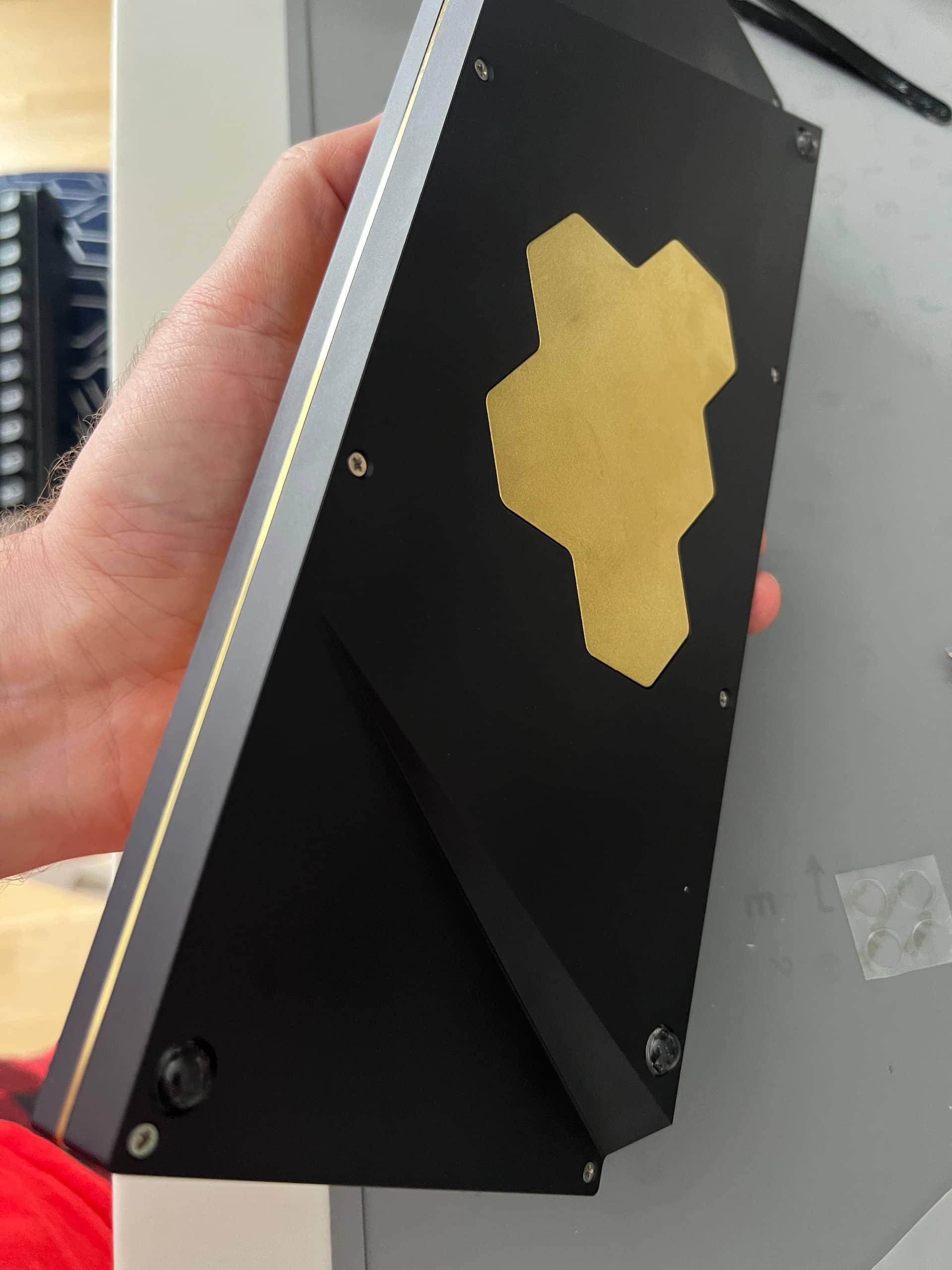

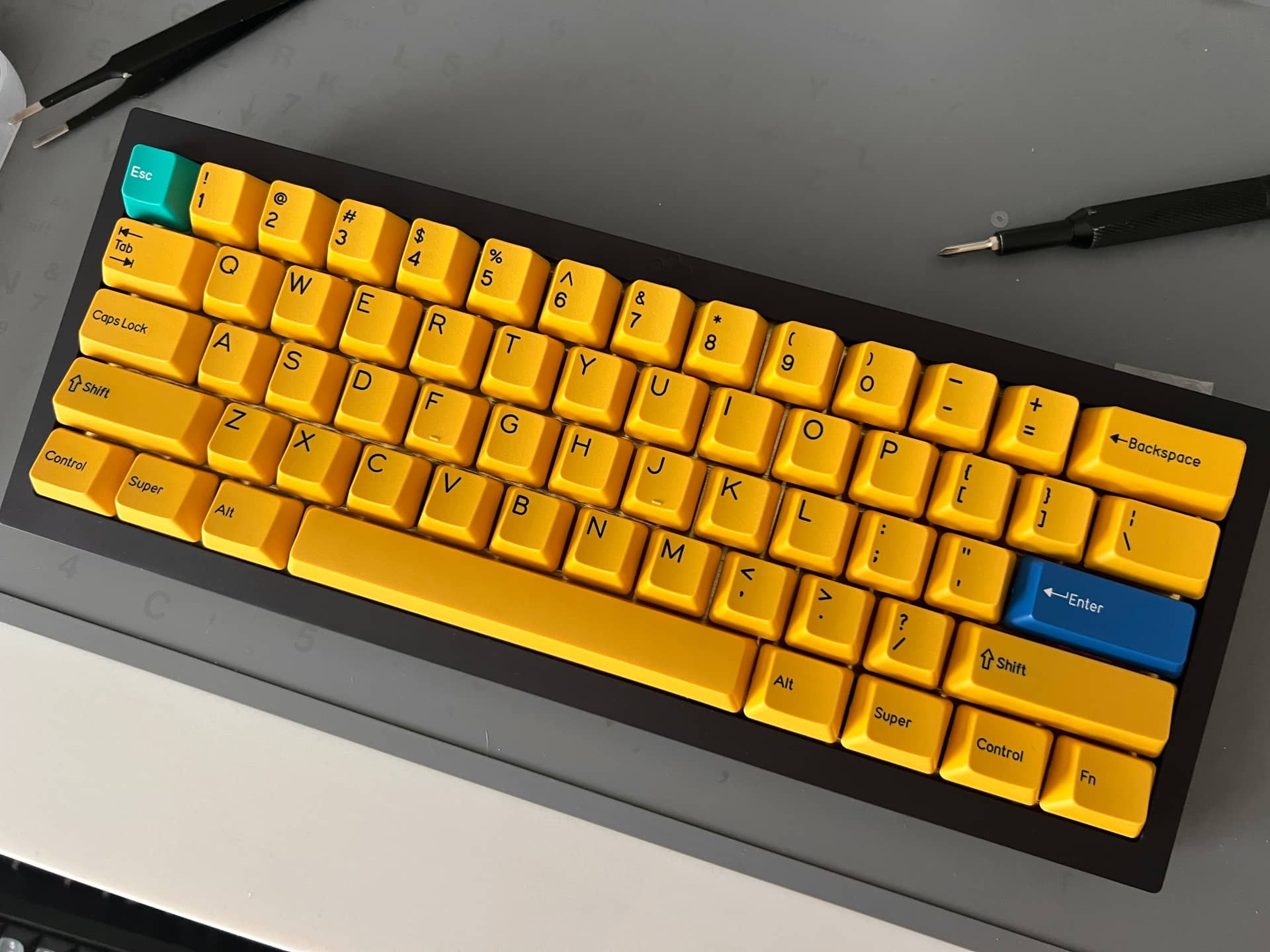

My other $80 pickup. A hive60. Never built until today.
Built with some hand assembled MM switches. Blue top, purple bottom, yellow stems, 62g springs. Brass plate. Very solid but not harsh. Lovely keyboard. The DCS caps keep it pretty poppy on keypress. Sound is exceptional with no hint of ping or hollowness. No mods needed.

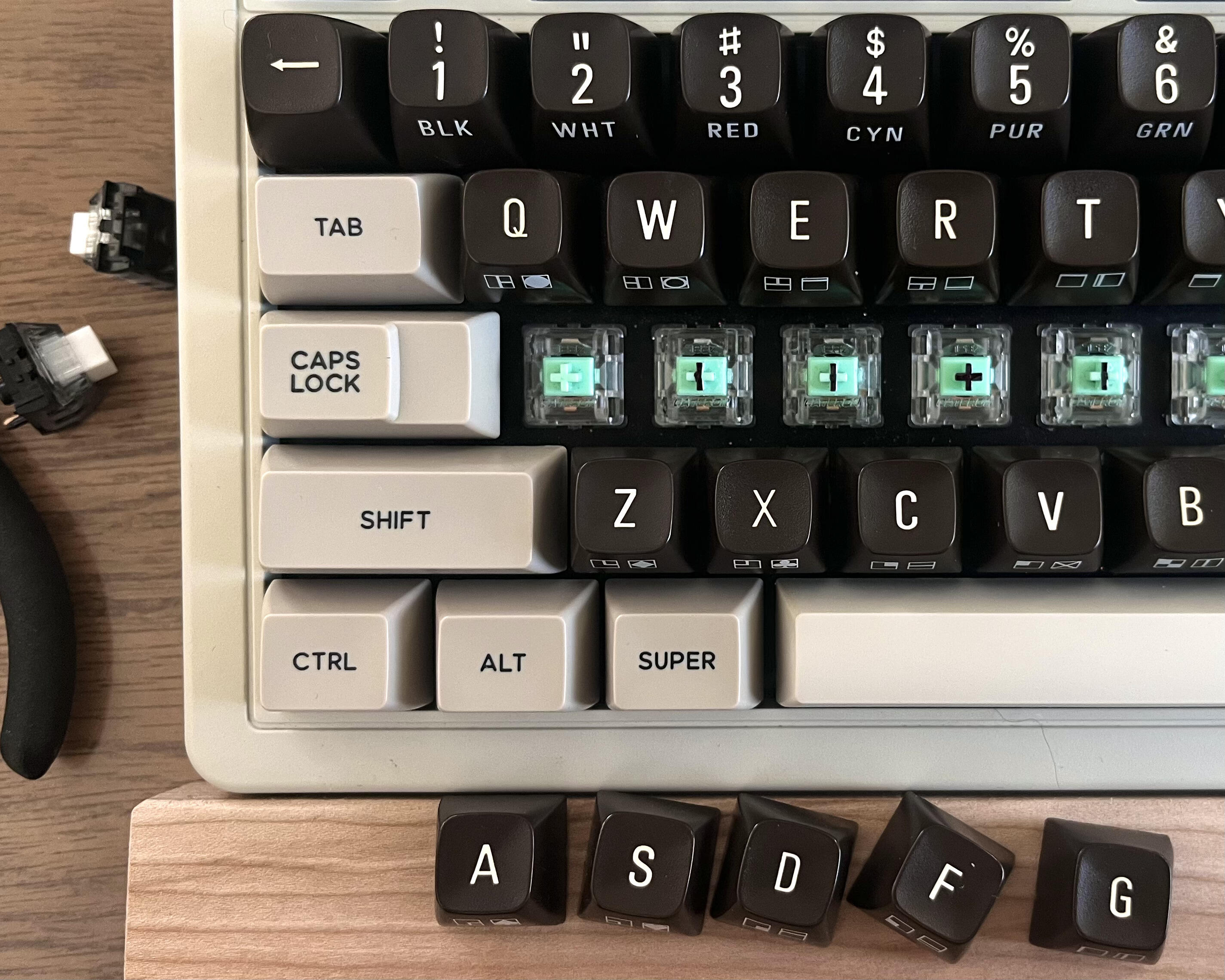

I thought my Alf X2 was broken but it turned out it just had bad firmware and a couple of the keys weren’t programmed to do anything for some reason. The enter key was also not clicking so I replaced that switch. The zealiostotles in there are pretty janky but I really like the sound.
Now, that’s a name I’ve not heard in a long time. A long time.
I know there are better switches out there nowadays but I actually quite like them here.

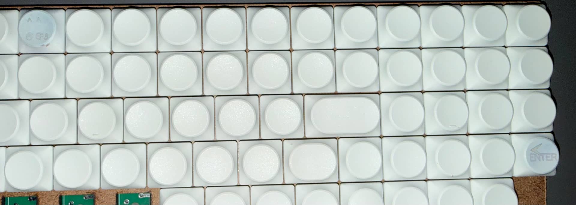

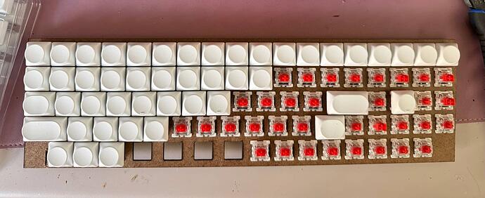

Trying something new with my laser dye-sub caps. My old jig indexed on a couple of standoffs, and I was having real trouble getting that last half-millimeter of alignment. I might still have that issue indexing on the sharp lower-left and upper-right corners of this plate (courtesy both of a piece of scrap just a skosh too small to use for the final switch-plate and a bunch of generic red switches), but at least any misalignment will be completely consistent. The SLK blanks are also just the tiniest bit wider at the base than most profiles, better to accommodate the travel with lower height I assume, so I needed some sort of new jig for them anyway. Pretty soon here, I will sacrifice a few 1u to testing.
I still haven’t quite landed on my legend design, and my persistent issues with perfect centering make me hesitant to go with what ought to be obvious placement. Still, there was at least one Siemens board with tophat caps that placed the legends off center, and I’ve seen MA clones do something similar. I’m wondering if something dramatically italic in the upper left would help make my tooling limitations feel intentional.
Yep! Dramatically different from the norm is “design” while slightly off is a mistake.
Blech. My usual “recipe” for this process on Aliexpress blanks did not work well at all on the SLK. Fortunately, I was smart enough to just ruin two 1u caps on the initial tests. Need to decide if I just table this while I still have a set of blanks I could use or sell, or if I start experimenting on the ISO enter.

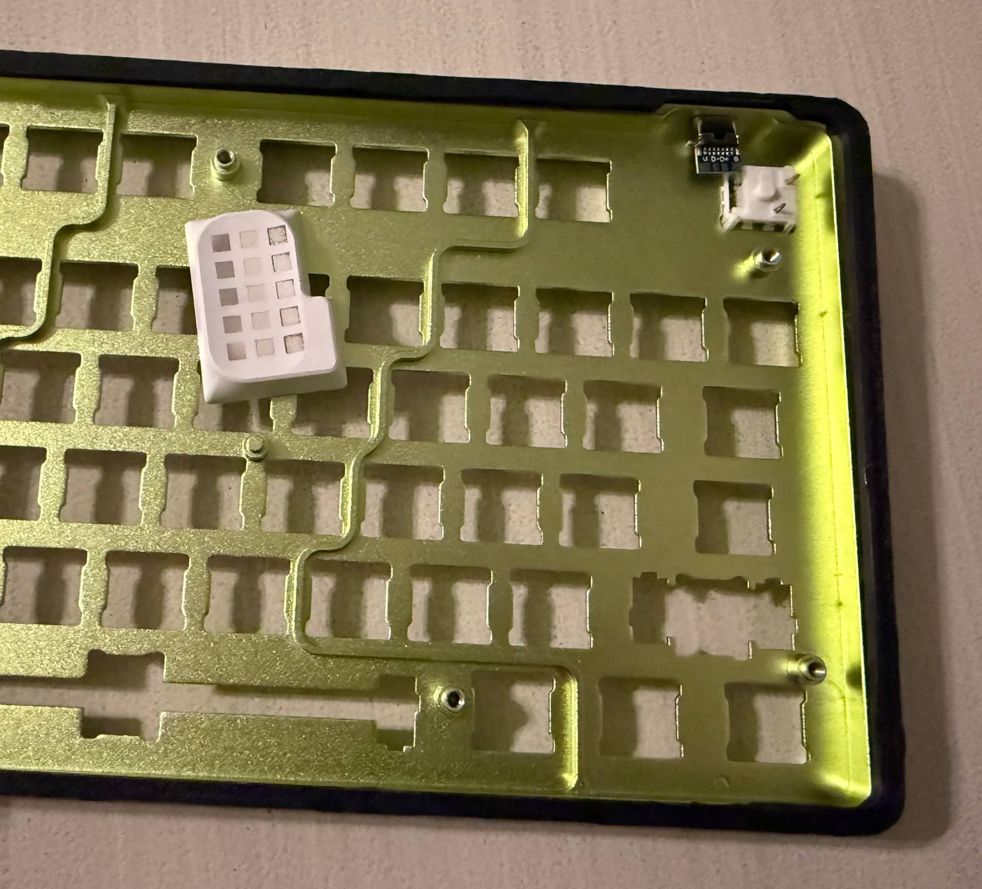

Behold the juxtaposition of failure and potential. On the plus side, the second iteration of the spacer for the Drop CTRL case is a pretty decent fit. Also, the USB-C port fits well enough that I should be able to secure it with little to no surgery on the switch for the escape key.
On the other side, I ran a proper material test with my blank SLK ISO enter, and yeah, the particular formulation and color of PBT does NOT like my lasering recipe. This is, frankly, not worth the trouble of continuing down this particular path when I could change tactics entirely or even maybe just move the blanks on to someone who might have more use of them. My guess is that it’s “better” plastic than the Ali-Express blanks I normally use, and without the pressure that usually comes with dye sublimation I am just not going to get penetration.

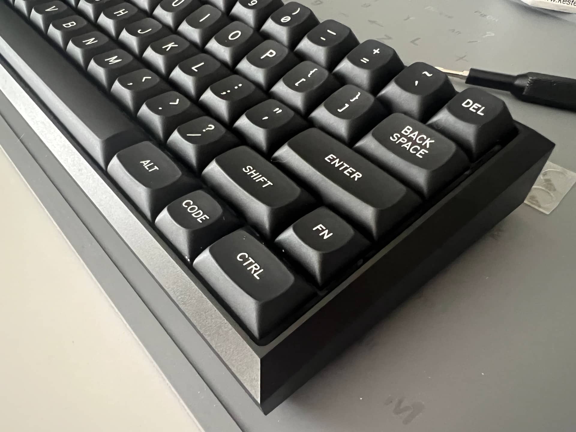

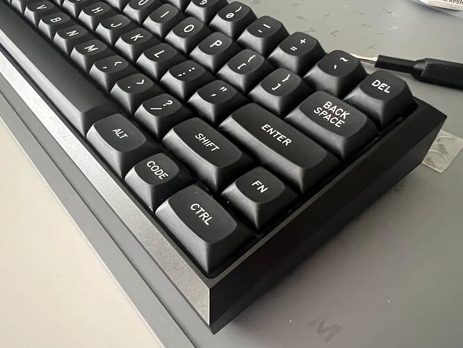

Worked on swapping in these 35g Astrodomes (Shiners) into this new HHKB.
I left everything stock. I just don’t want to mess with lubing or stem swapping right now. A lot of the general consensus I hear around the HHKB, is that the best experience is mostly stock.
That being said, I like the new weight of these domes, but I think there is a little too much keycap “wiggle” or sloppiness now. I am not really sure what might be causing it. It could be the shape of the dome (BKE style) compared to the OEM style or it could be that the weight is just so light, it leads it to being loose-goosey. However I am leaning more towards the former. I have checked out some DES dome typing videos, and they do not seem to have the same issue that I am having.
So now I just bought these and I am looking at 35g and 42g DES domes :joy:
