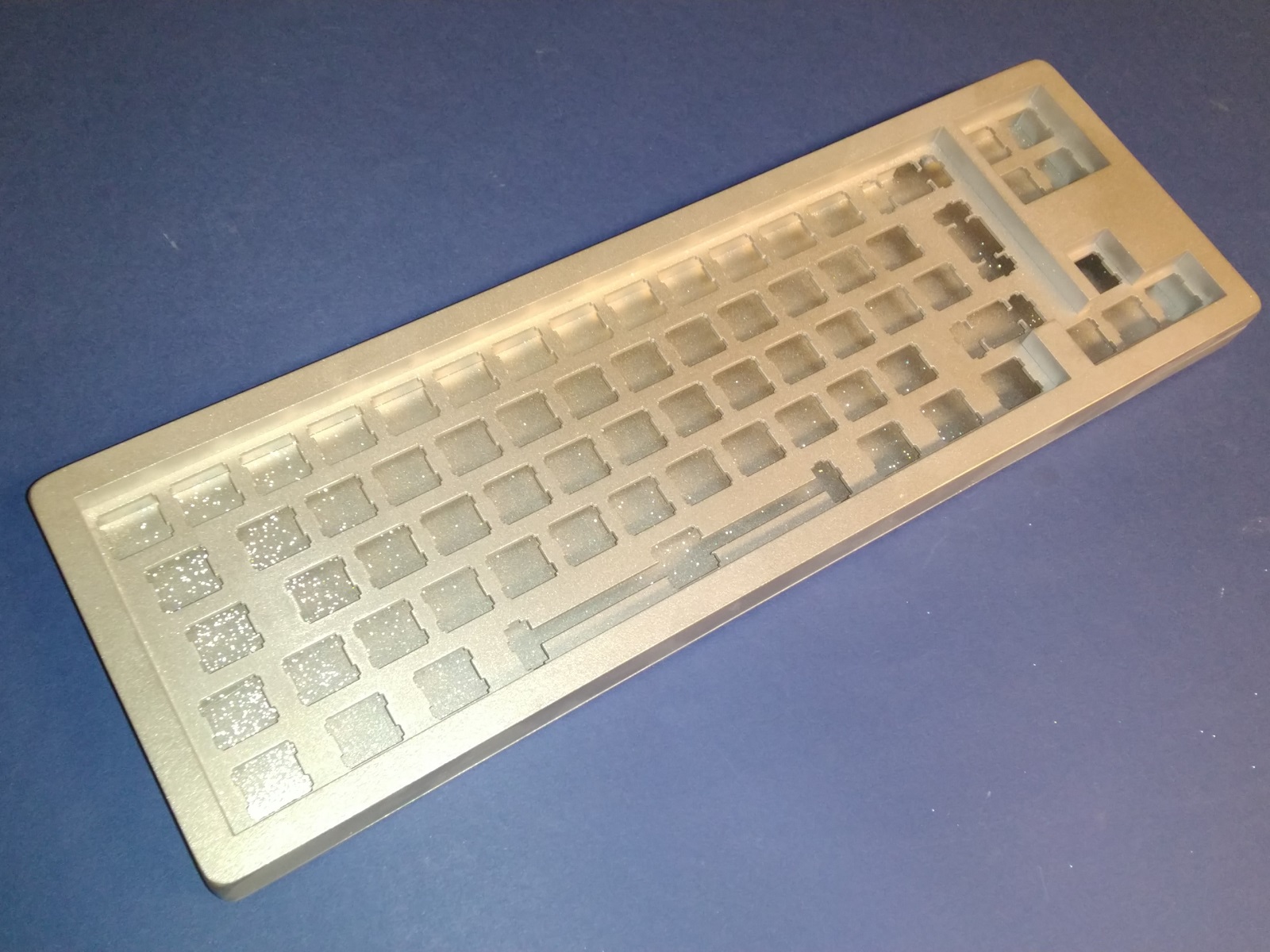

I glass bead blasted the case today, and I am quite happy with the result so far.
Picture taken right after blasting:

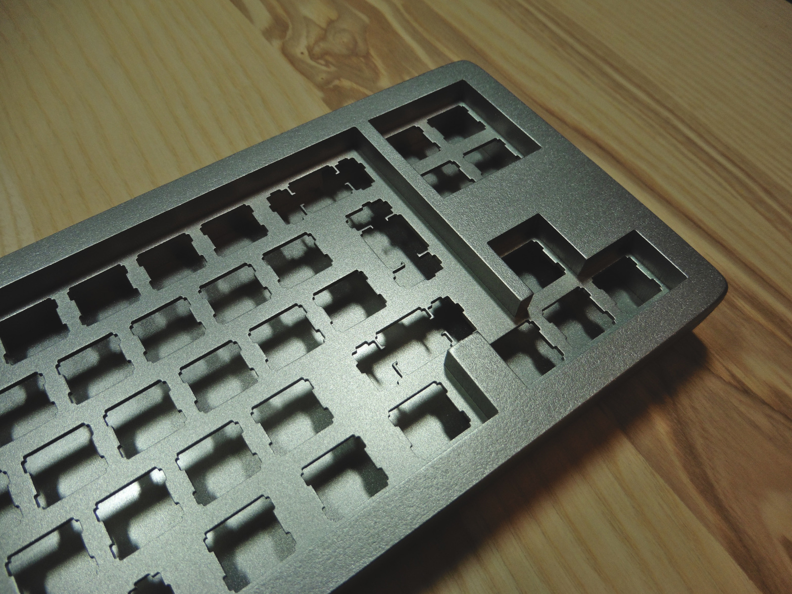

I found some visible imperfections in the surface, so I gave the case another round on the belt sander.
After that I bead blasted again, with a little higher pressure.
Now I am satisfied with the result:

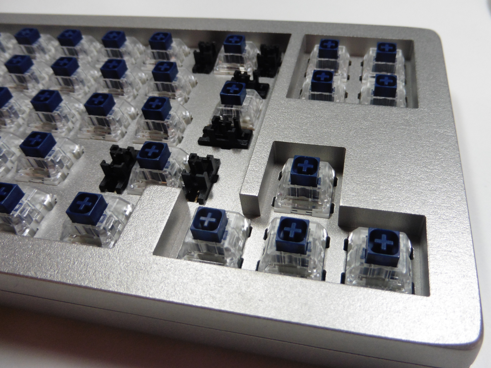

Firmware, soldering and assembly is done.
I thought to myself, a case that heavy needs heavy and loud switches.
So I went for Kailh Box Navys. Loud and heavy…
