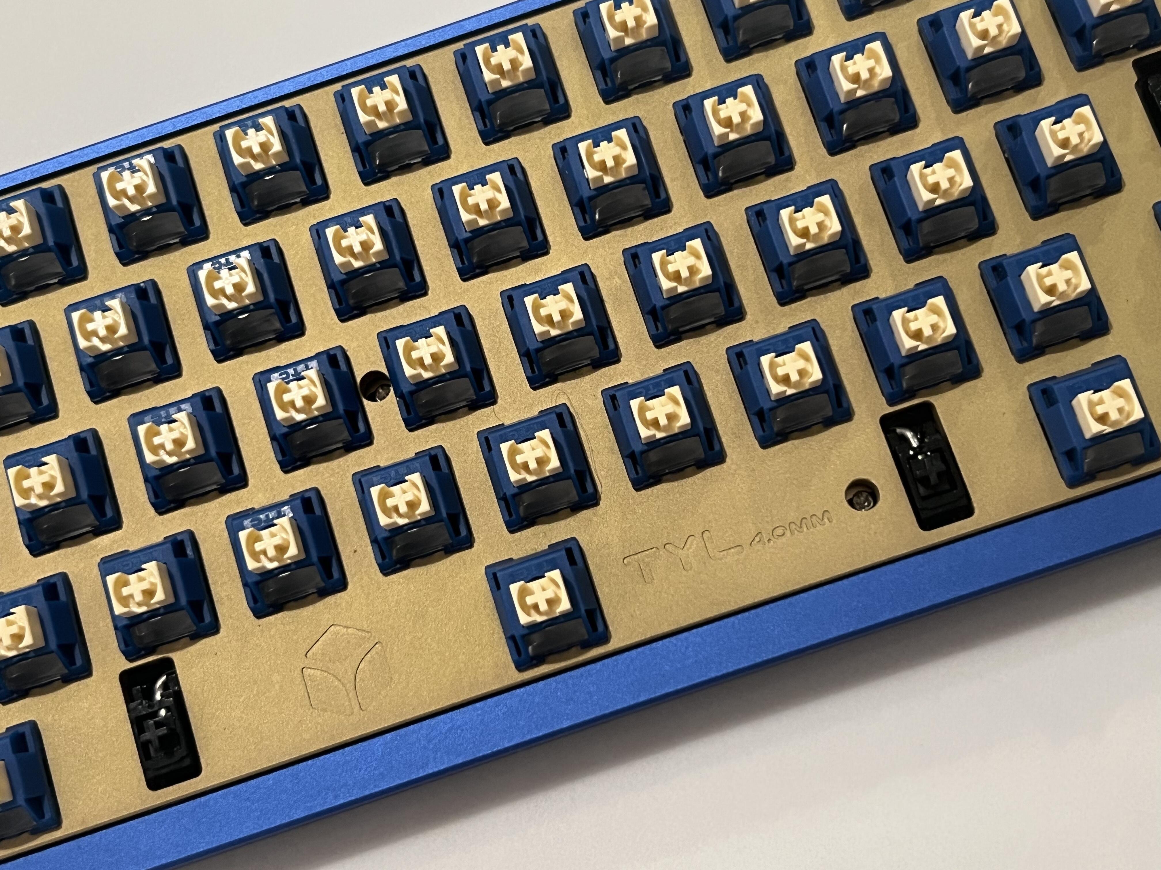

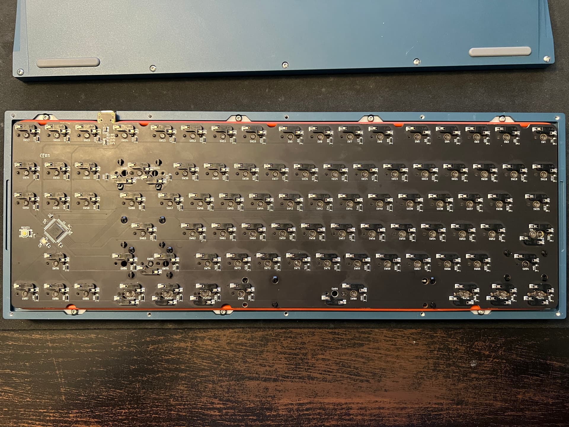

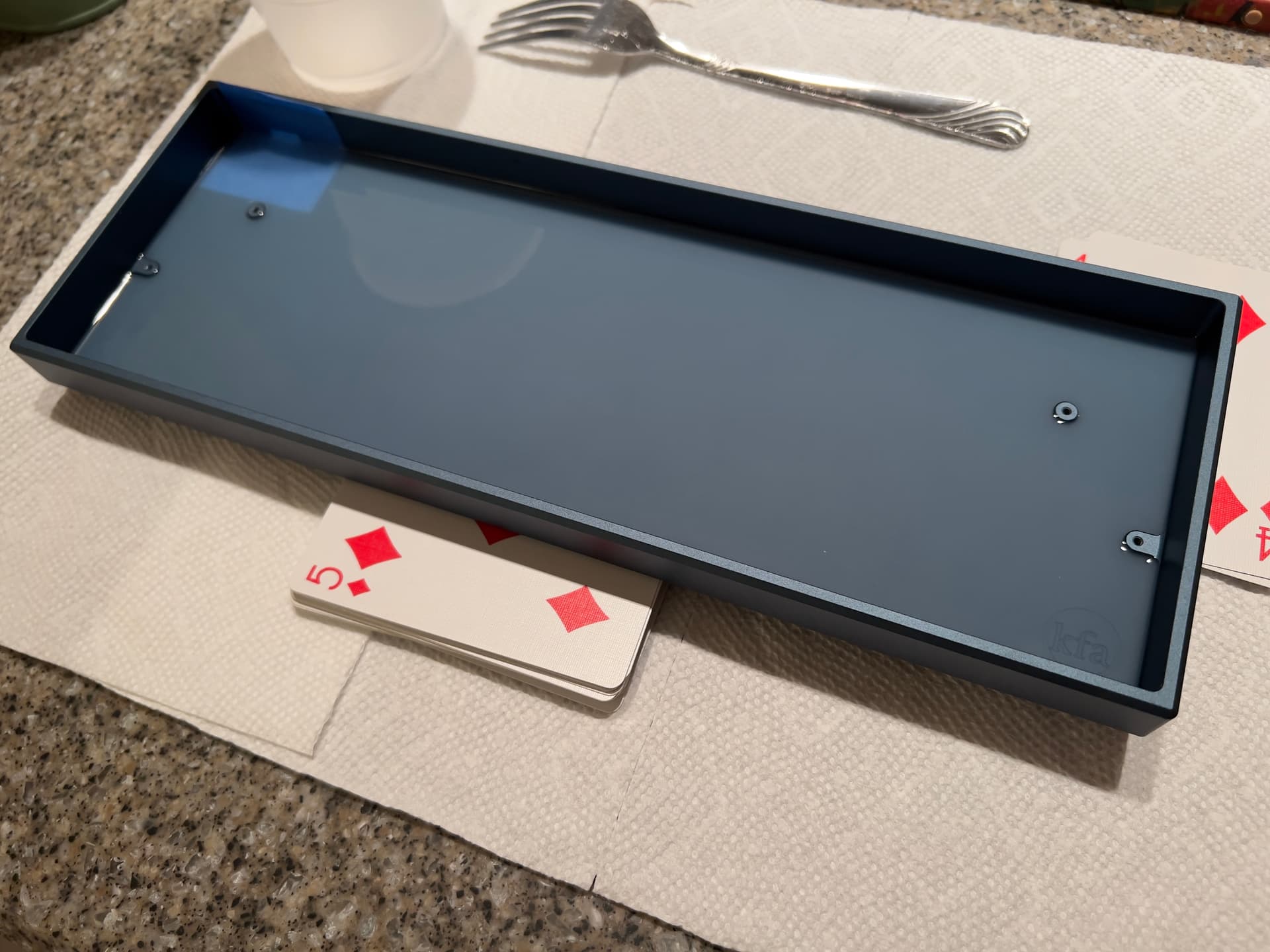

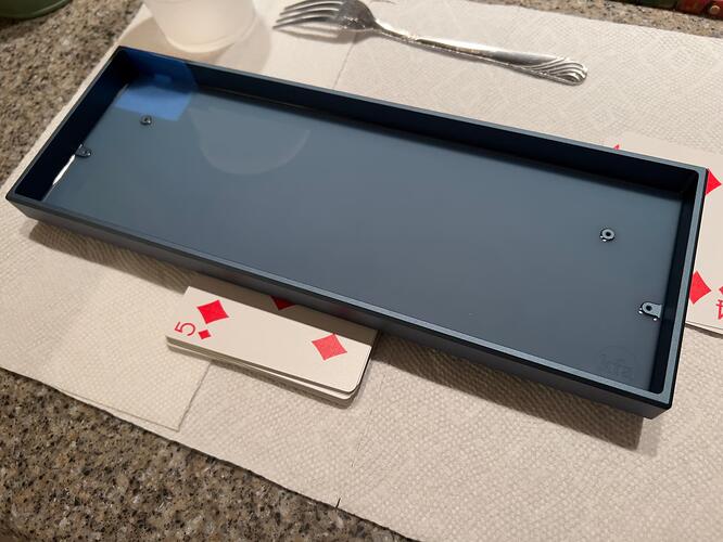

Poured a custom silicone dampener for my Freebird 60 case tonight. Needed exactly 70g of silicone to fill the case bottom up to the top of the mounting posts. The trickiest part of this is always to get the case level, because nothing–and I do mean nothing–in our 95-year-old house is level (nor plumb, nor square).
The case came with a decent but thin silicone dampener sheet that didn’t quite fill the entire bottom of the case, so there was still some annoying case ping even with O-rings on the case PCB screws.
I’ll need to wait until tomorrow to see if it solves the problem, but I have high hopes.
Update: mission was a success! I was eager to get the board back together for testing so I neglected to take a photo, but the new silicone dampener is more than double the thickness of the one that came with the case and is a very snug fit with the PCB.
The board sounds like a much denser/heavier/more expensive case now with no case ping. This is probably my favorite mod. It’s fun to do, very cheap, and elevates even the cheapest boards.
The only downside with this mod is that in order to get it to work well, the silicone needs to be in firm contact with the PCB, so if you’re a fan of a bouncy typing feel, this mod is definitely not one you’d enjoy.

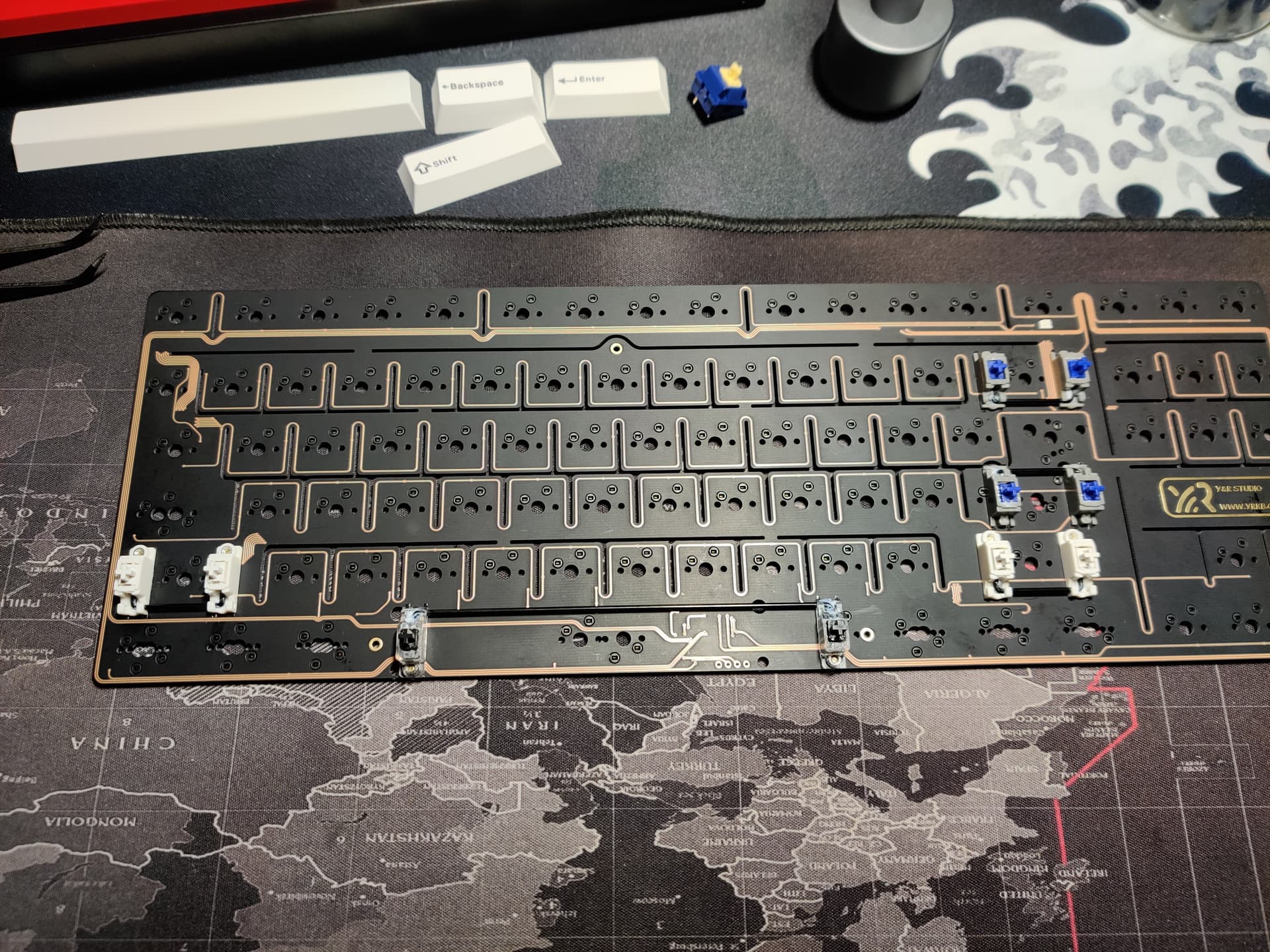

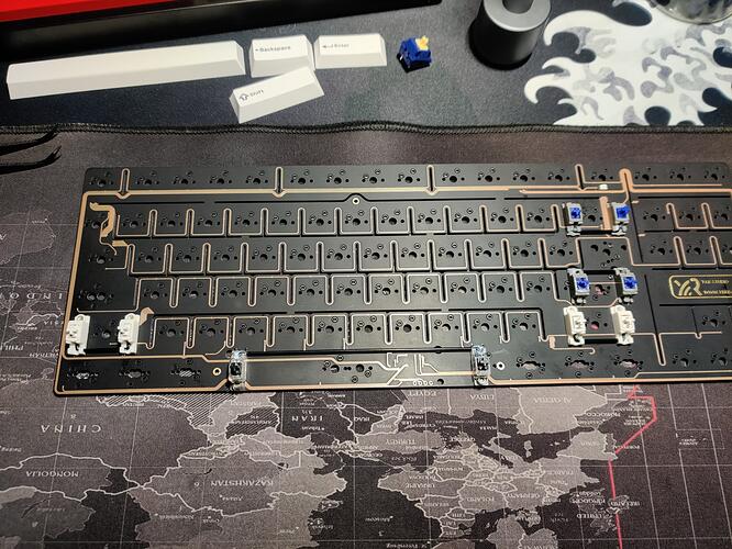

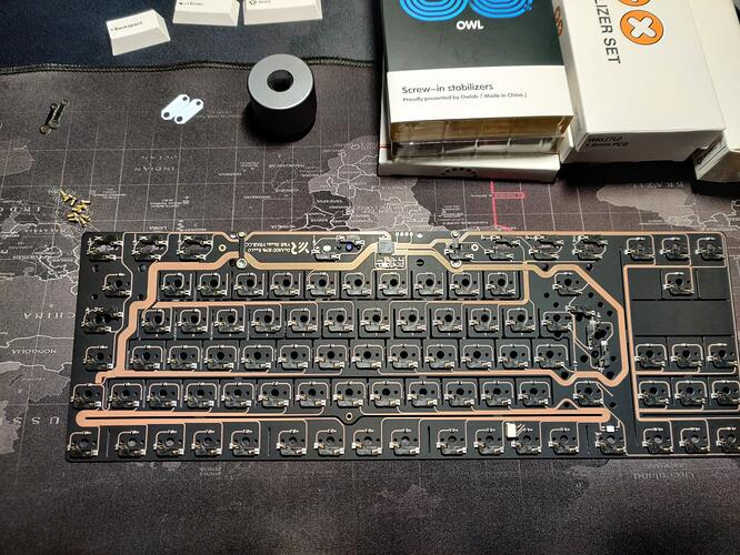

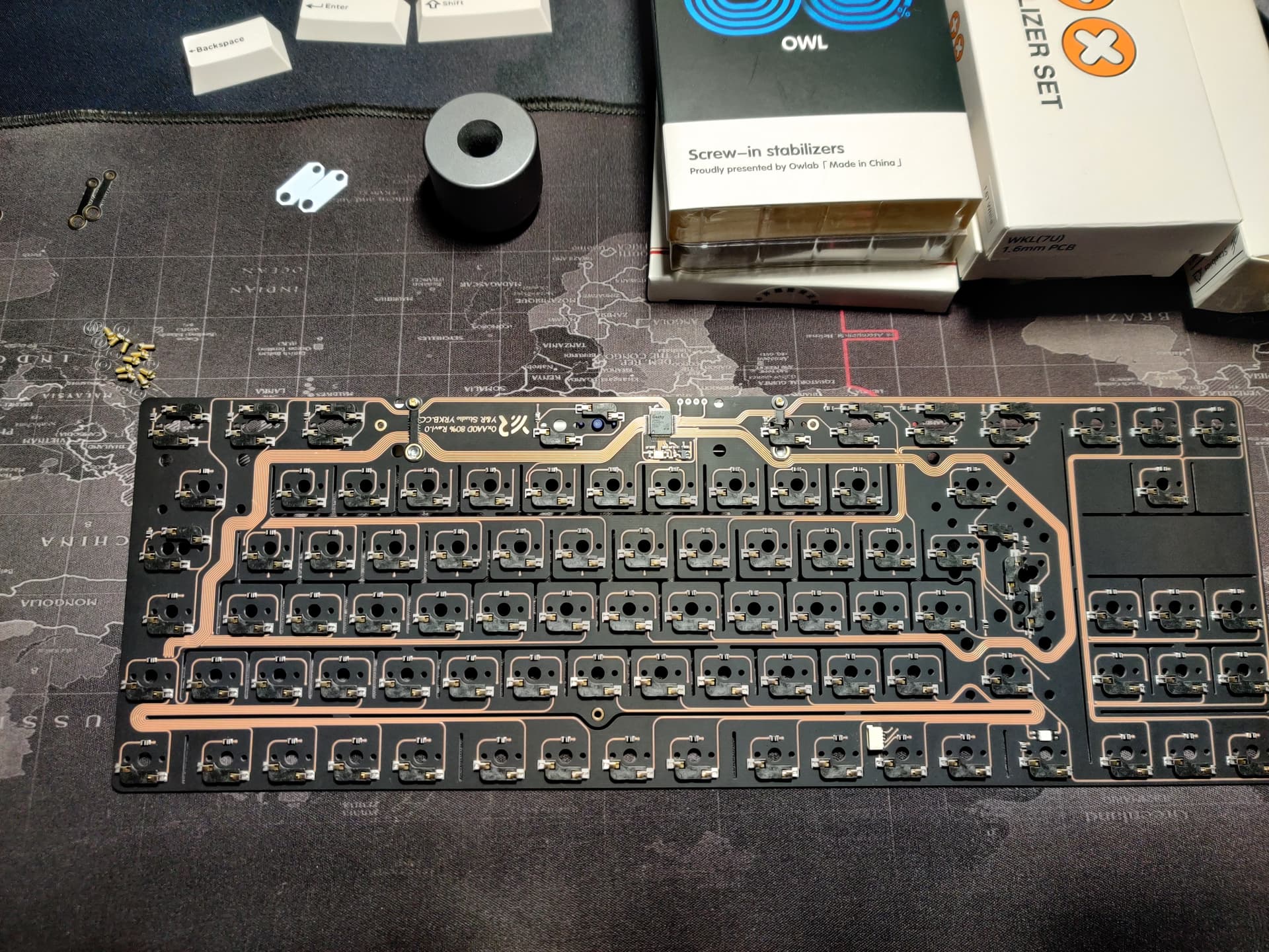

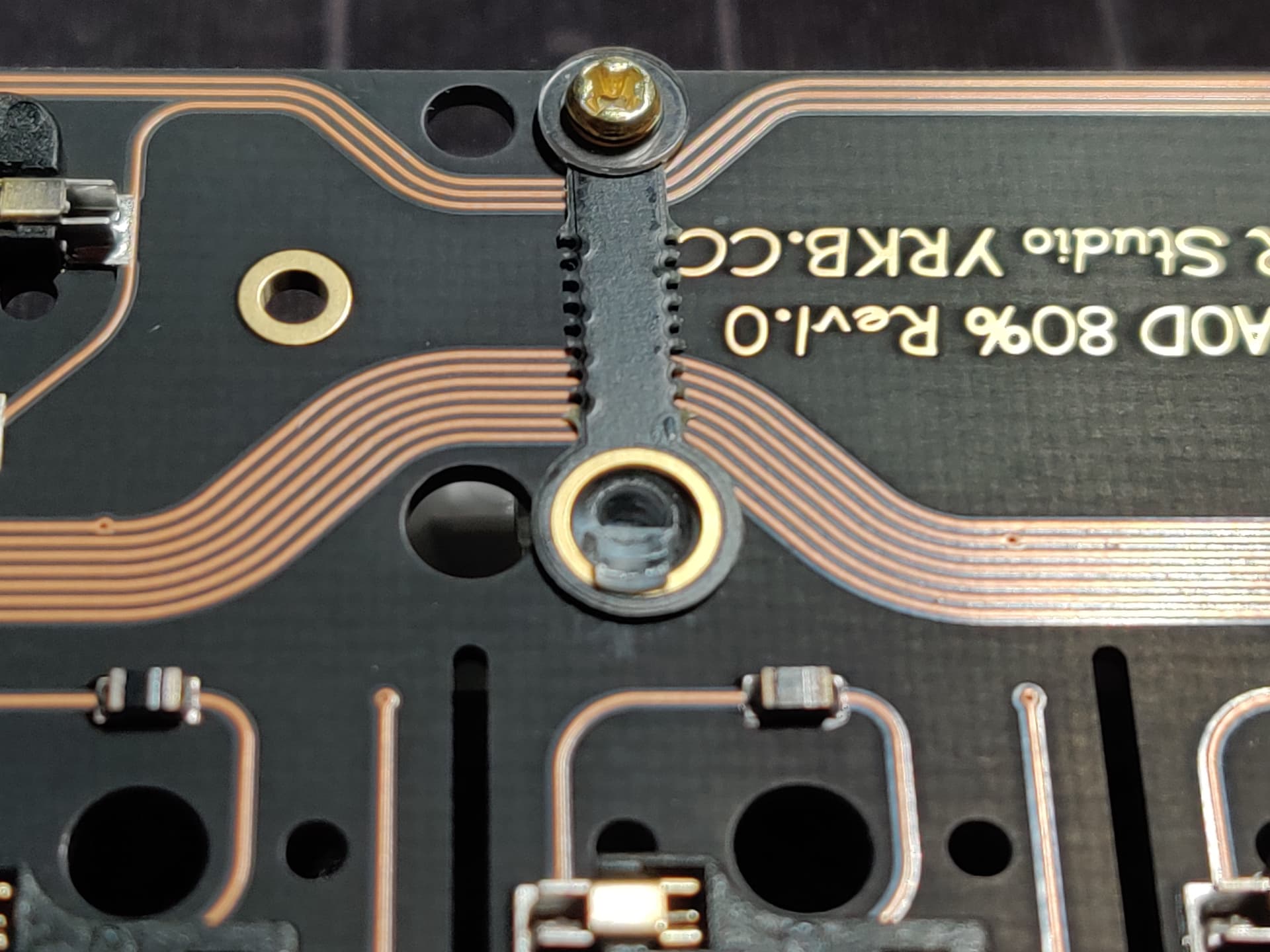

Y&R80 80% Layout Hot Swap Keyboard PCB
Under the spoiler photos of the board

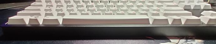

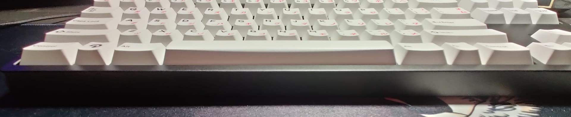

Summary

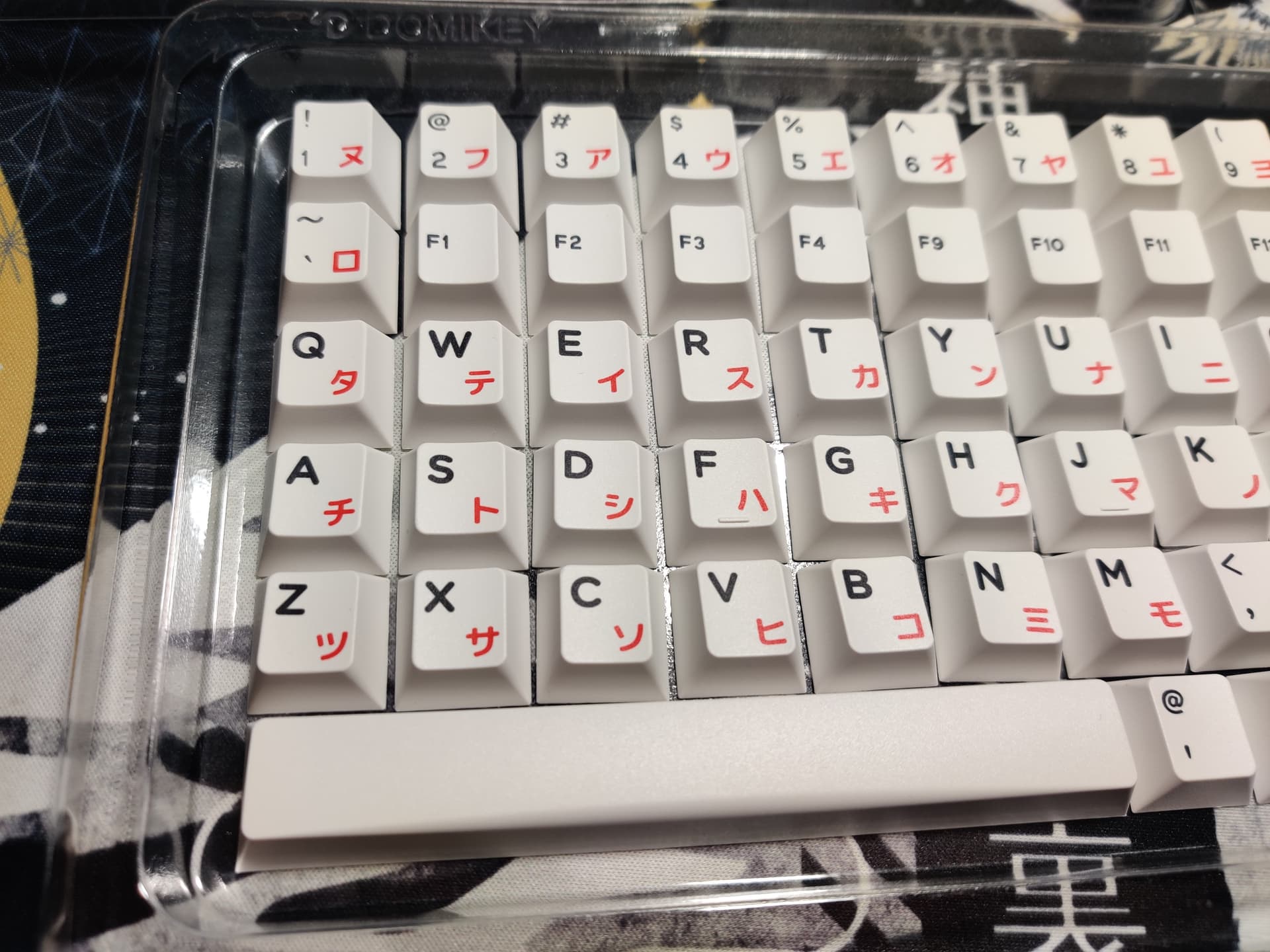

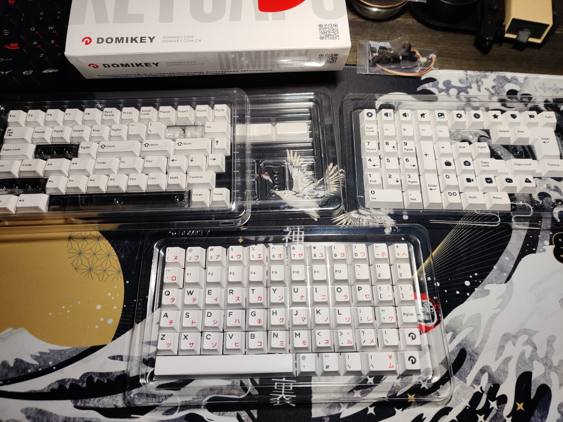

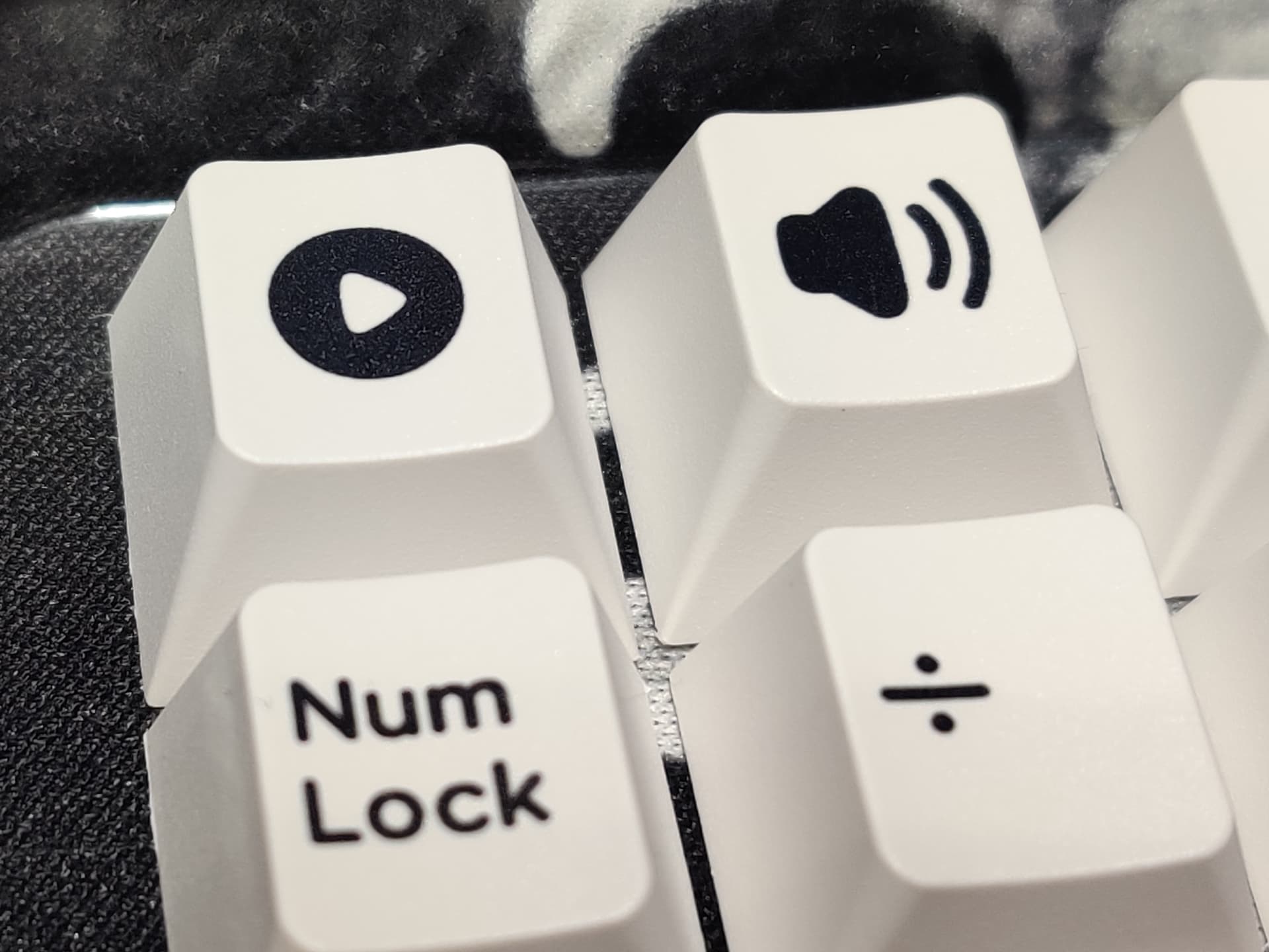

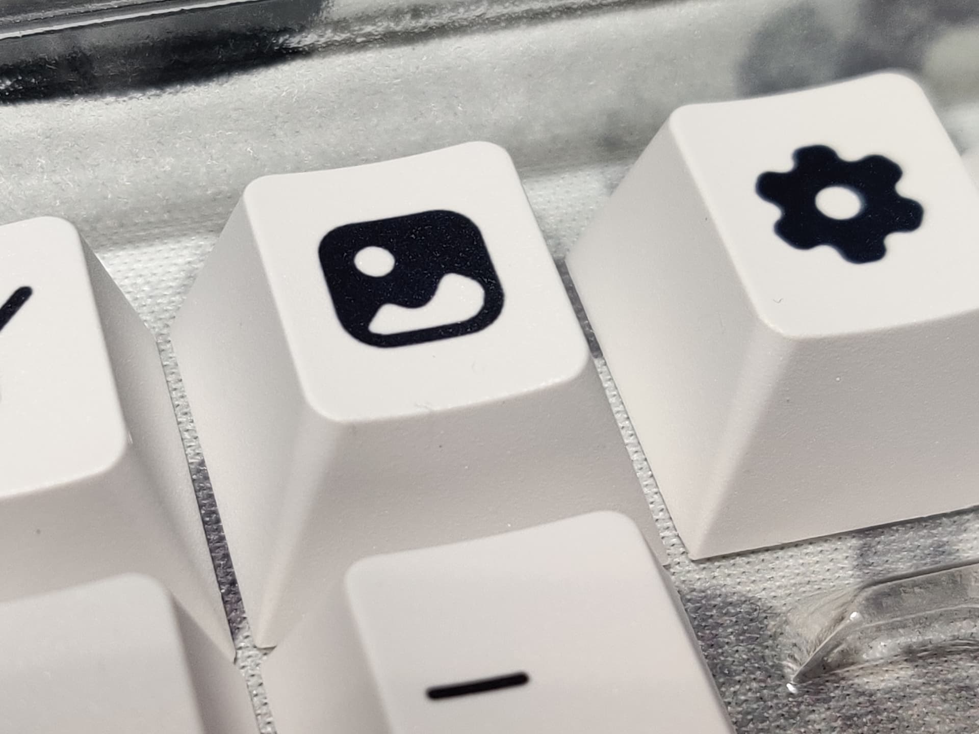

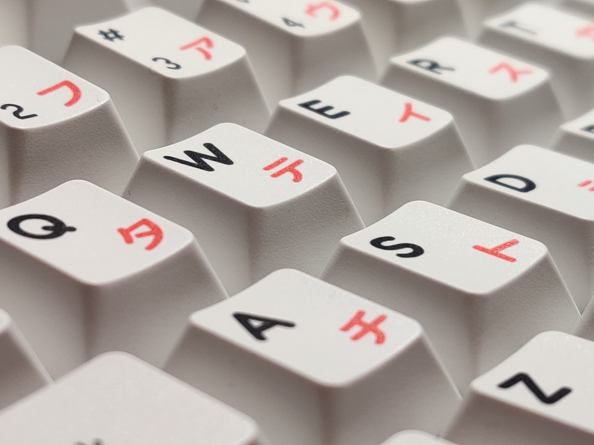

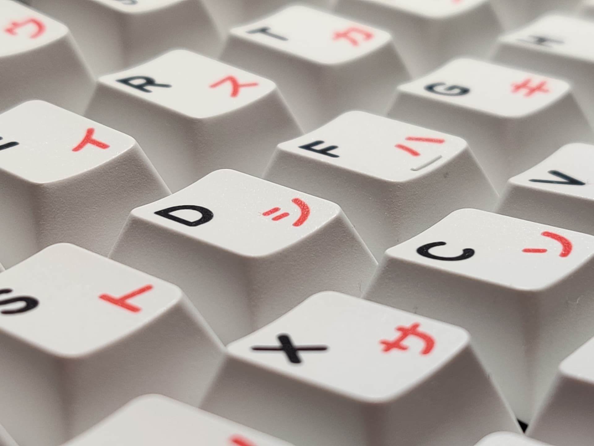

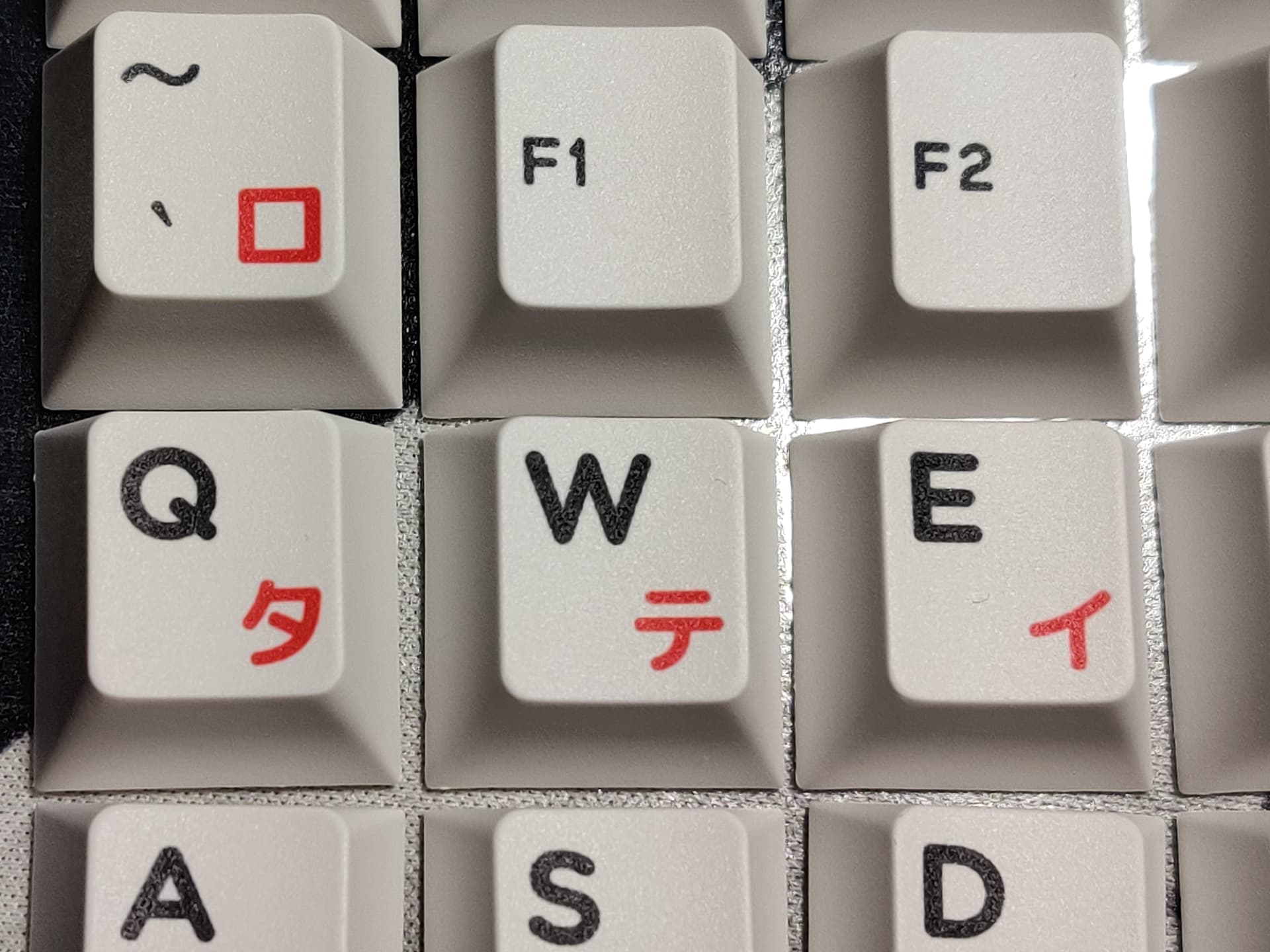

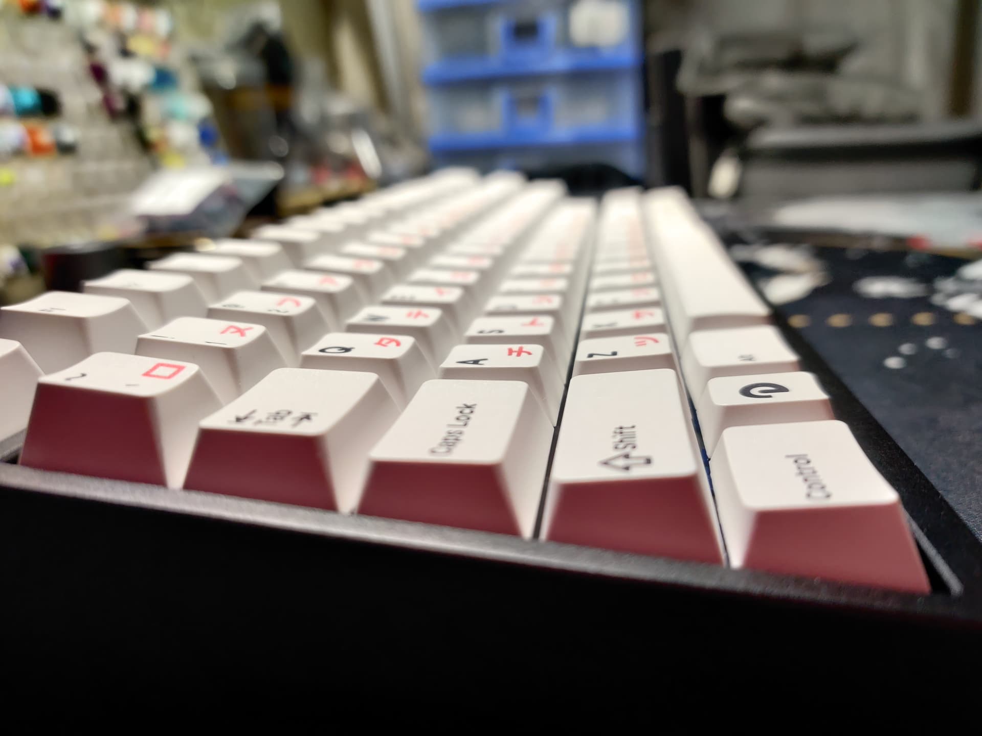

Domikey BOW Dye-Sub Cherry Profile Keycaps Set

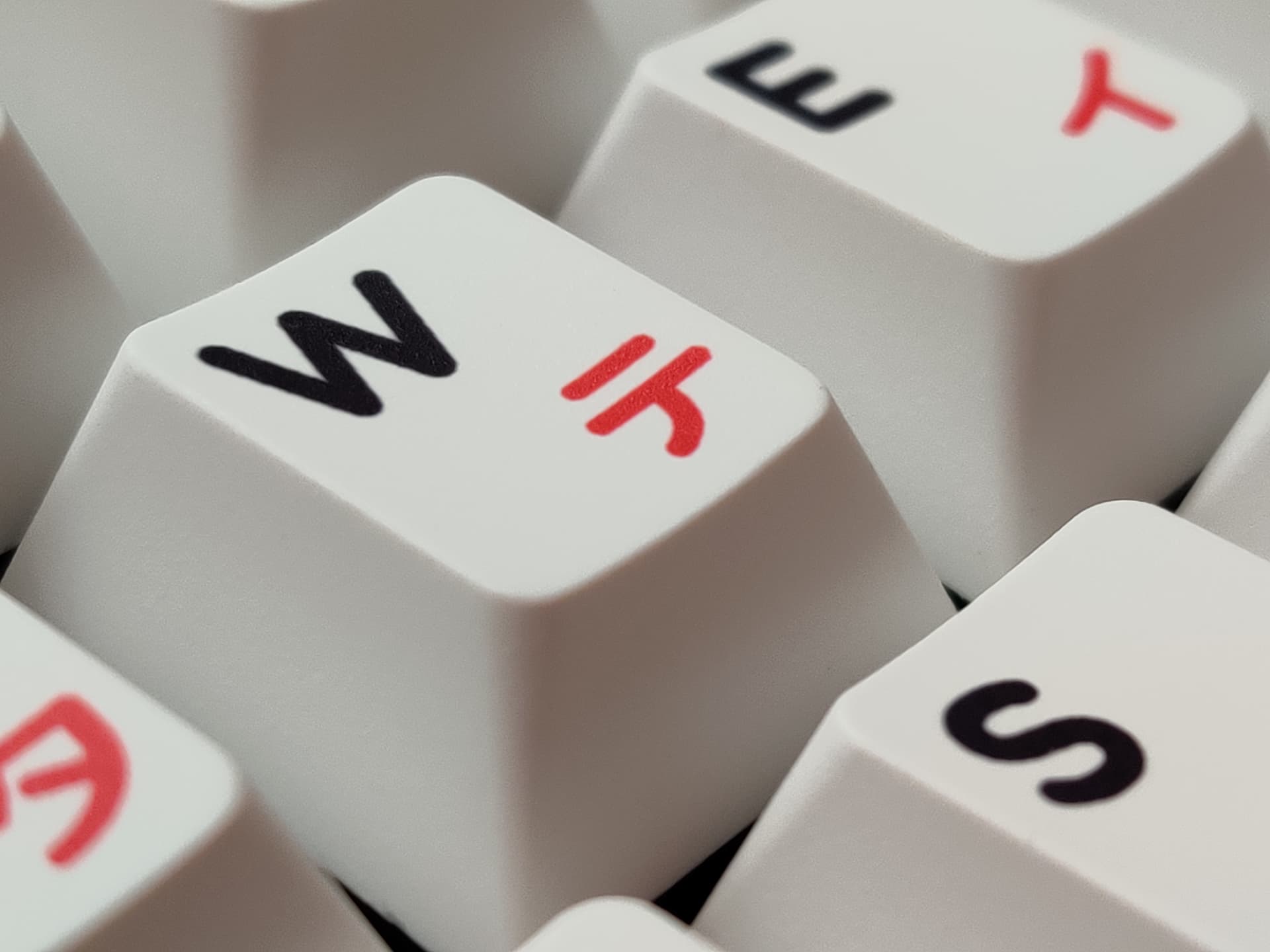

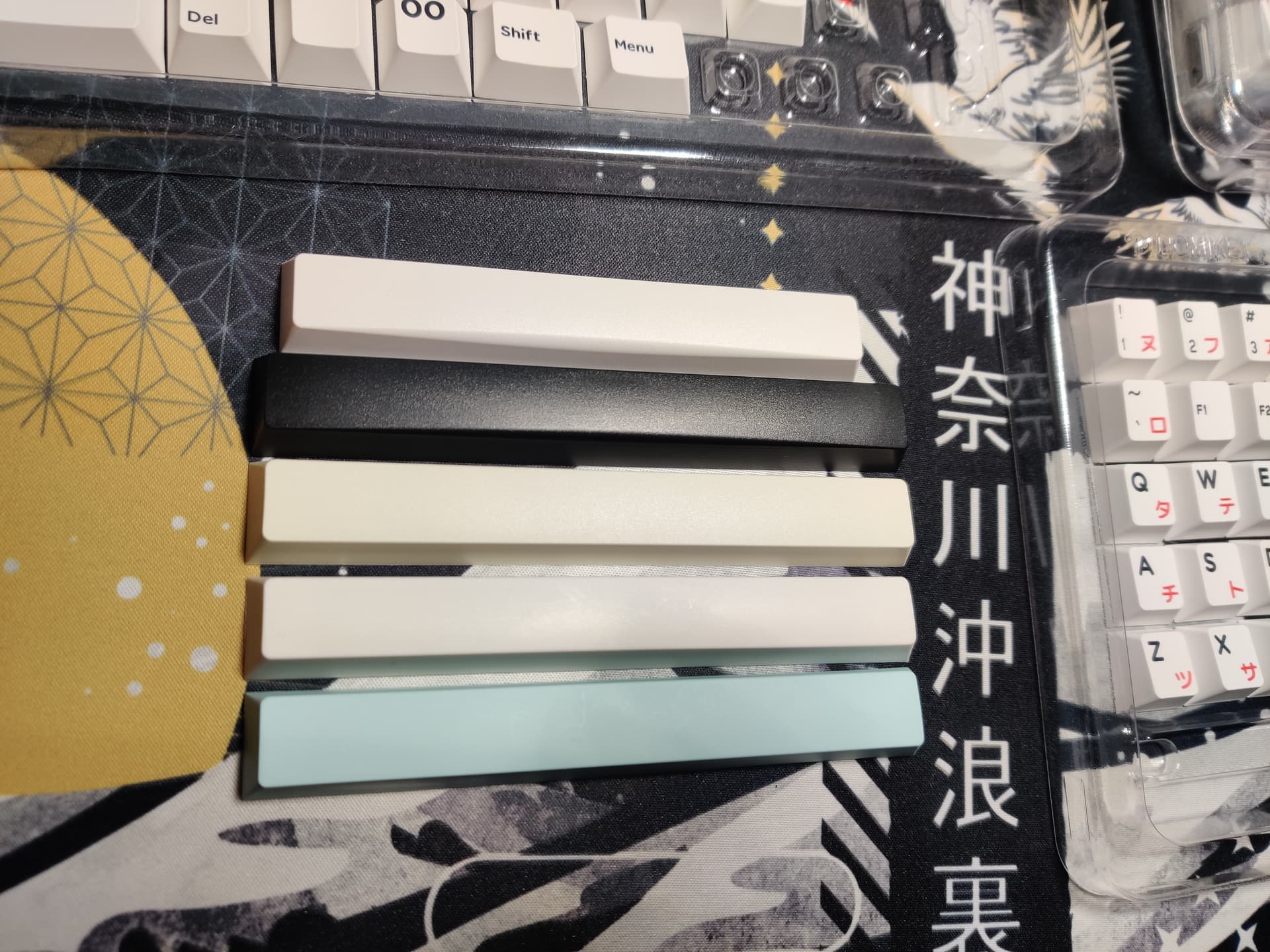

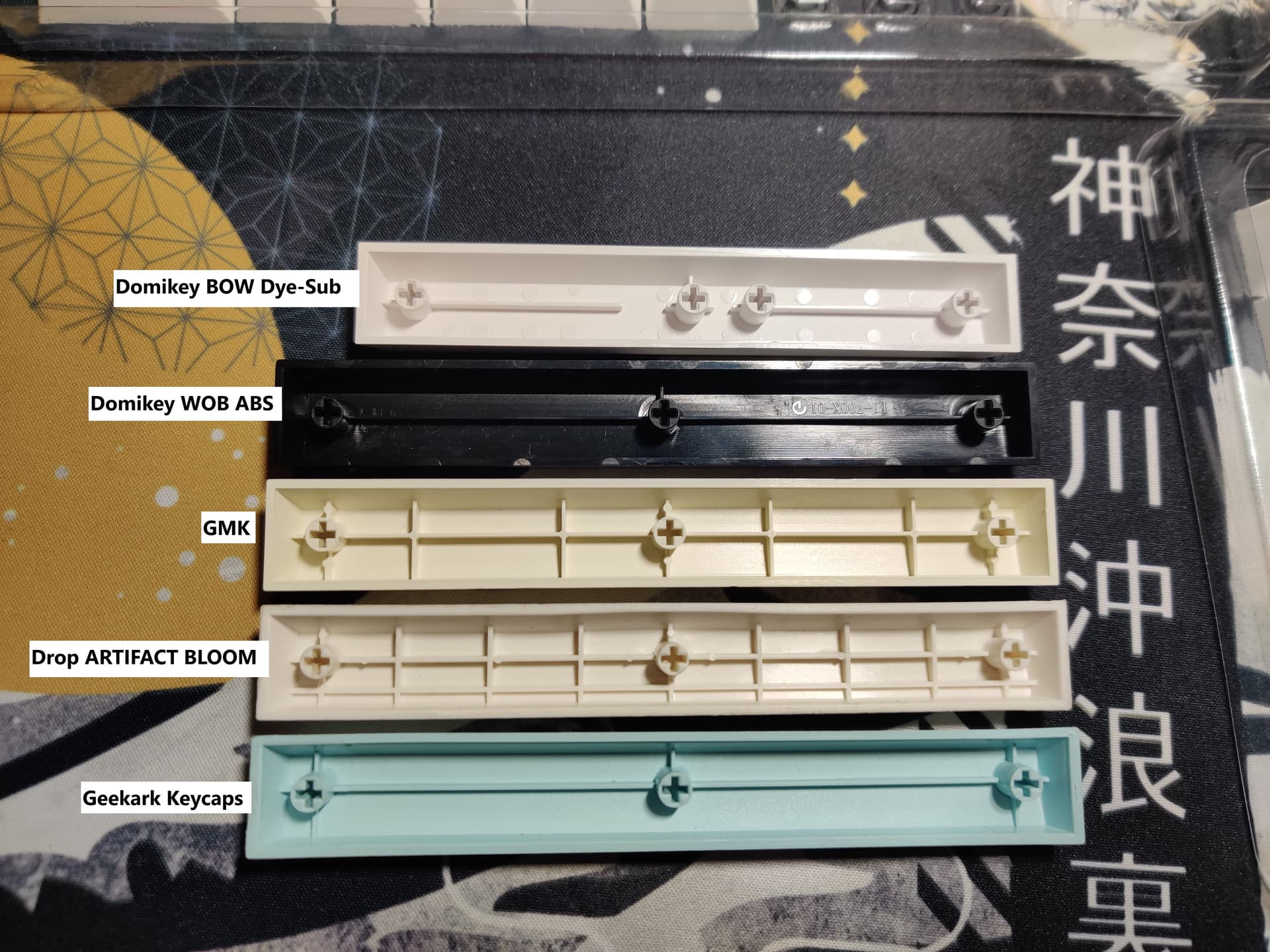

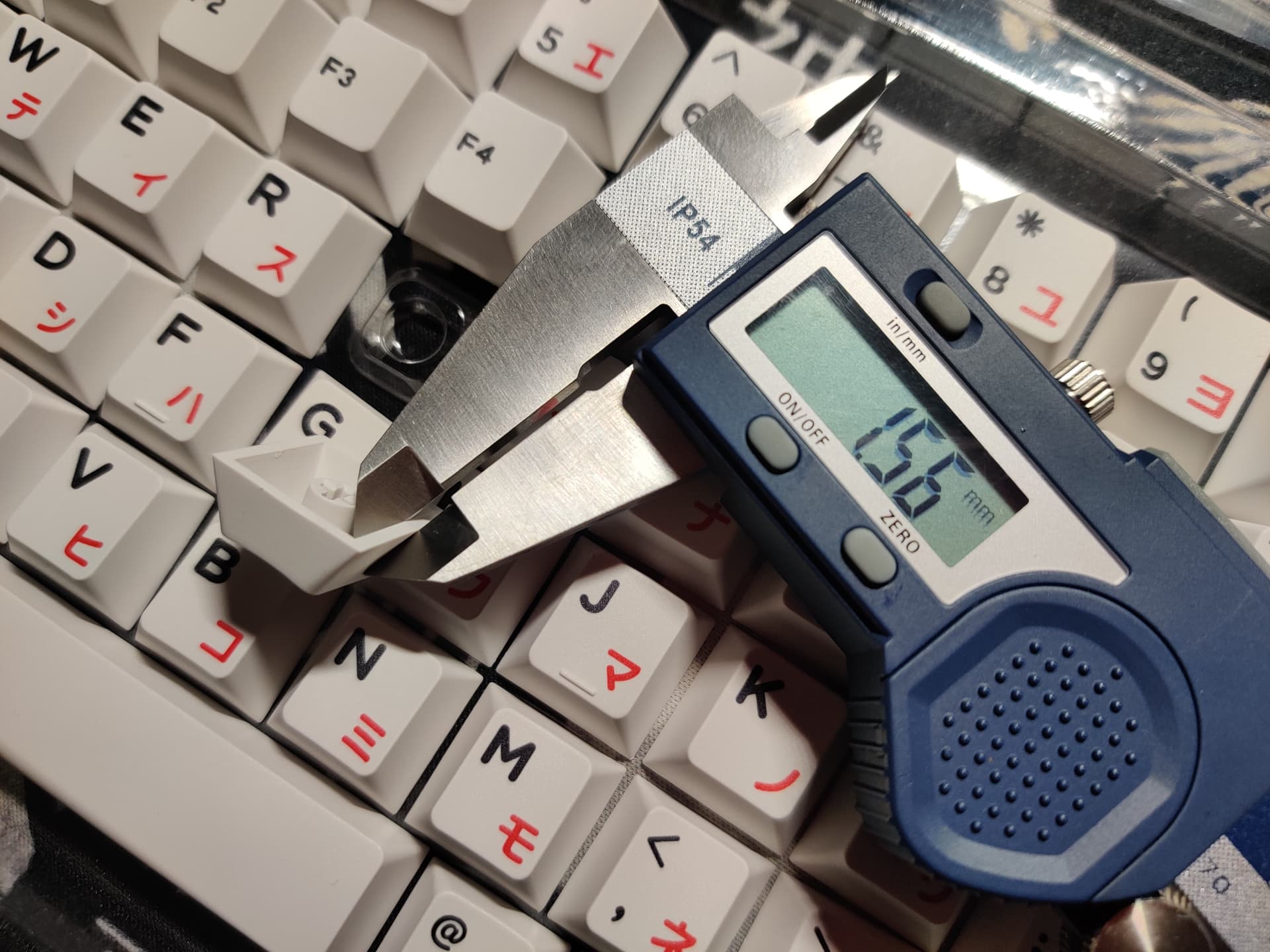

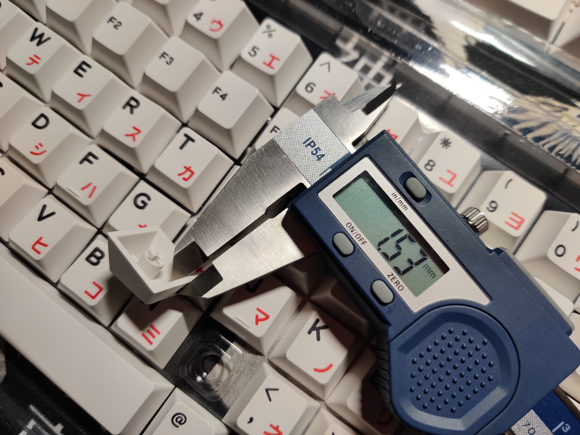

Very, very many photos close up and measurements of the thickness under the spoiler.
Summary
Video of measuring the thickness of the keycap gap.

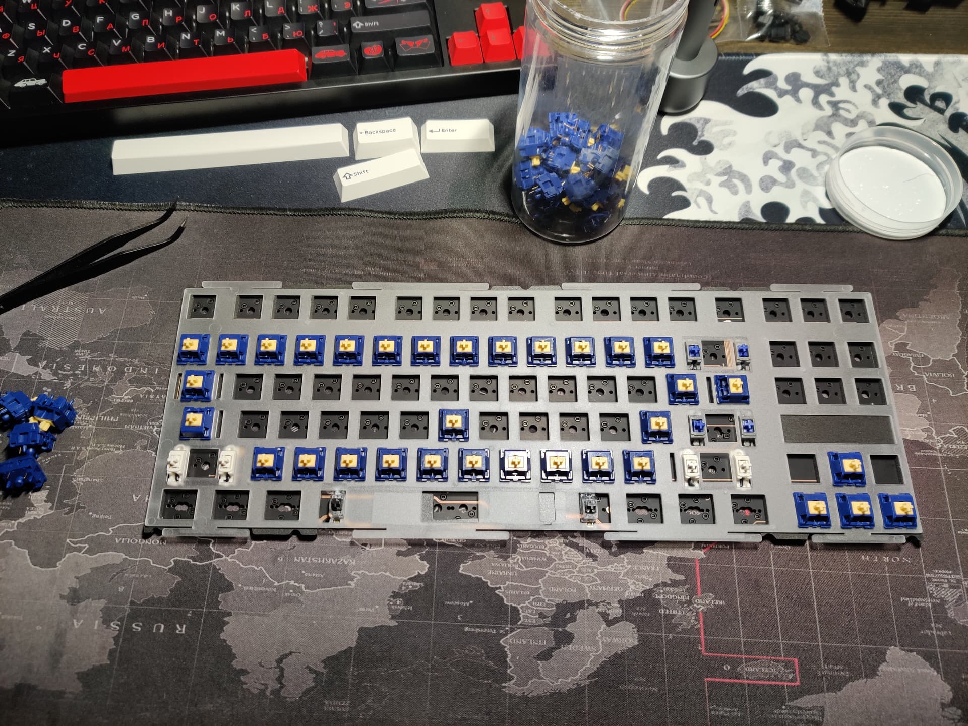

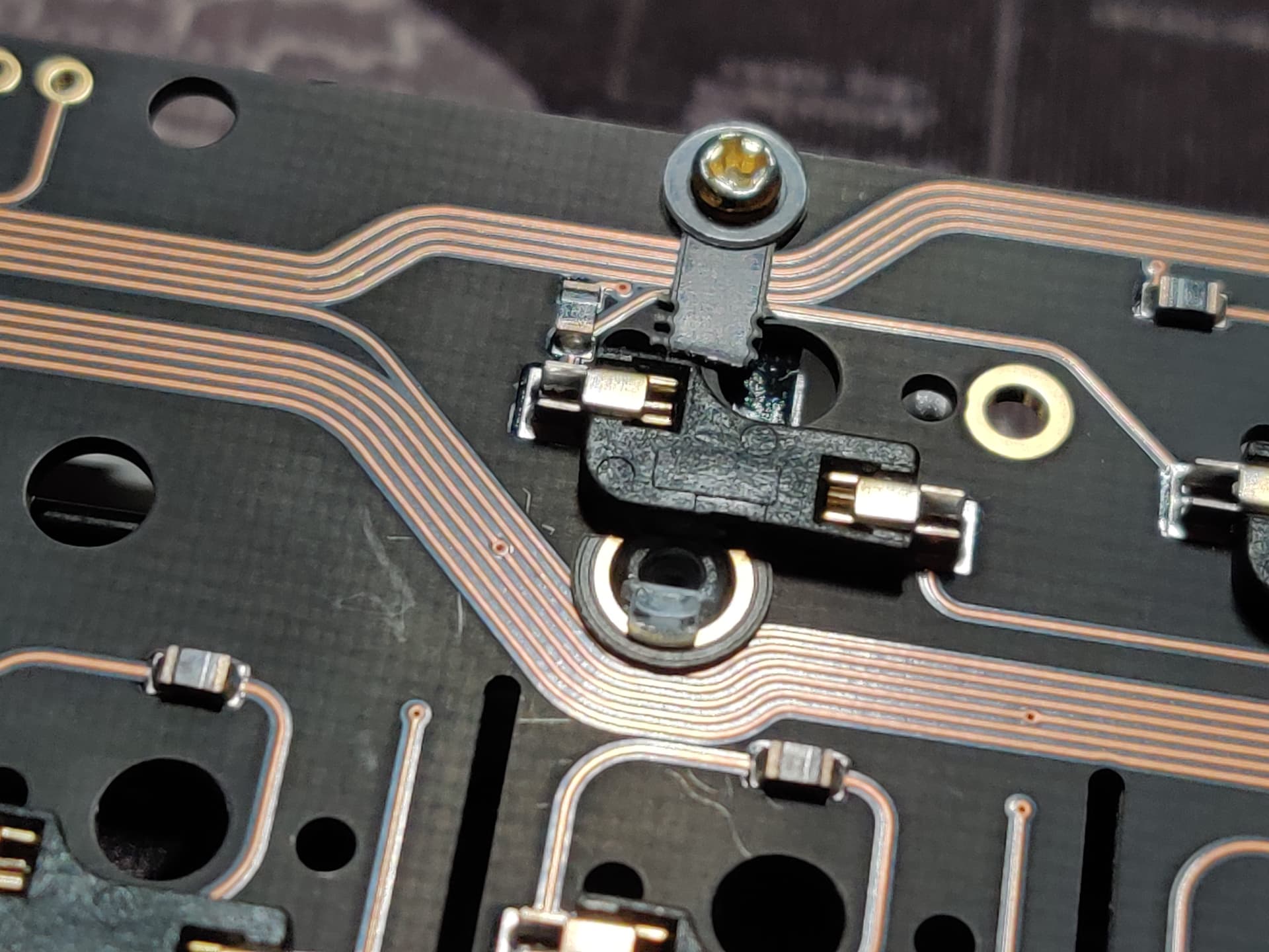

I would be terrified to change out switches in this board without taking it apart! I’m assuming all of those cuts on the PCB not only change the feel but also the sound of the board. What is your opinion of the product?

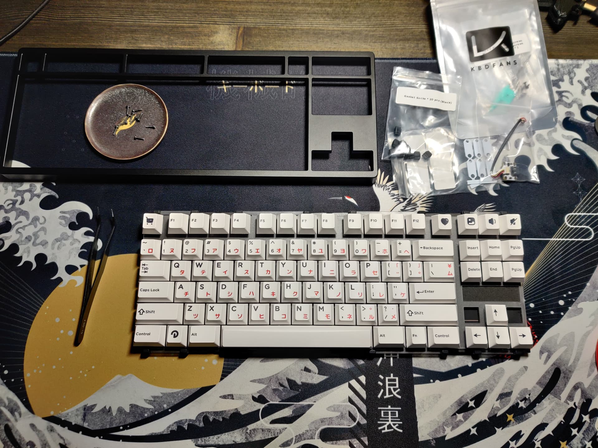

Tonight I did a test build to see if I wanted to change the springs or not. Also had to make up my mind for the stabs. I thought it would be a better color match before I put them next to each other but it’s good enough. :yum:

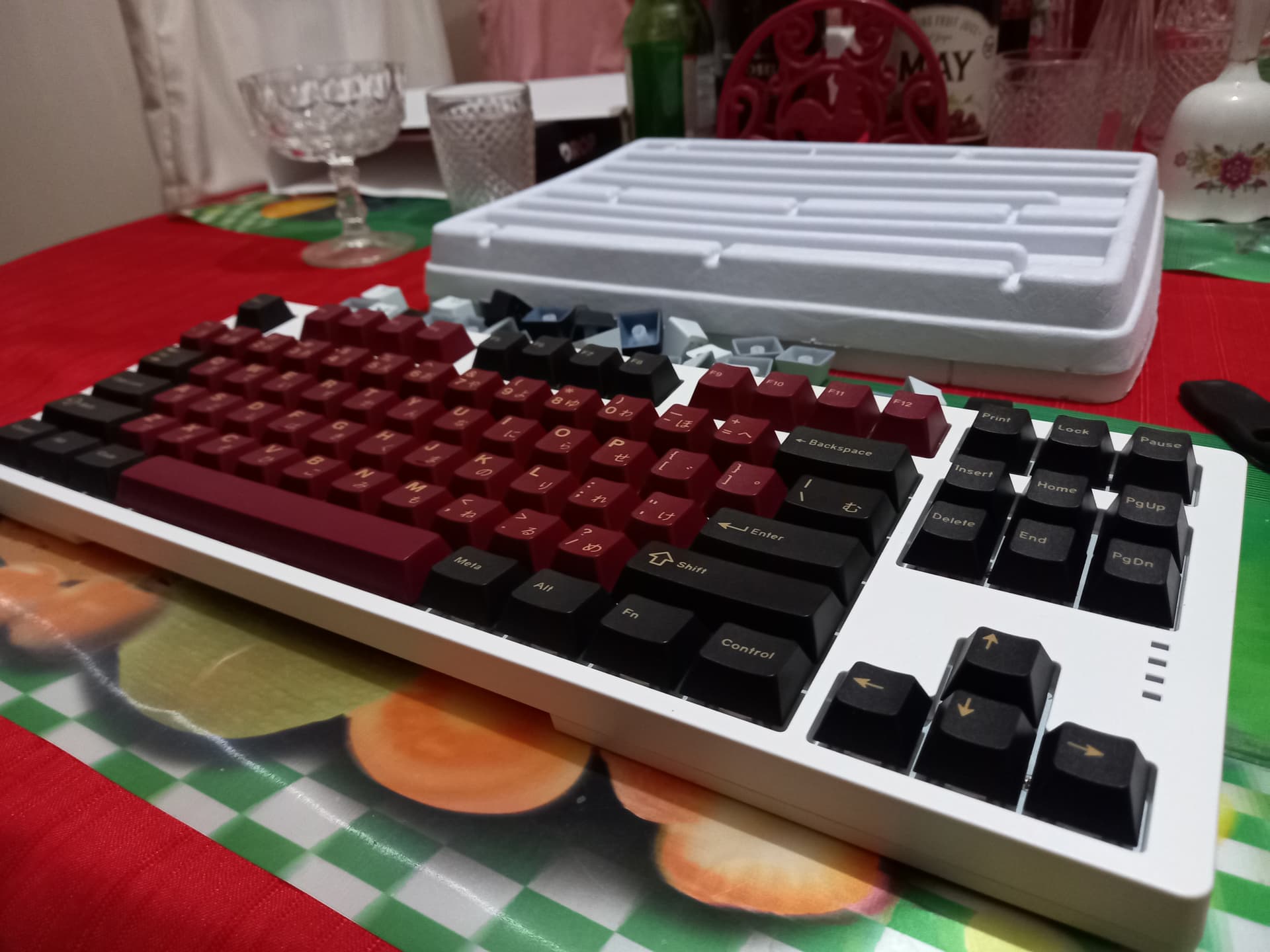

Again, not my “work bench” :smile:…but switched out the stock keycaps on my Loga Yaksa Pro: Printstream Editor TKL. The keycaps of choice are GMK Red Samurai.

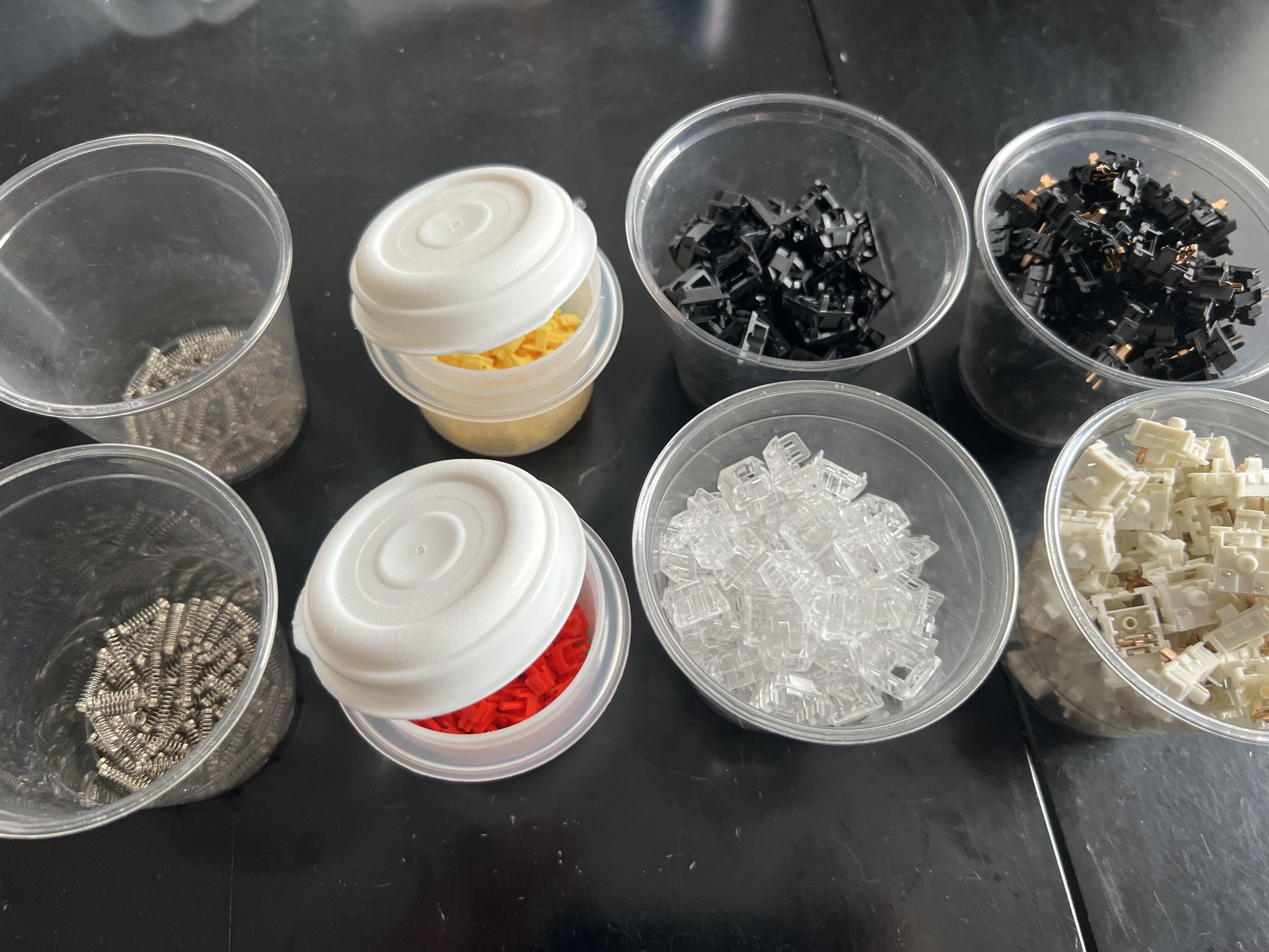

12 oz - I get them here.
I’ve found the 12 oz mason jar size will reliably hold about 90 switches, with some brands having a little room at the top and some having the jar as full as it can be.
For a full set of 110, 16 oz is probably the move, though depending on the brand you might be able to get them all into a 14 oz if you settle the switches by shaking the jar a bit - though I do think 104 would reliably fit in the 14 oz jars regardless of brand.
I change to hot swap only on Keychron.
And on other keyboards (QK65 and tiger80) always only when completely disassembled.
Only this is not because the switches, but because the stabilizers.
If you often change keycaps, and I often change keycaps on the same keyboard. That stabilizer starts to fight. A little bit but the wire bends or something. Therefore, in order to pull it out as carefully as possible, I disassemble))
On the board itself, I’ve only noticed two things so far.
First, it is much more flex. And the corner places along the edges are more stable than those of the native. At the default Tiger80 board, the edges bend very strongly, it is problematic to insert or remove switches. It’s possible, but problematic.
The second is some layouts. Like mine with a 7th space. Makes some places with north diode switch location. And I got an interference effect here.
It is especially sad that this effect on keycap enter.((((((((((

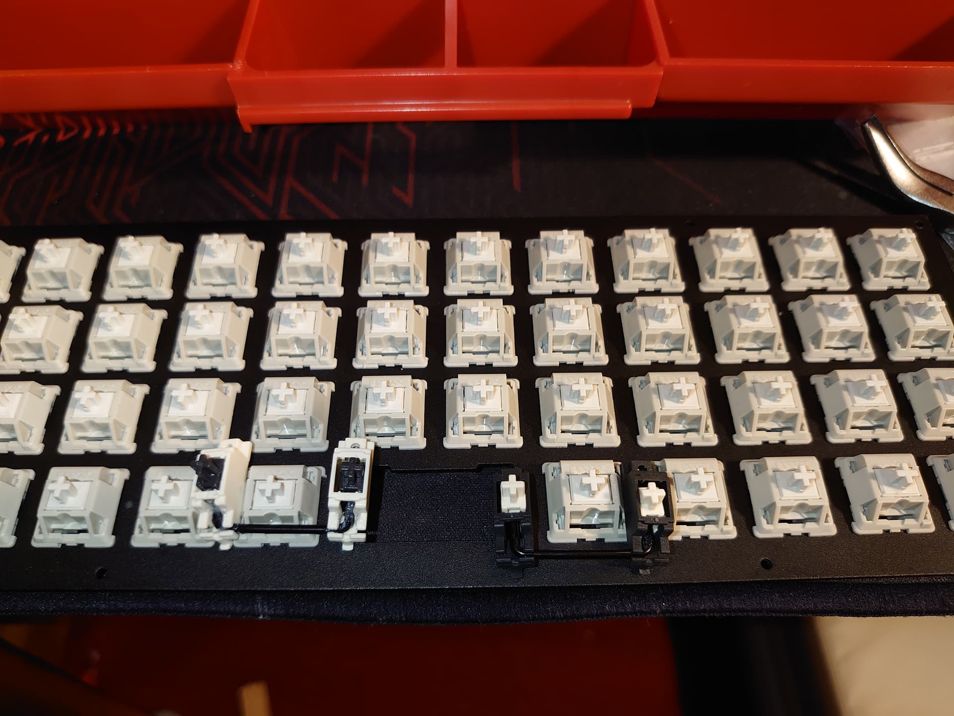

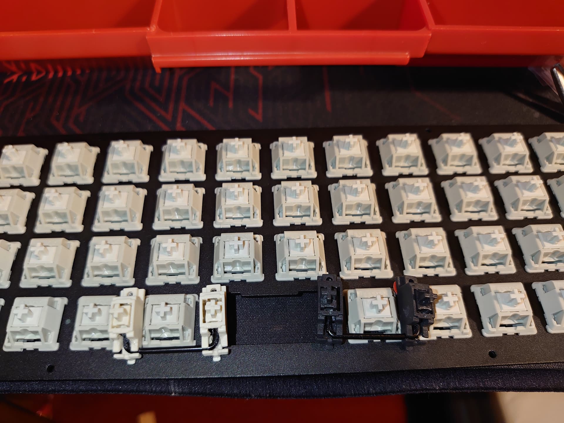

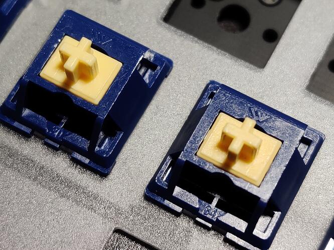

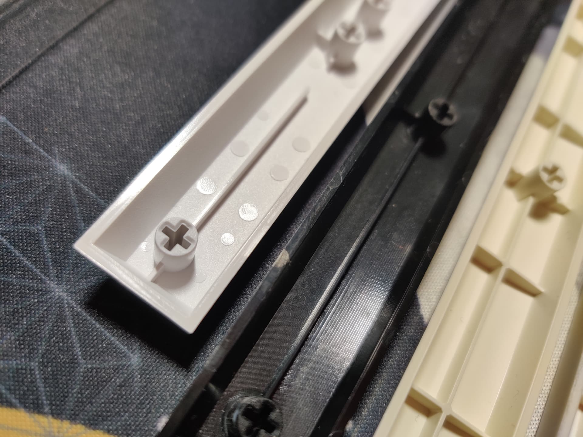

The Aerospace Heavy Grail is here! Sadly, the stabilized keys are making me scratch my head. Depending on the keycaps used and position, they can fail to return. That’s even true of the space bar if I add the stock spring under the cap. But with others, they work just fine. So to me, that rules out:
  • Slider tolerance issues
  • Stab interference on the spacebar.
  • MX stabilizer holes being too small/off center
The domes are BKE Ultralights, which worked wonderfully in a Hybrid with CRP keycaps. However, they’re one of the bad ones here along with DCX. Some ePBT sets work fine, though. Even with the CRP set, the left shift will return but the space bar and enter do not.
The only other time I’ve had this happen was on an MX board and the culprit was a warped space bar. But I know that’s not the issue here since it’s multiple keys and the CRP set worked just fine in the previous setup in the Hybrid. The only variable between those two was going from Novatouch to Des sliders.
Given that the sliders are the only variable, that seems to be the culprit but I can’t make sense as to why. I’ll probably end up having to take it back apart but I’m baffled at the moment.

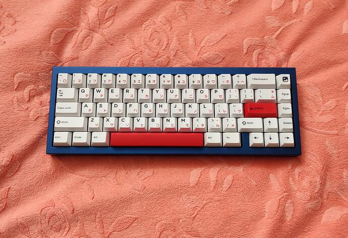

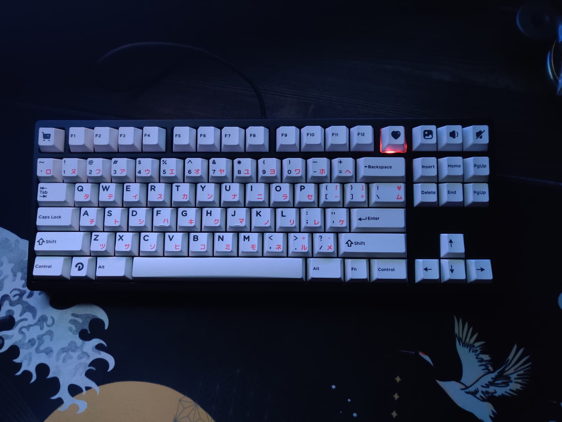

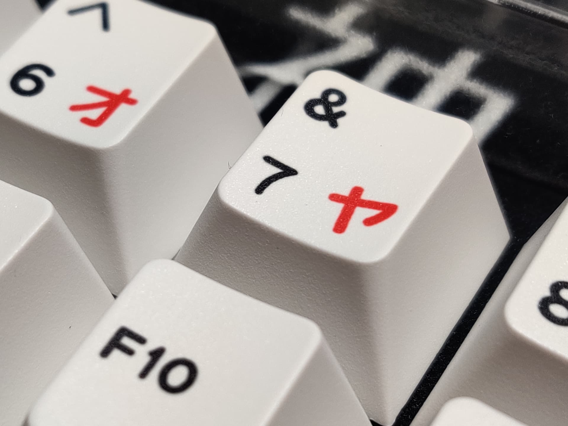

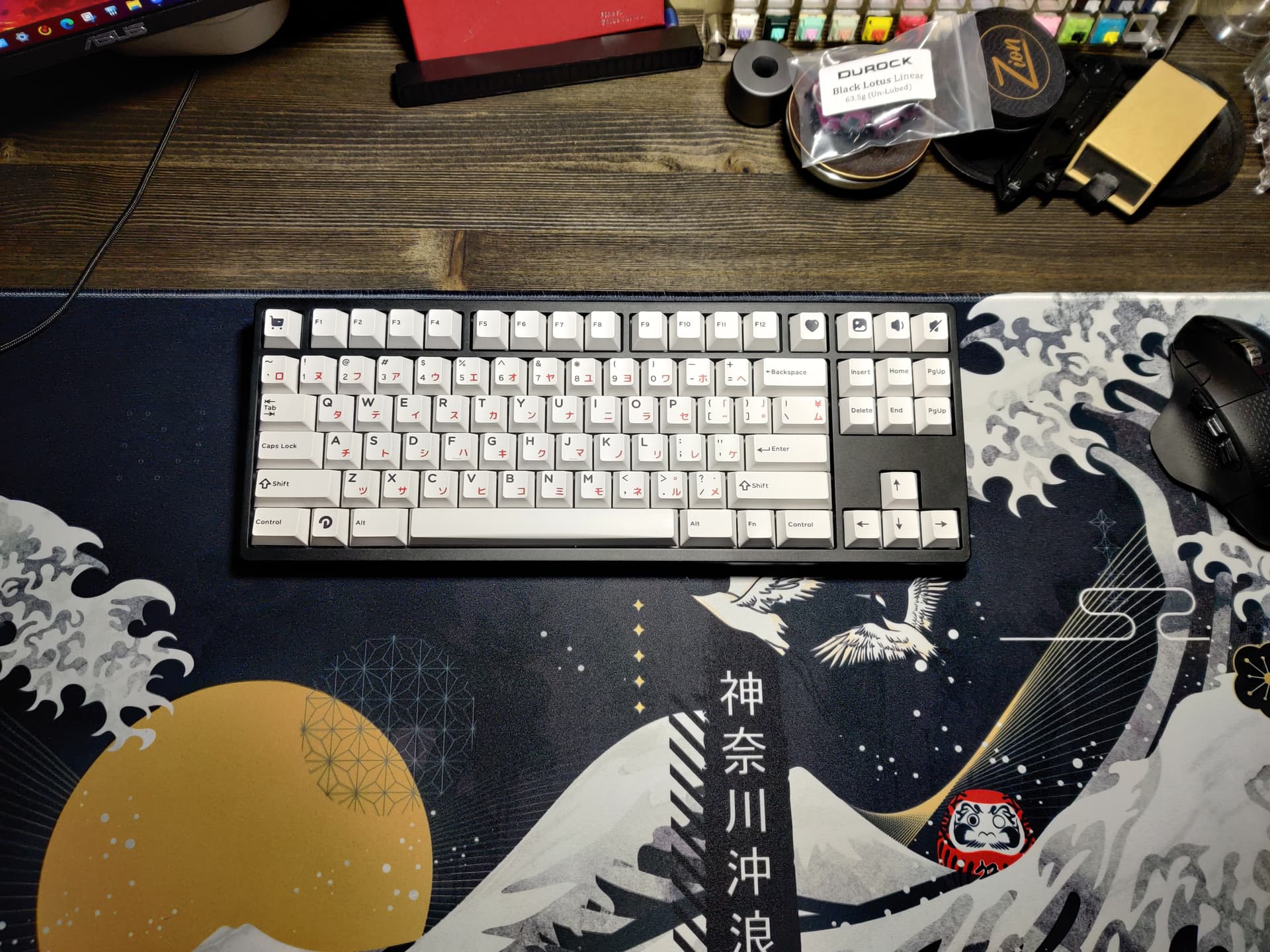

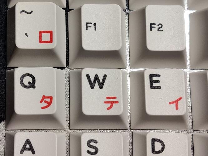

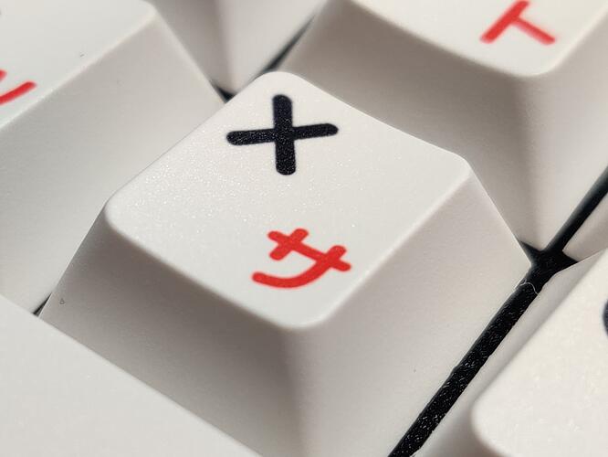

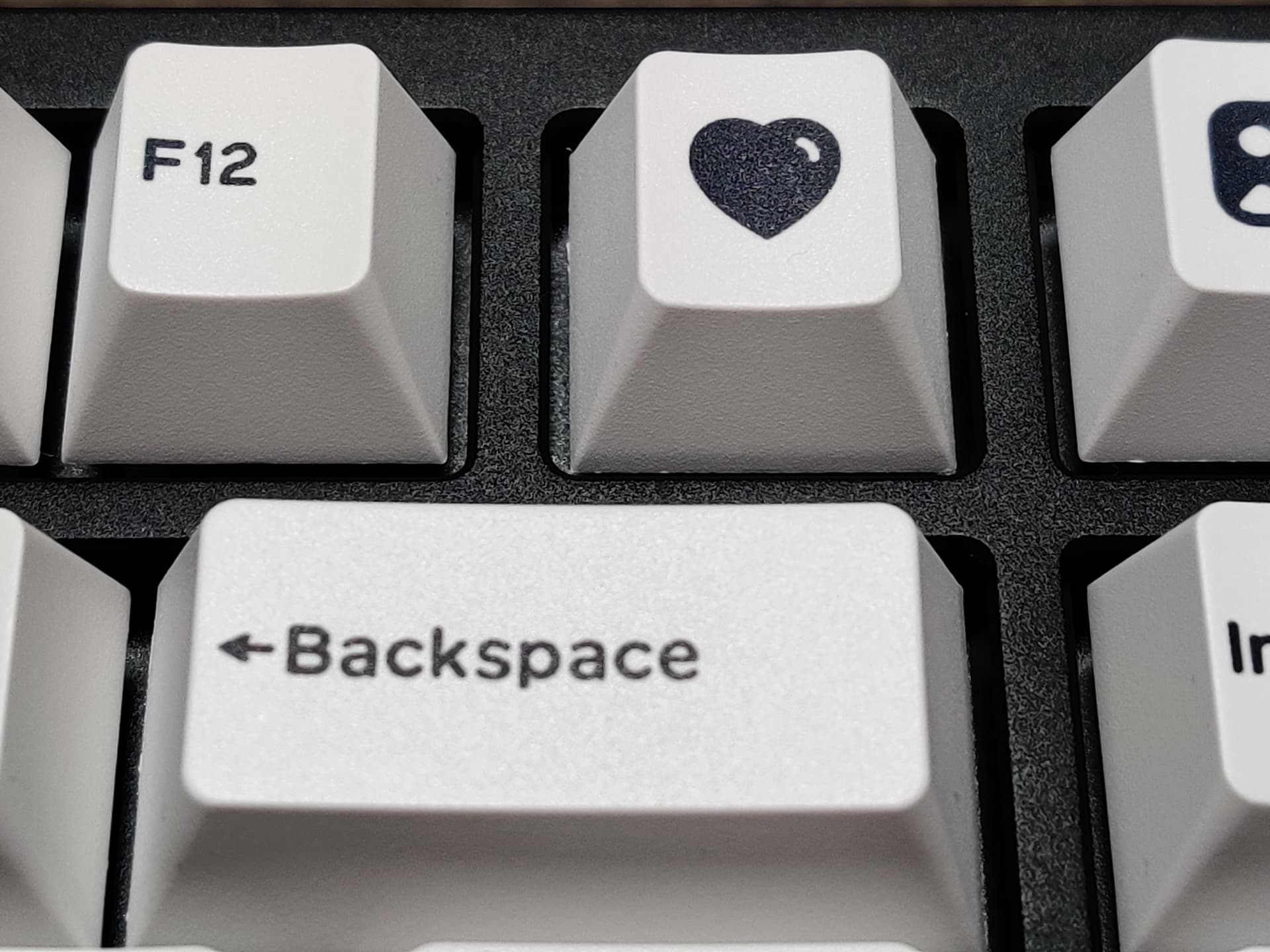

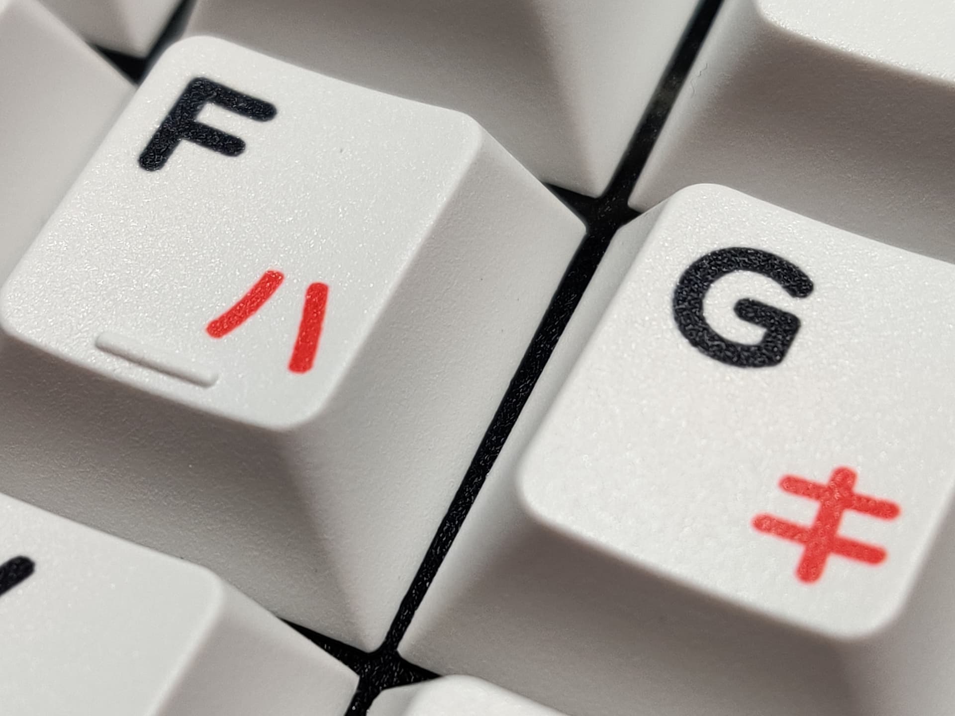

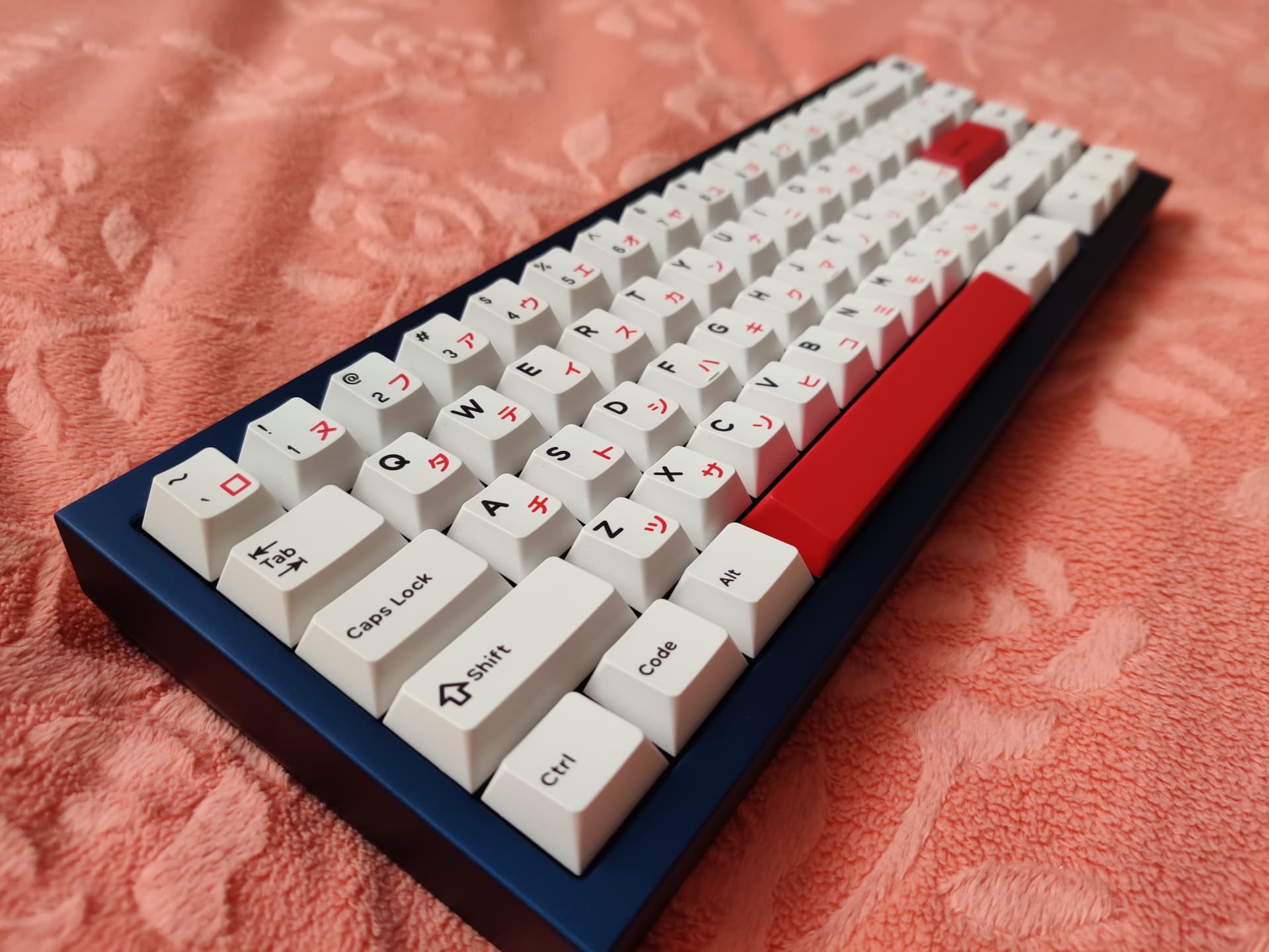

I took a photo in the natural light of the sun, the winter sun))
Domikey BOW
But I took the space and enter from the epbt SAV81 set

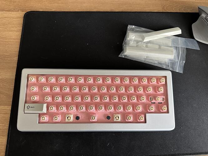

This is one of those things I’ve been thinking of doing and putting off for 7 years now, maybe 8.
I finally built a board in my blue TEX case. I got it about 8 years ago. I had a zeal60 rev2 PCB for it, but I just never felt like putting in the time.
Spent so many years trying to find the right plate, switch, keycap combo that I just gave up.
Well, today I milmaxed the zeal60 PCB!
These old TEX cases have ridges that run across the PCB. So not only is it tray mount, but even firmer than most tray mounts. Also rules out mounting a hotswap PCB in it due to case/socket collision. Hence the milmax board.
The good thing is that the supports give the board very even acoustics.
I found a decent solution for dampening with foam strips and vinyl tape.
Using a 4mm brass plate gives it heft.
Now I just need to get clear caps to show off those LED diffusers. It looks so hot with the LEDs on :heart_eyes:

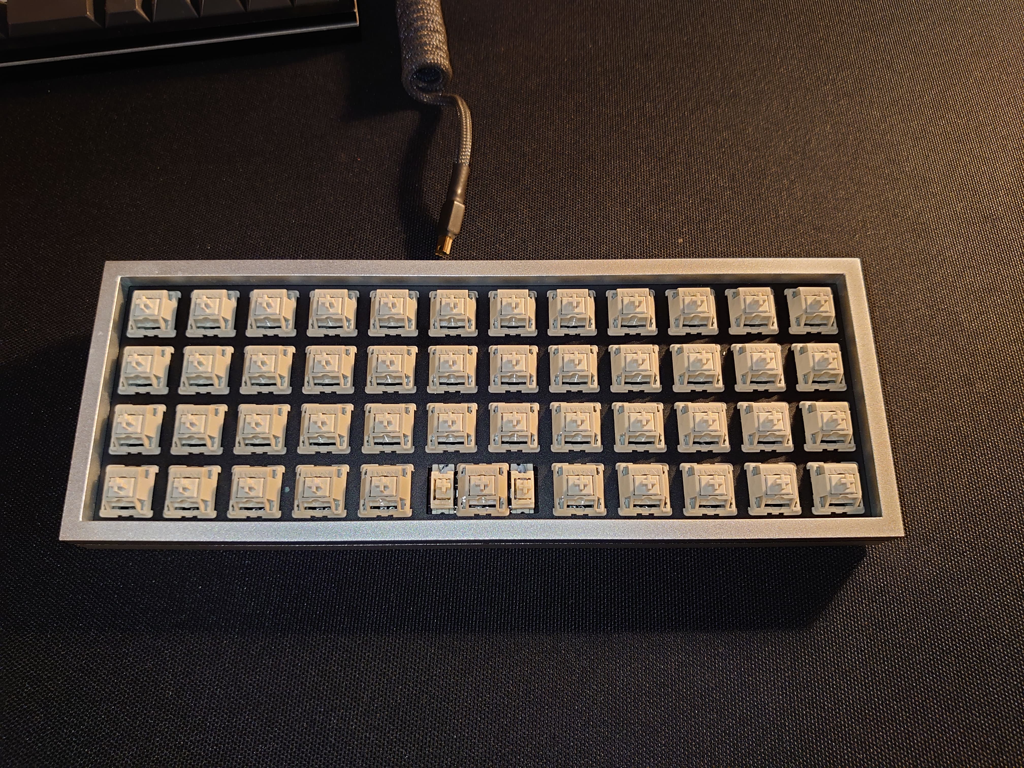

Was building my Class80 but took a break to do some lubing and stem swapping.
Going to tub lube and stem swap Kailh red and Gateron silent yellow. I dislike both of these switches. But the red stem in the Gateron housing is really nice. More stable and clack is nice from the longer stem. Not sure about the silent yellow in the Kailh housing. Initial impression is a bit of wobble but otherwise superb. I’ll report back if they’re worth it.
