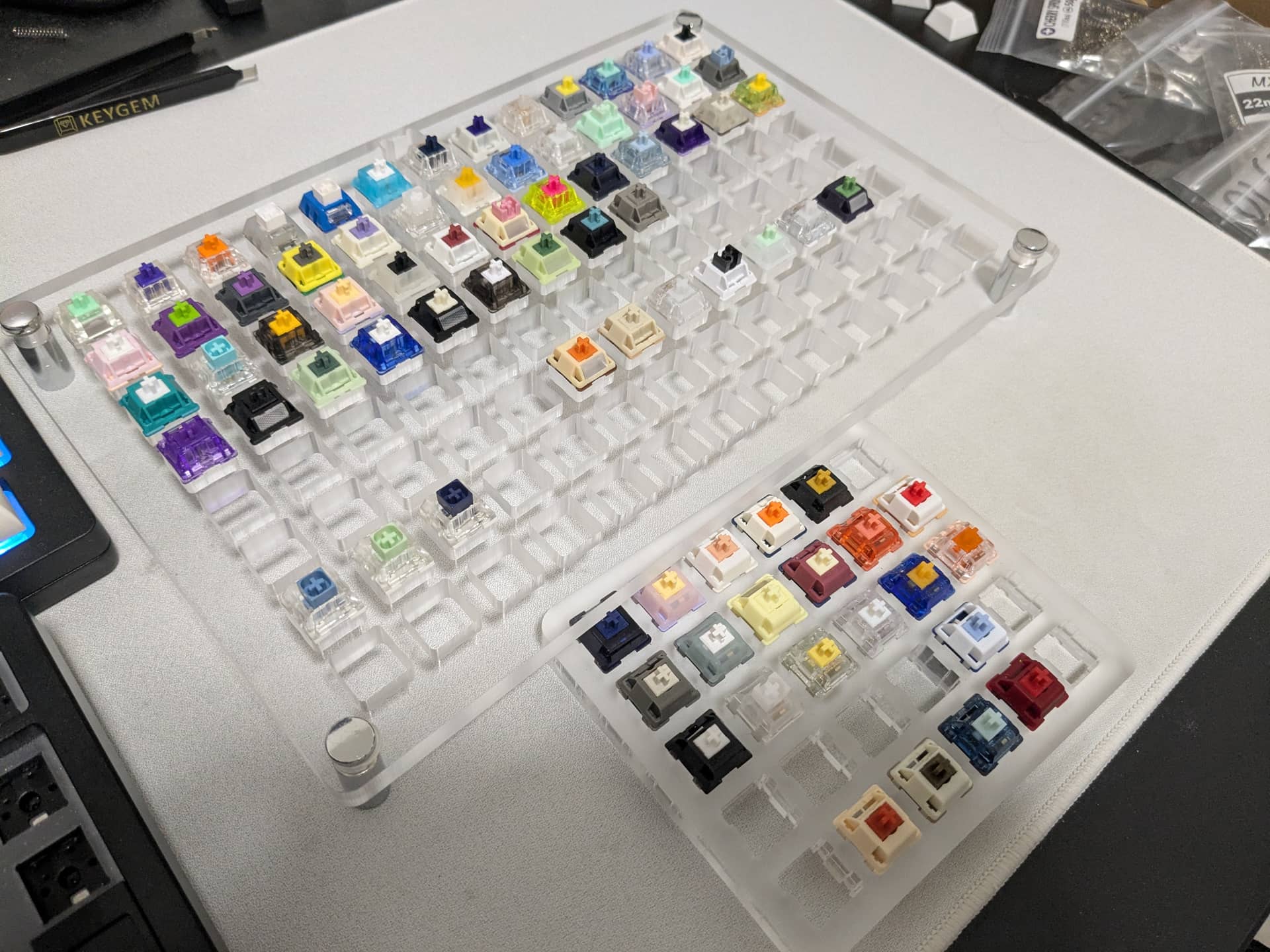

I dug even deeper down the rabbit hole. I ordered single pieces of ~50 different tactile switches from mechbox :smiley: they arrived yesterday. I’ll thoroughly test them and then pick the ones that felt the best to me/caught my attention in some way, like I was doing until now :slightly_smiling_face: my search for the perfect tactile switch continues!
So right now I’ve got around around ~80 different tactile switches in switch tester(s), I should probably make a list at this point :grin: I realized switches are, to me, the most interesting (and important!) thing about building custom keyboards
