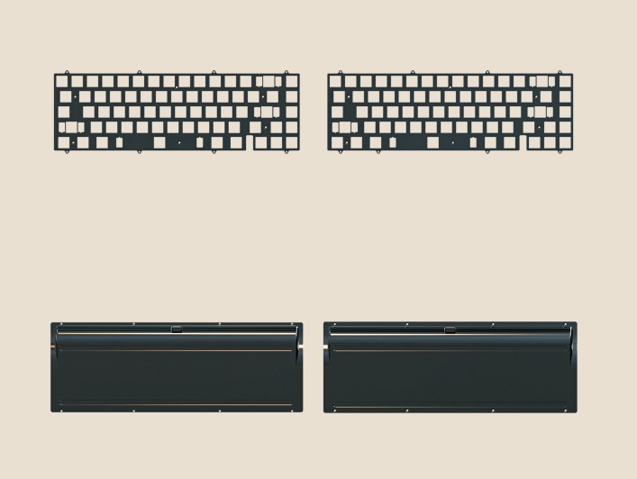

The differences between the draft Jules files and Jules final files are primarily cosmetic:
One plate mount position (left of the spacebar switch) was moved.
Enclosure screw positions were moved away from the top/bottom enclosure seam.
Minor changes to the case bottom “wedge” to accommodate the change to case screw positions.
The entire final enclosure is approximately ~2mm larger in both width and depth.
The images above show the draft version on the left and final version on the right.

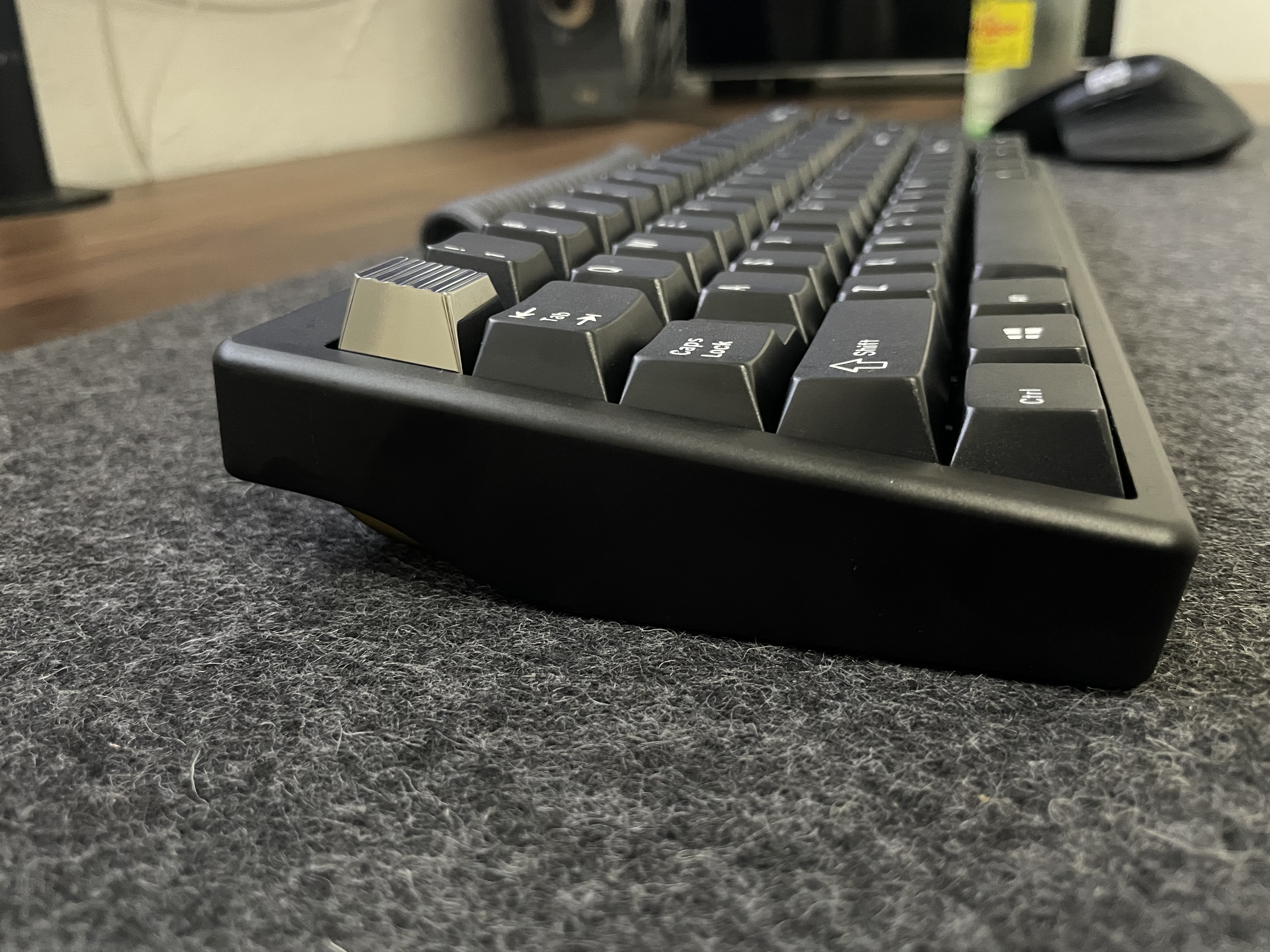

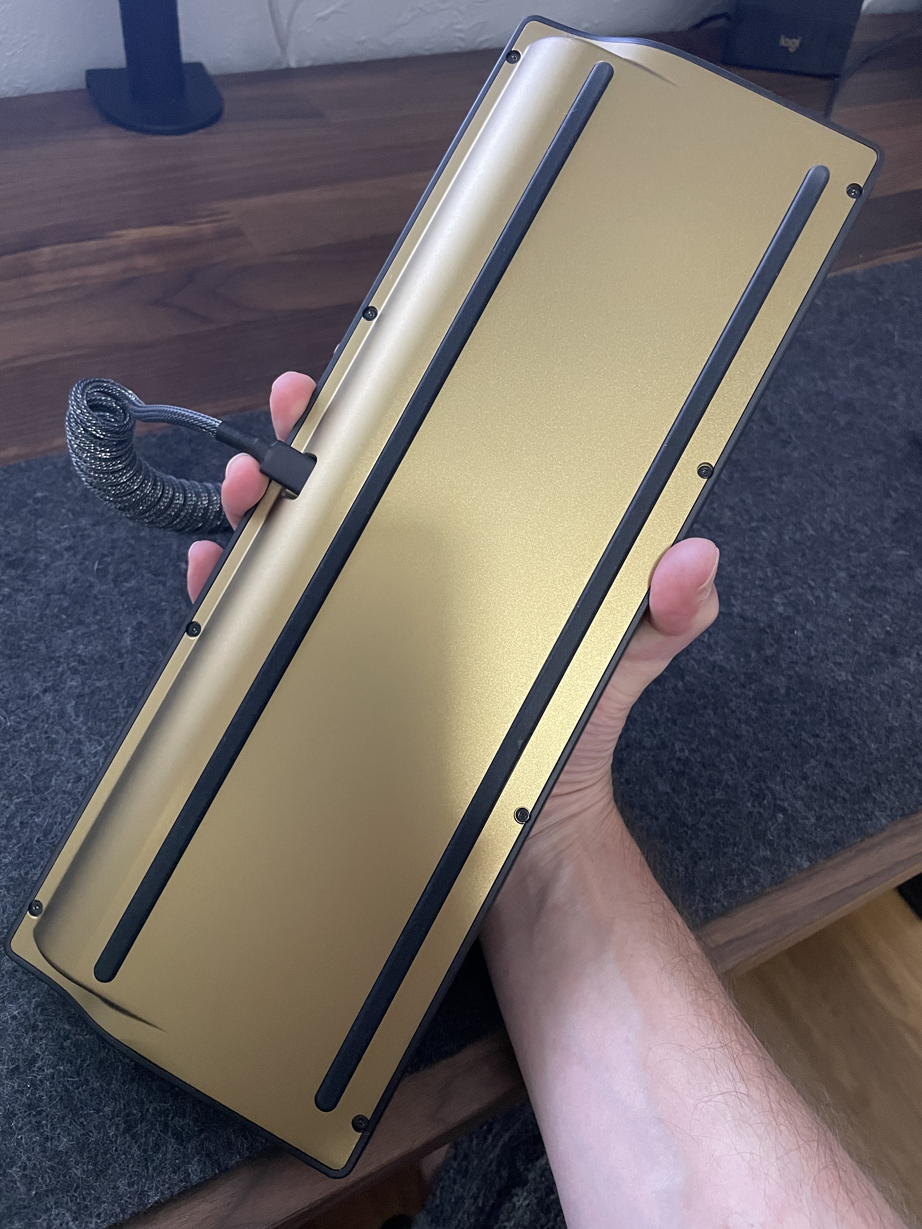

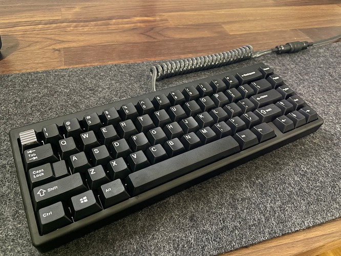

I received mine in the mail earlier this week, and finally got around to putting it together today. Kuro hotswap. It was fun putting it together, and I think it turned out very nice! While I do feel as though Rama dropped the ball as far as customer service goes, I am very happy with the build quality. I’ll be using it as my daily driver for a while.
