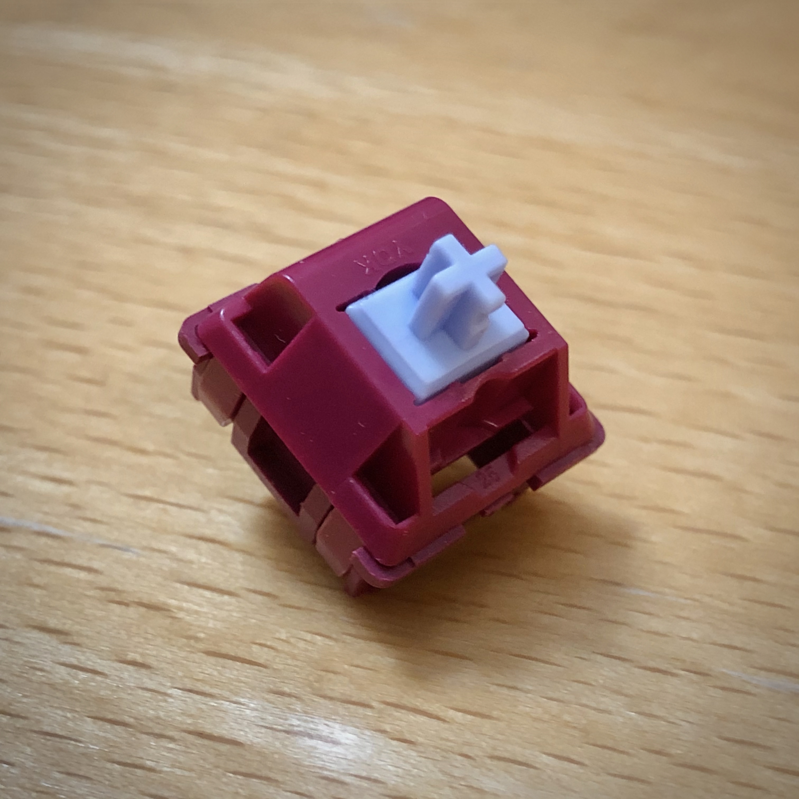

Poli Panda
  • YOK Red Panda housing & spring
  • Kailh Polia stem
  • It’s just like a Holy Panda
  • But extra pretty
Oh, this one’s mostly a gag - but I genuinely do love the color combination between the Red Panda’s burgundy housing and the Polia’s periwinkle stem. A stem more than just a little similar to that of a Halo…
Panda re-colors, JWK re-colors, Halo re-colors… it might make things less simple with all those around, but it does provide more opportunities to coordinate with a theme.

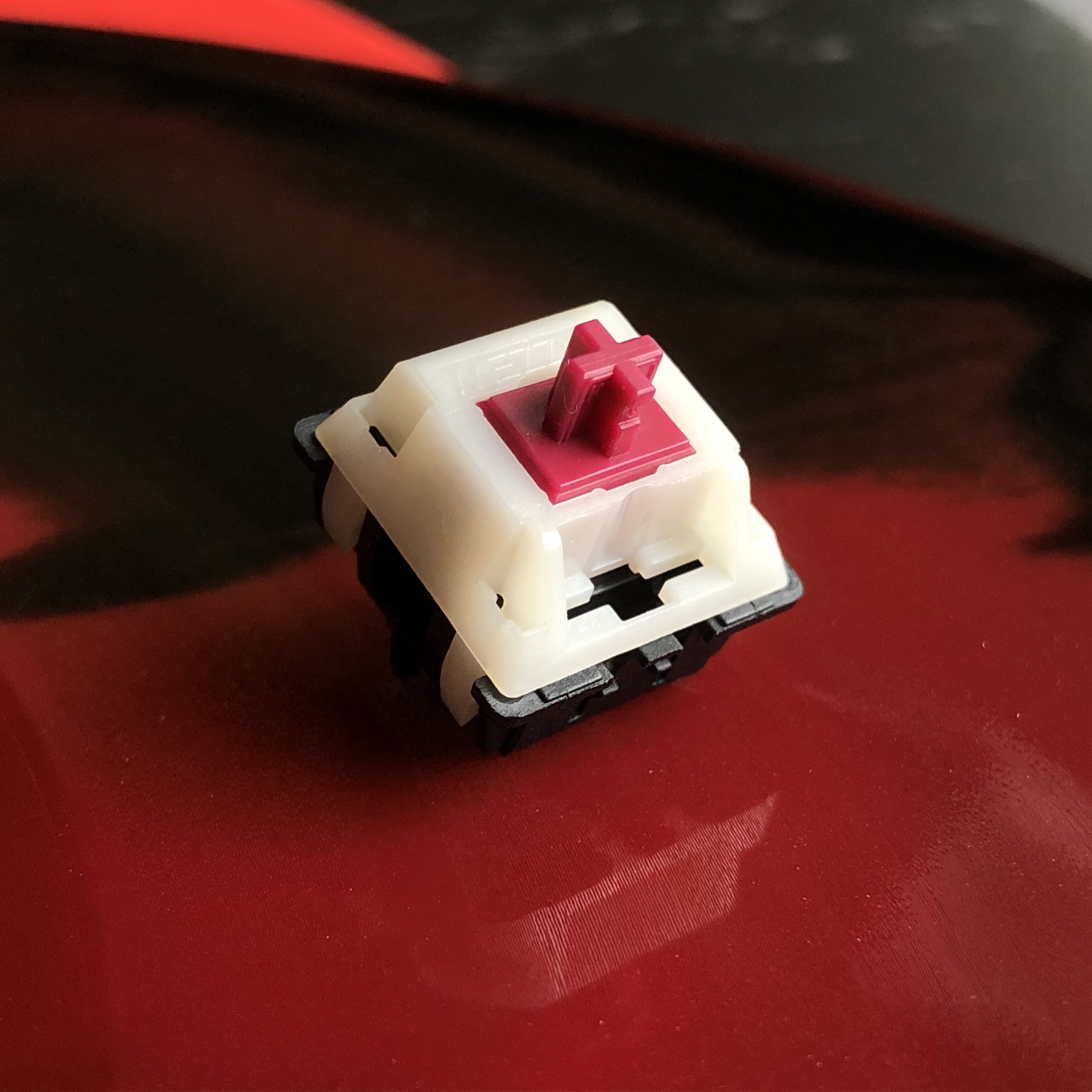

Deadpool ~ aka Gazzew-ron Pro
  • Boba top housing
  • Gateron KS-3 bottom
  • Kailh Pro Burgundy stem
  • “Speed” linear; short travel & actuation
  • Great “tak-tak” bottom-out sound
  • Super stable and free of harshness
A tight, smooth, speedy linear with a distinctive look and sound.
Credit goes to to u/slowshi on reddit for this recipe; you can see their original post with notes and typing test here.
A note about this switch and some others; Gazzew tops on Gateron bottoms leave the leaf without proper retention, so using on a hot swap board is not recommended. For solder builds, just make sure the pins are in proper position before soldering - they can be pulled down if they get out of whack.
I’ll also note this recipe is very similar to @donpark’s Red Tap Dancer, trading the already great Mauve top for the softer, lighter, and tighter Gazzew Boba top.
Flavor-text:
Note: Slowshi’s original recipe calls for a 55g Durock spring or something lighter, but that was a little too light for me, so I decided to go for the Gateron Yellow spring I had leftover from harvesting the KS-3 bottom housing.
Using a black-housing Gateron Yellow as a baseline for comparison, the Deadpool obviously has a shorter travel, but is also notably more smooth, stable, and aurally distinct.
For me, this one’s all about the sound, and I really like it.
Compared to some other switches that bottom-out on a long center post, this one has a much less harsh impact and no associated rattle that I could hear. I think they sound a lot better than my Red Burgundys, for example.
The KS-3 and Boba housings are both a lot softer than, say, any part of a Panda housing - and I think this does a lot to mitigate those high-frequency vibrations while allowing the rest of the unique sound-profile through.

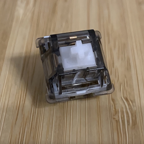

Smokey Naevy (meh, I we don’t really need to name these, do we?)
Recipe:
Naevy stem, T1 smokey housing and stock spring (has to be filmed).
Comments:
Smoother than stock naevy housing. Slightly shorter travel, which seems hard to belive, but it’s like a teeeeeny bit shorter. Medium-light tactility. Bump lasts from the very top to the very bottom of the keypress.
Give it a shot if you have time. It’s nice. Not for those who have disdain for shorter travel switches.
These are some of the older T1 switches. I believe they were the first batch to sell on PrimeKB
I tried this with Lilacs and it didn’t feel as good. Not sure, but I think the housing allowed for even less travel than the T1s.

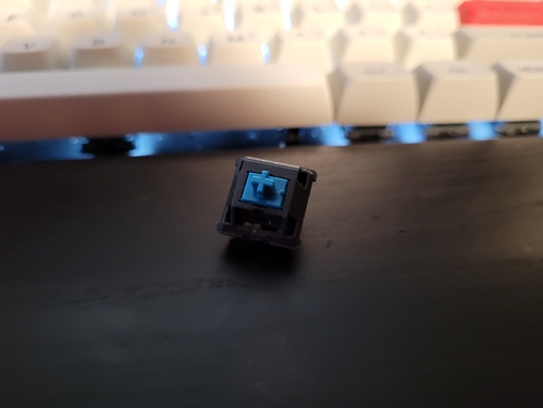

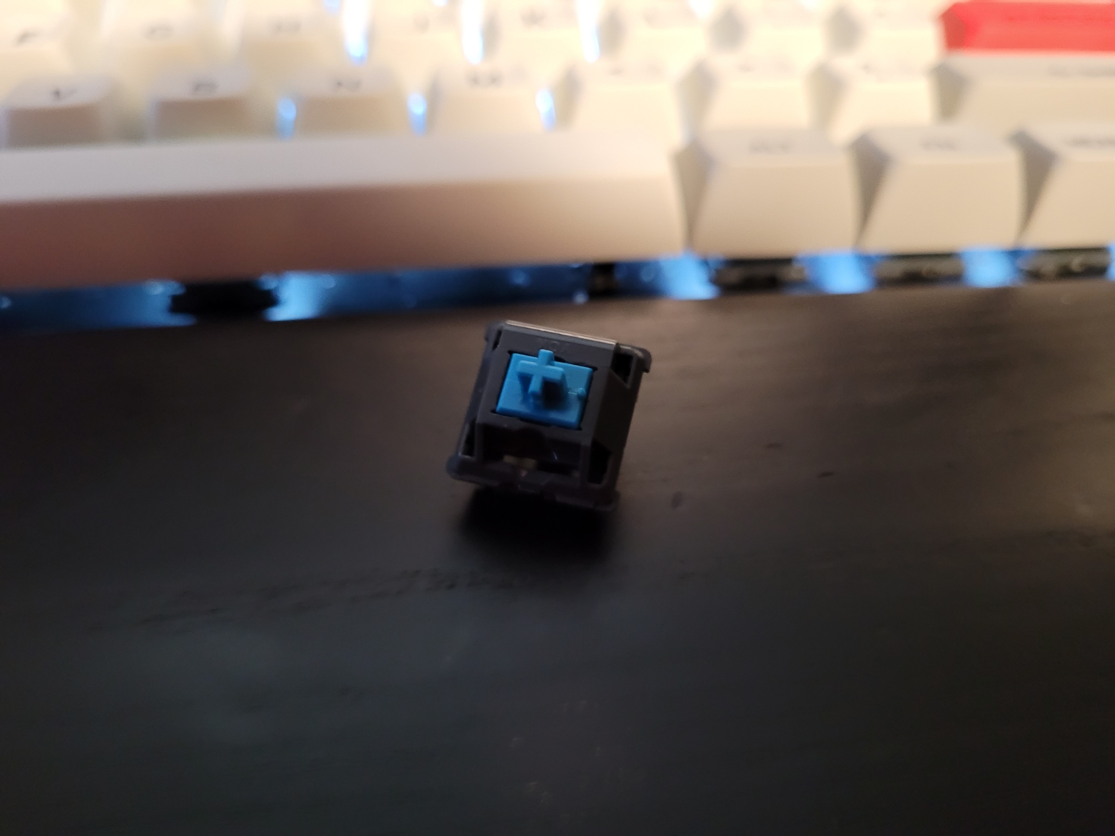

Cherry MX Clear stems in Cherry MX Blue housing. Typing Test
Recipe: Clear stem, Blue housing, 0.15mm TX films, 63.5g Sprit Extreme Slow springs, and Tribosys 3203.
I really like the snappy tactility of these. It’s similar to the medium tactility of my Deskhero POM Pandas but with the bump after the start of the keypress, with what feels like 4mm of full travel for a satisfying bottom out travel after the bump.
My only gripe with this switch would probably be a slight return issue, that carries forward from Ergo Clears. It’s a little bit more apparent than the return issue of Ergo Clears, but it’s really no big deal to me. Using heavier 67g springs did nothing to change this, since the issue is at around the activation force which most linear springs would not have too much energy at. Instead, Sprit 63.5g Extreme Slow springs seemed to do the best job. I love these.
They do sound snappy! If I ever do get some Cherry Clears, all those de-soldered Blues I have laying around will finally have a purpose…
I like naming things… petition to call these “MX Clues” :grin:
I just made a batch of these with Sprit 63.5g progressive and I love em. Putting them on a board soon.

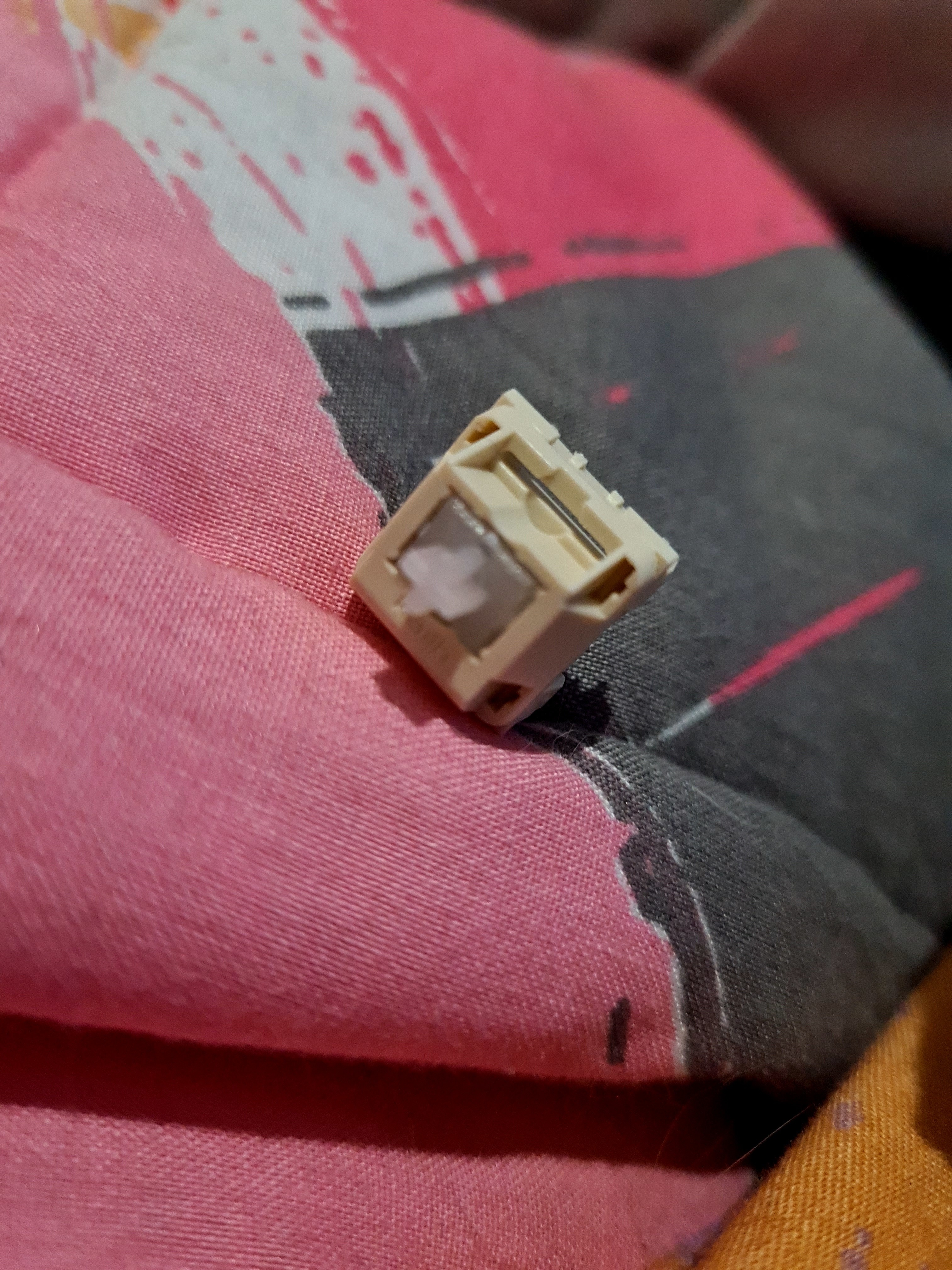

Hi! I’m a complete novice to modding switches and I just rummaged this up from the stuff I have lying around.
I really don’t have a name for it but here we are.
NK Cream Top/Bottom housing
AEBoards UHMWPE Tactile Stem
Lubed with 205g0, legs left unlubed
I’m not very knowledgeable on tactile switches, but from what I can tell these feel real smooth. Tactility is more Zealios than HP, but absolutely zero scratchiness and a pretty nice thockiness on bottom out. The stems are extremely wobbly, though. Not unusable, but really bad tolerances.
Cool. Have you tried films?
I plan to when they come in stock at my local place, circumstances don’t allow for international stuff.
Will help with the wobble.

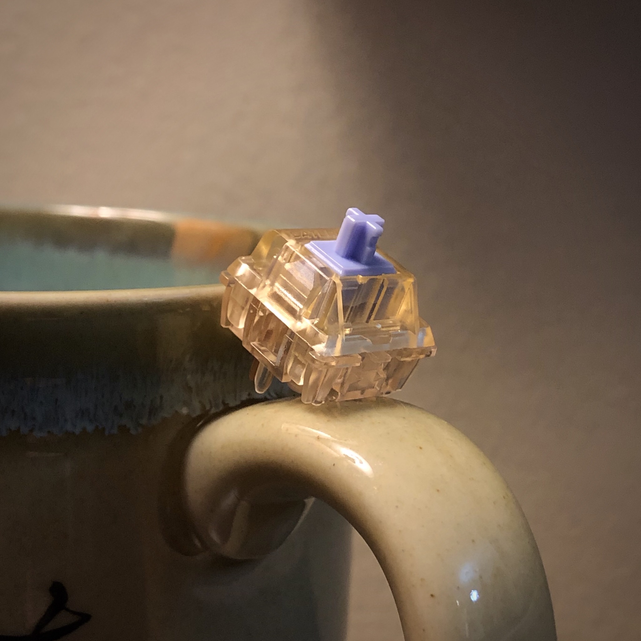

Lilac Tea
  • NK Ink Kangaroo housing
  • Kailh Polia stem & spring
  • Smooth and clean :tea:
  • Round, wide bump :egg:
  • Bouncy & gentle :rabbit2:
Take a walk on the mild side.
This simple mod yields a more clean tactile profile than a Polia while taking off the 'Roo’s sharp edge.
Flavor-text:
Do you want a silky-smooth Ink tactile with a bit less 'tude than the NK Kangaroo? Well. If the 'roo is Surge then the Lilac Tea is, um… tea.
That is to say, while the switch shares a similar tactile bump profile to the harsh Heisenbergs, the relative weighting between the spring’s bottom-out and the peak force of the bump makes for a very different and altogether more gentle experience.
Where the 'bergs practically demand smashing the bottom-housing with the stem, the Polia’s spring and 'Roo’s leaf make it much easier to have a very light bottom-out.
Compared with a Holy Panda, the bump and bottom-out alike are quite a bit softer despite sharing the shortened travel via the center post.
With a gentle appearance to match its character, the Lilac Tea could be a good option for those seeking a high quality tactile switch of the less bombastic variety.
Mild switches are underrated
Are there any other stems similar to a Polia? I don’t own those switcheds, but the mod sounds nice.
