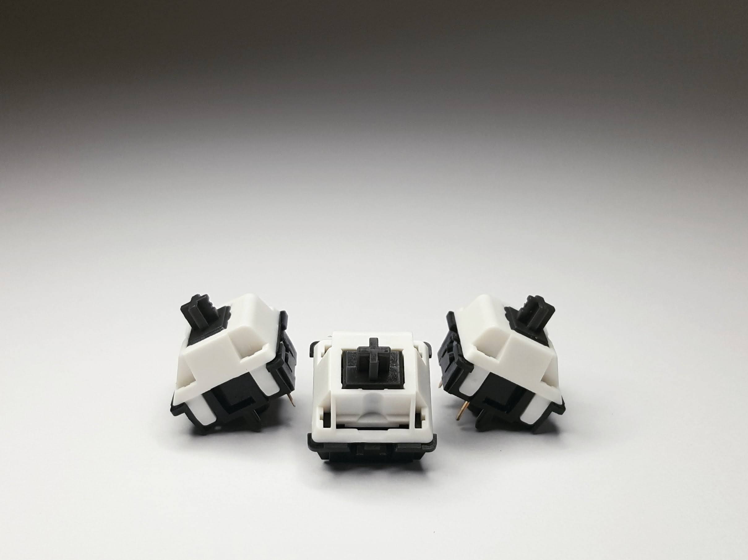

NK Silk/Dry stem + Cherry Black housing
Very mild yet noticeable tactility near the top - It starts about 1mm into the press, not as strong as a bump but stronger than heavier top weight added by long spring. It feels like putting on a tight pair of pants. There is no wobble so the tactility may be from the combo’s extra tight fit. It could also be from how contact leaf shape interacts with stem legs.
It’s feel is, well, funky: not unpleasant and somewhere between linear and tactile switches (tinear?). And the stem doesn’t detract from Cherry black housing’s great sound.
NOTE: I have not yet tried a full board of this combo so the jury is still out on how it feels in-use.
UPDATE: Just tried this combo in-use using my frugal switch testing hack. Unfortunately, tighter fit made the switch feel scratchy.

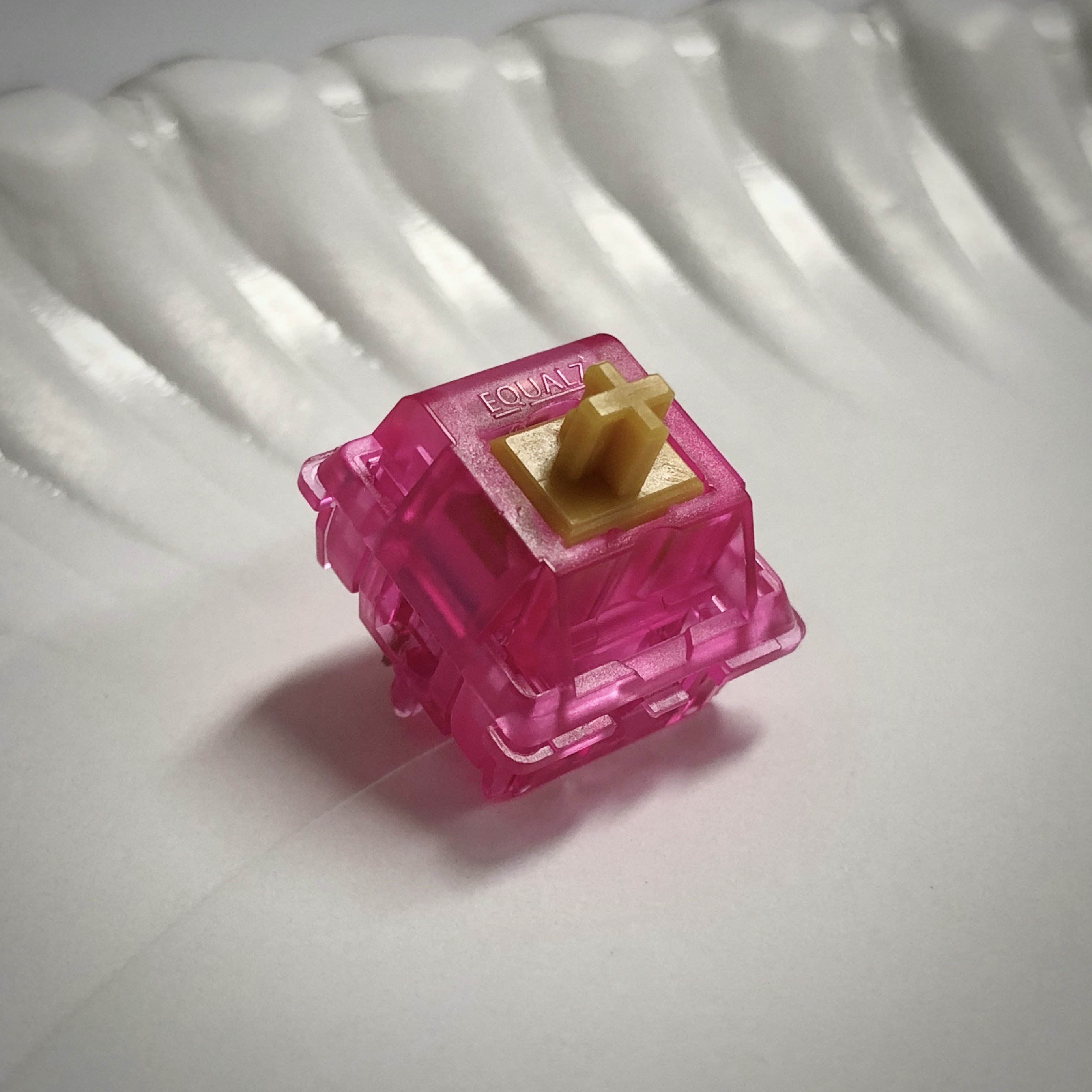

MOO SWITCH (TACTILE)
Moo Switch recipe:
Top housing: Everglide Moyu
Bottom housing: FFFF Tactile
Spring: Stock FFFF Tactile, 67g
Stem: T1 from Kiwi
This came by accident and were leftovers from other frankenswitches I’ve made. Tactility is mild, as it seems the FFFF leaf is quite loose. Very smooth. Dull bottom out but loud return clack. There’s a bit of leaf click.

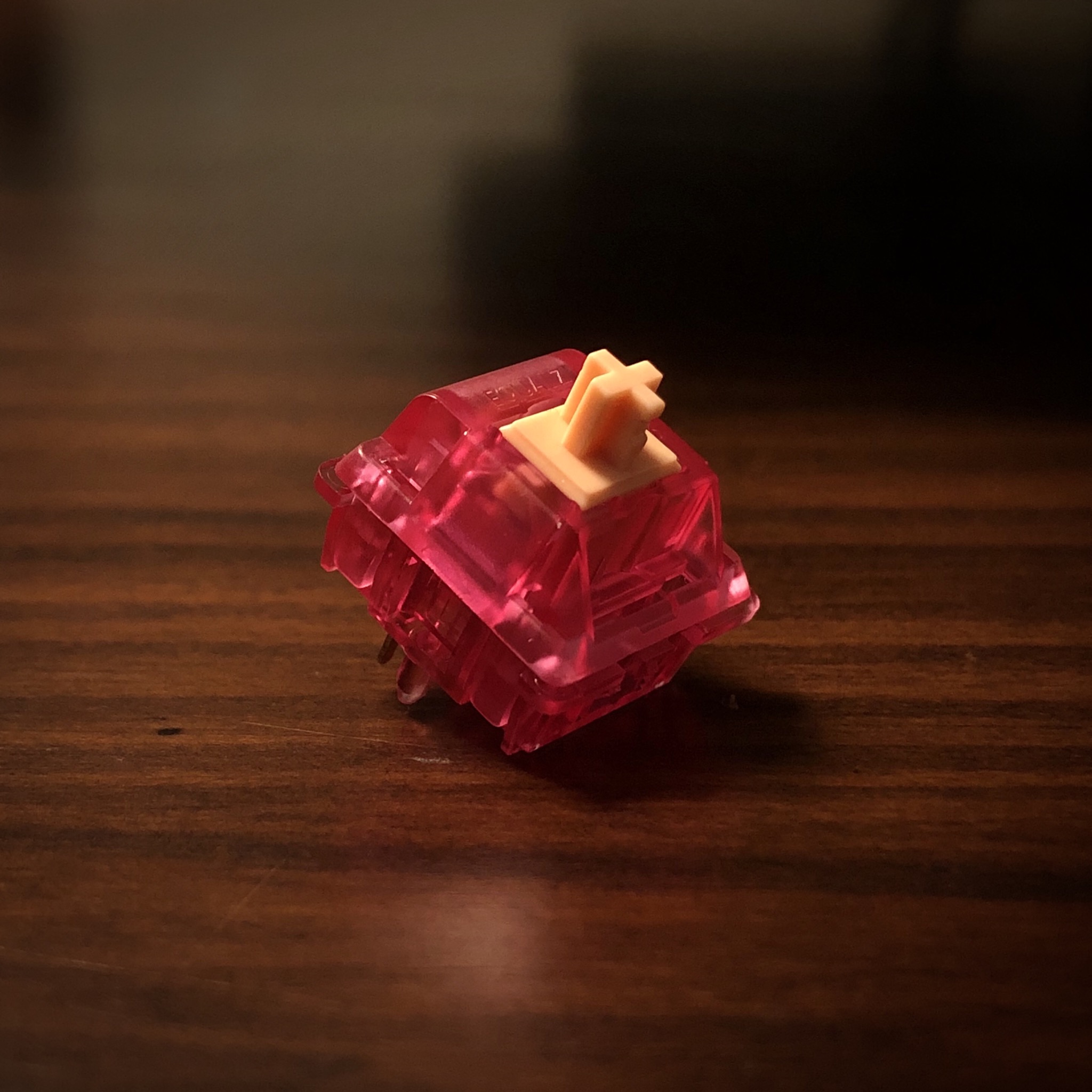

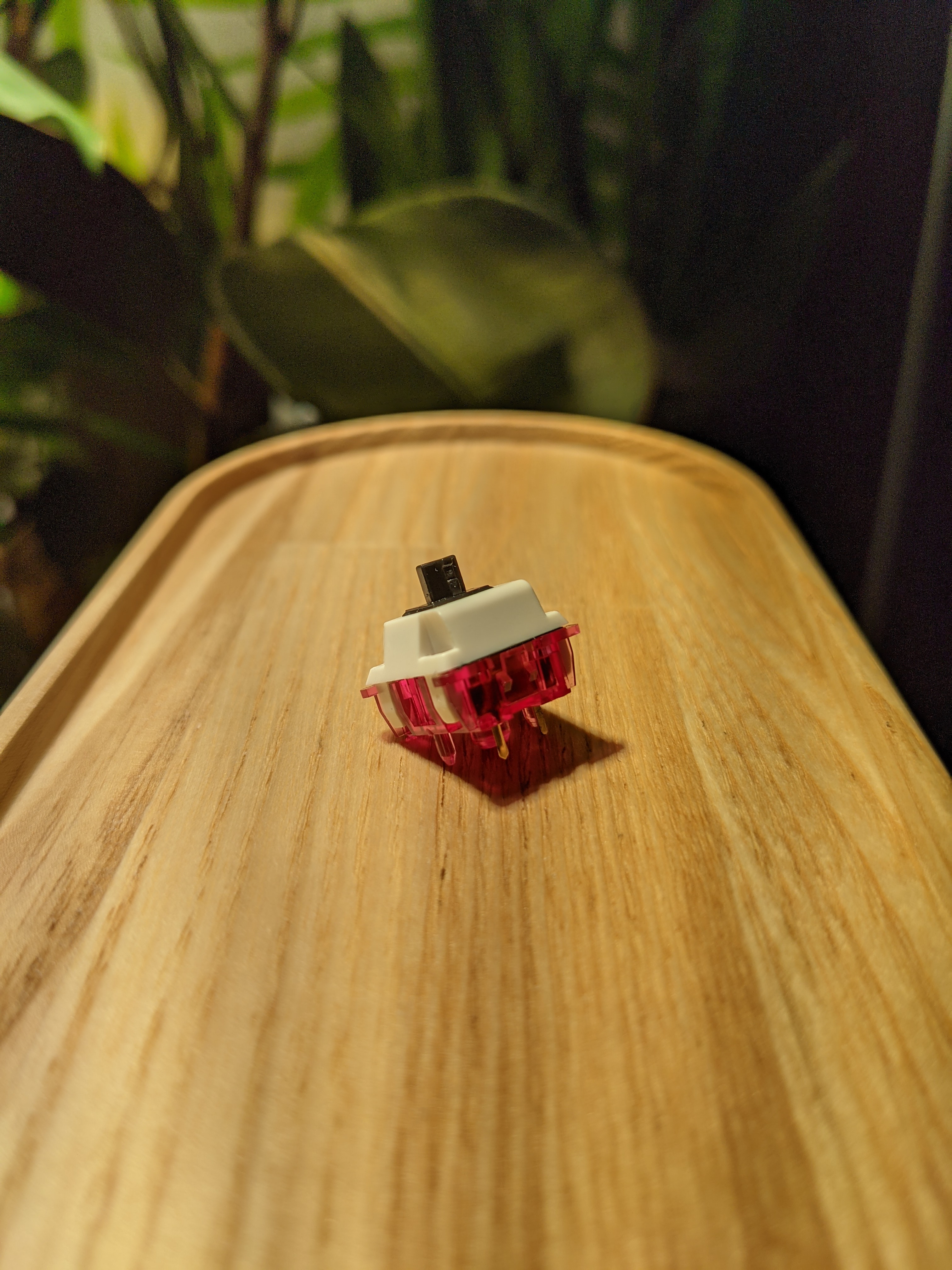

Holy Dragon
  • Dragon Fruit housing & spring
  • Input Club Halo stem
  • Thin films & spring lubing recommended
  • Extra-short travel :pinching_hand:
  • Crisp top-bump :sparkles:
  • Light but loud :boom:
Smooth, short, and snappy. Lots of thock for little effort.
Mounted in a GK61 with cheap foam beneath the PCB, modded GMK stabs, and ABS MT3 keycaps.
I used thin polycarb Kebo films (TX seemed a little too thick), and donut-dipped the springs in 3204 - though in retrospect it might have been better to just bag-lube them in an oil like 105.
Edit: If you’re interested in doing a build with these, I recommend you check out this post about resolving teeter-totter on stabilized keys with short travel switches by @Walkerstop - it will save you some headache when it comes to the stabs.

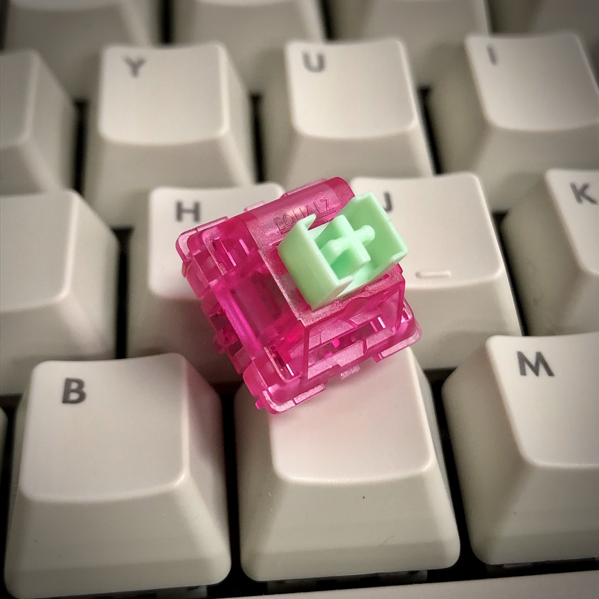

PB & J
  • Gazzew U4T stem
  • Spring is down to preference
  • Very clacky :boom:
  • Crazy short travel :pinching_hand:
  • Still works normally w/ synced bump :+1:
Think of this as a high-tactility speed switch.
Flavor-text:
Kind of like the Holy Dragon, but “more” when it comes to their defining features.
I don’t have the means to measure it, but this switch has a very short travel for a full-sized mx-compatible; easily the shortest I’ve used. The bump remains synced with actuation despite the short throw, though this does make it all but impossible not to bottom-out.
This snappy snack is even more clacky and short-throw than its Halo-stemmed cousin, making this one of the more unique frankenswitches I’ve tried.
Credit goes to @patcoll for suggesting this!

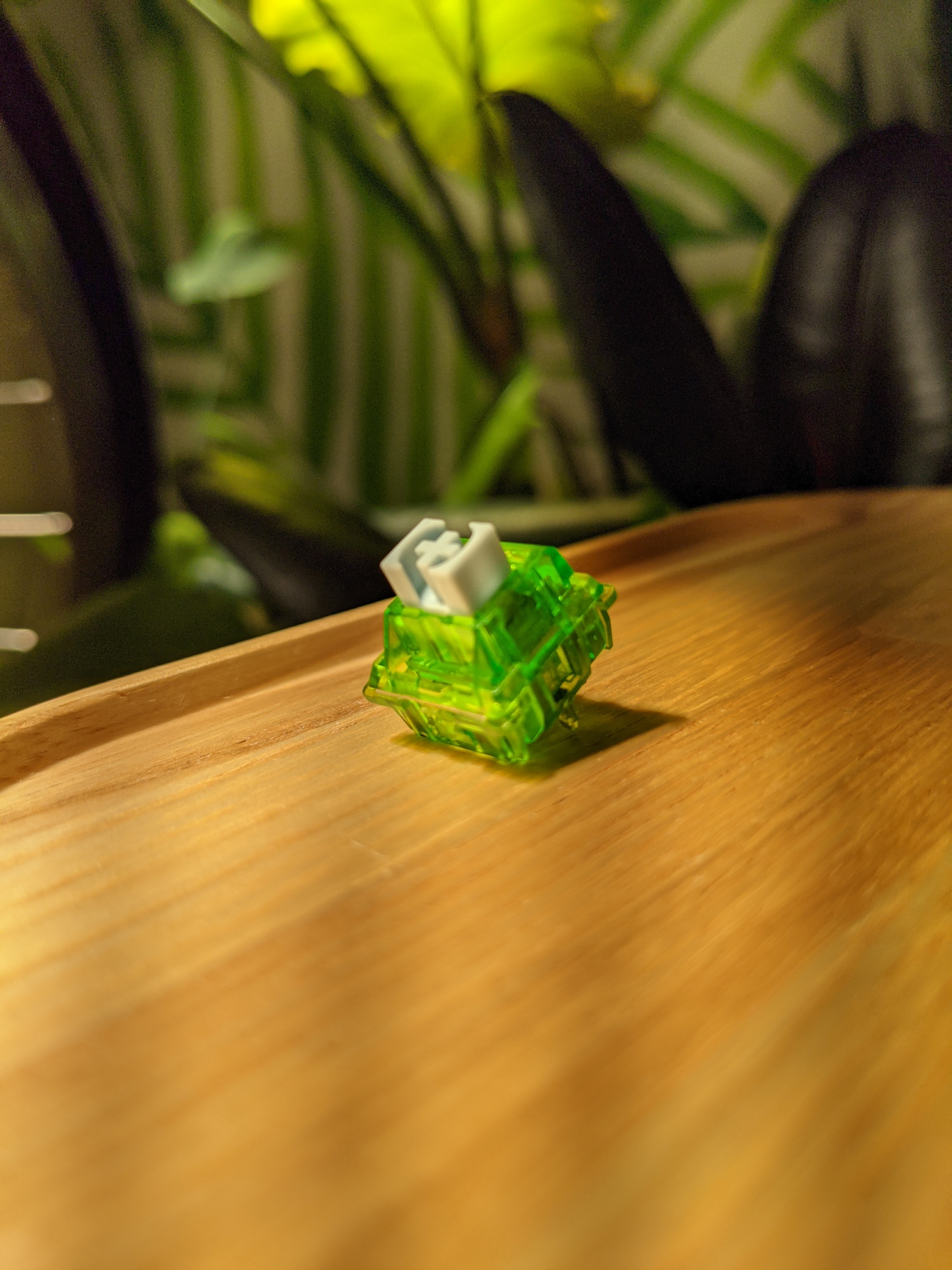

Kiwish
  • Kiwi housing
  • TTC Bluish White Stem and Spring
  • Least wobble of all the switches I have
  • Super stable all the way to the bottom
  • No pre bump travel
Really nice if you like stable tactile switches.
