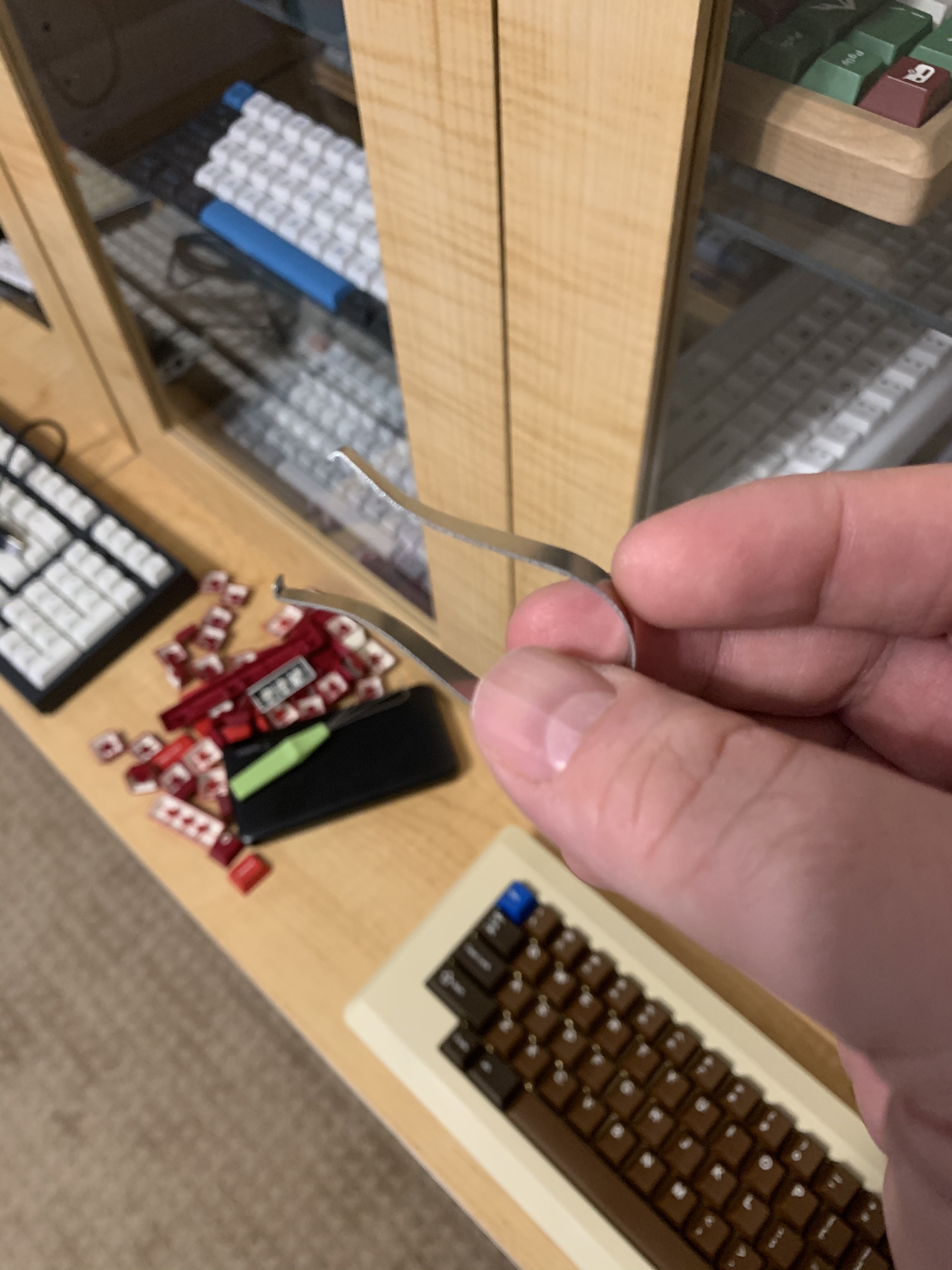

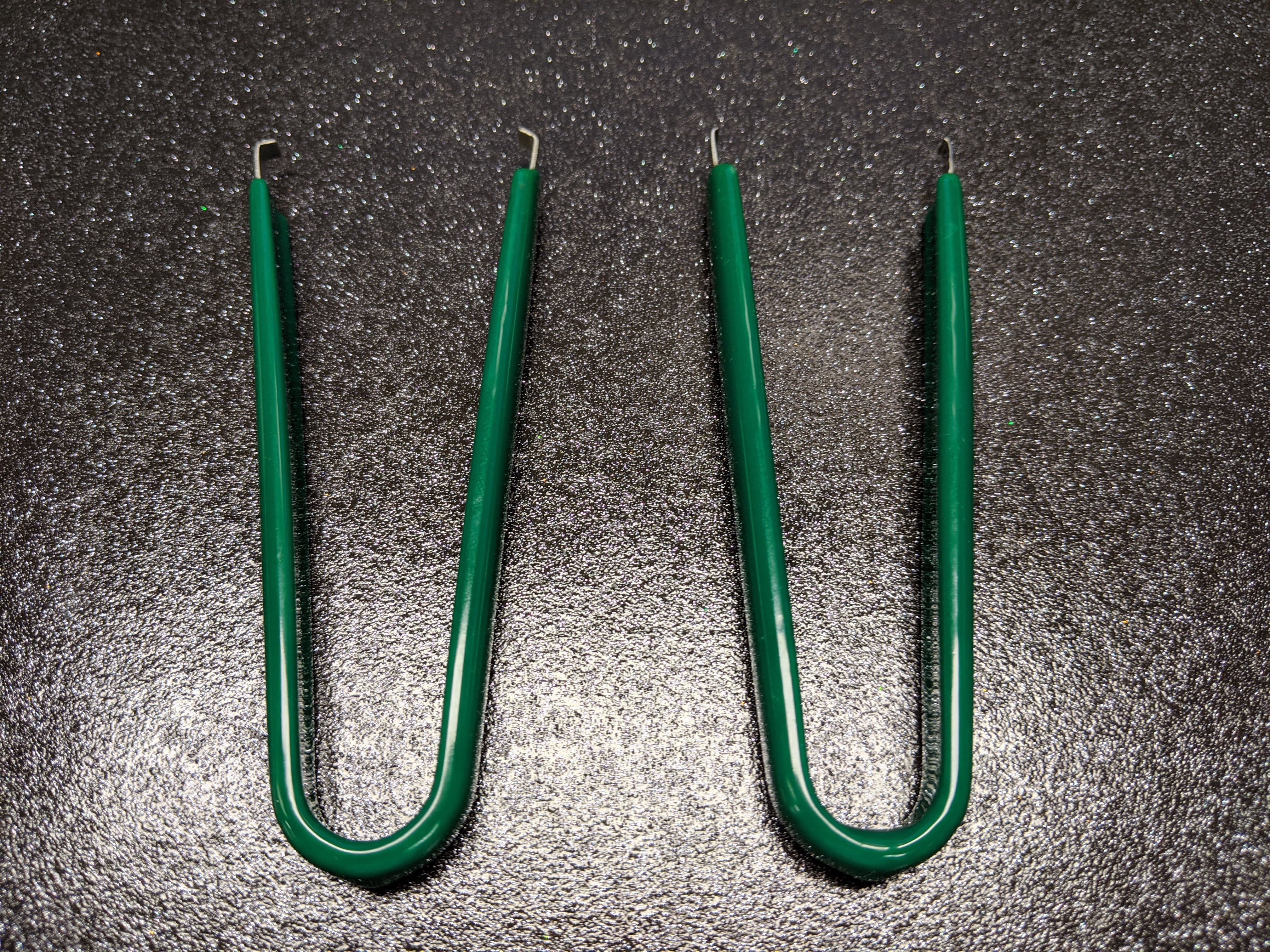

Most of the recommendations for switch pullers are the generic green IC ones. I took the recommendations and these work okay but ended up hulking out some switches causing some of the switch plate retainer tabs on the switches to stick-in.
Looking around at other switch puller designs like Rama and Novel keys the prongs on the pullers are much shorter.

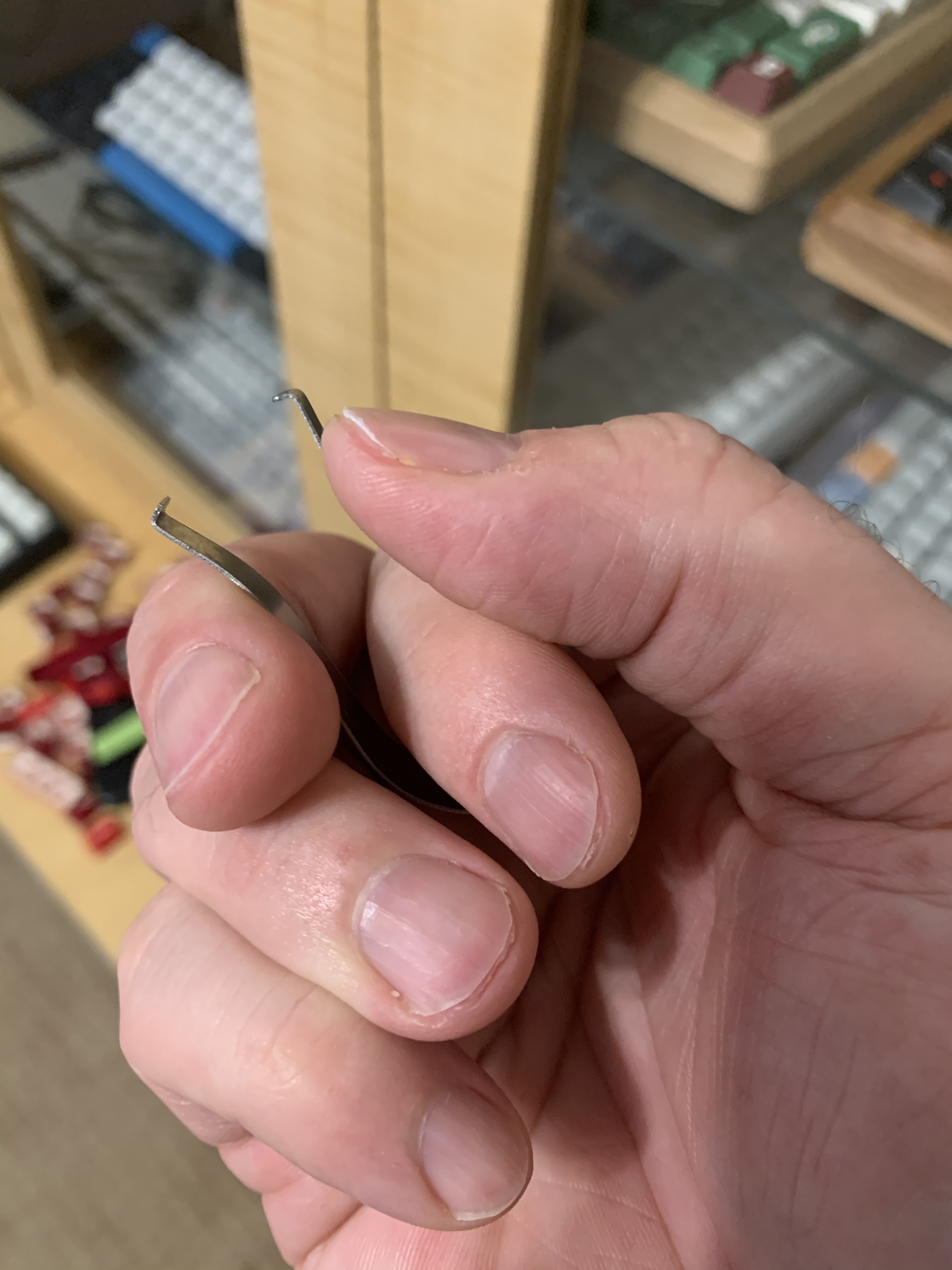

I used a Dremel tool to grid down the prong then buff them to get rid of the sharp edges that resulted in an awesome upgrade. The reduced width of the tool prongs allows the top housing of the witch to stop from squeezing too hard damaging the switch.
I had a white plate to deal with so added electric tape to prevent marking the plate with the tool.
Left is the original tool right is the grinded down version

Well done. Tips are too long for top and bottom rows as is.
Thanks that is a great point I didn’t even consider that when I was doing this
Also saw that problem on the edges of the case with hotswap boards.
Didn’t know it could still work by shortening the legs, thanks a lot for the tip!
Would it not be enough to grind one down?
You can grind down one side and it will work! I did one side at first and confirmed it was okay before doing the other side.

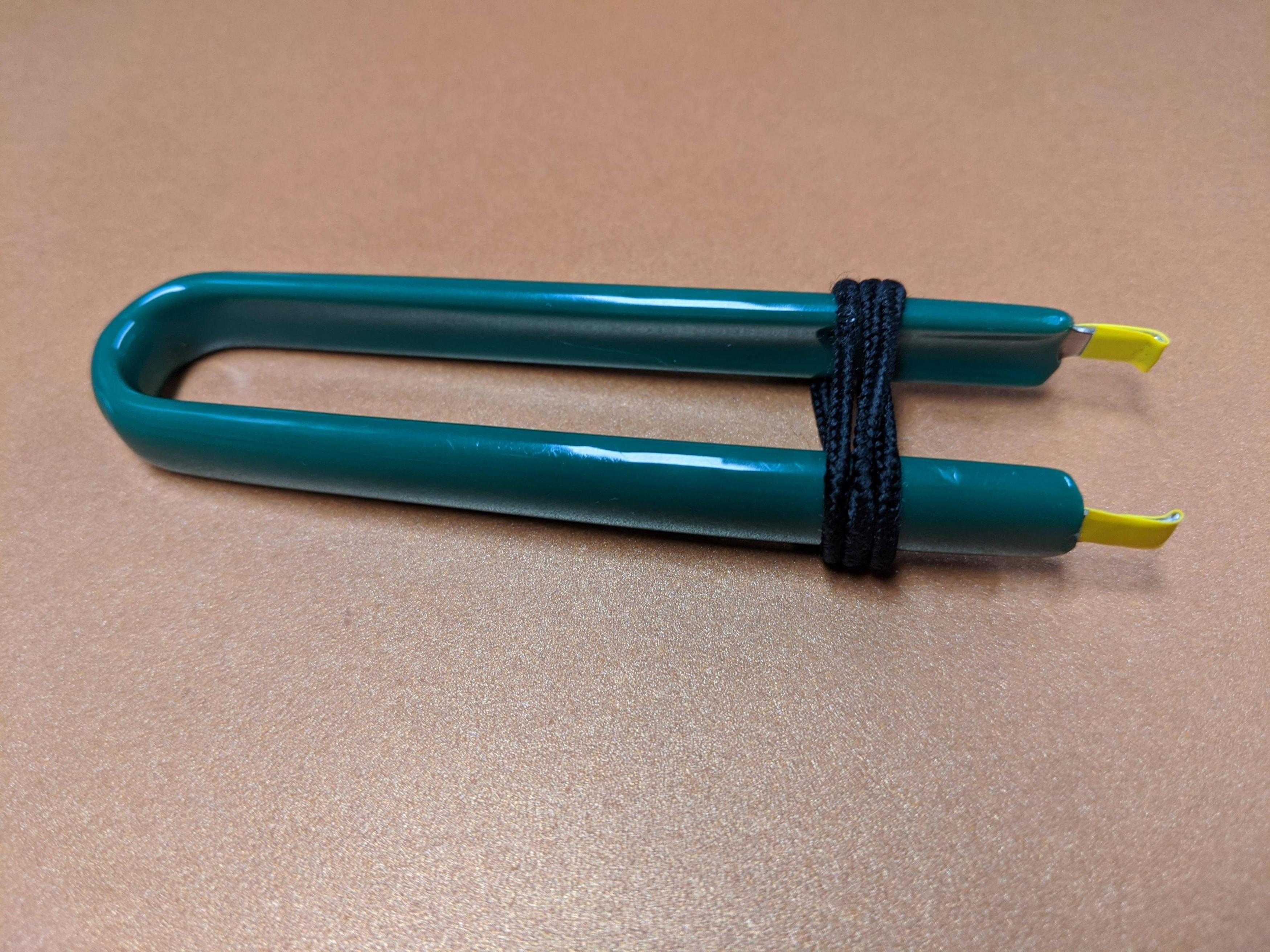

The final version is shown below. Besides grinding the tops used a hair tie band to keep it from opening too much and electric tape on the ends to prevent scratching plates. The electric tape will eventually wear down after a couple hundred switches. However it gives reassurance that I won’t scratch anything allowing for faster work.

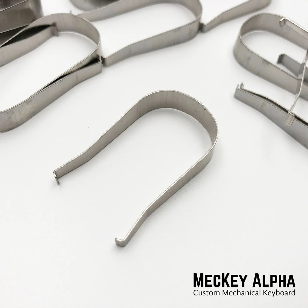

I own a few. They all have issues. The RAMA one is my least favorite. I have 2 of them. They both are designed in a way that seems to promote ripping the top hosing off of my switches more often than pulling the switch from the keyboard.

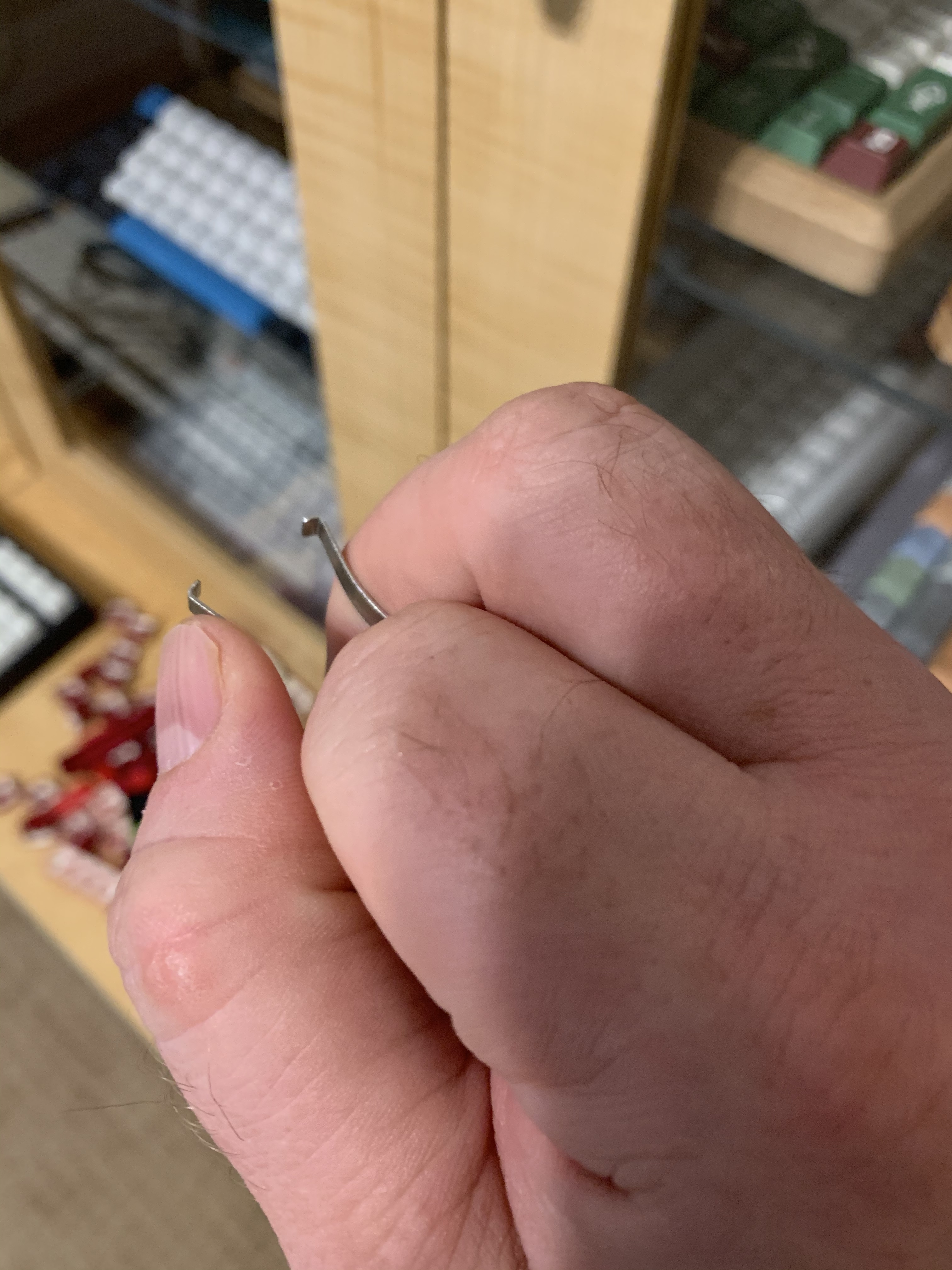

This is the shape I keep it in. A bit different than when it was new.
I place my index finger through the tool and squeeze with my thumb and side of middle finger
Very clever. Thx!
