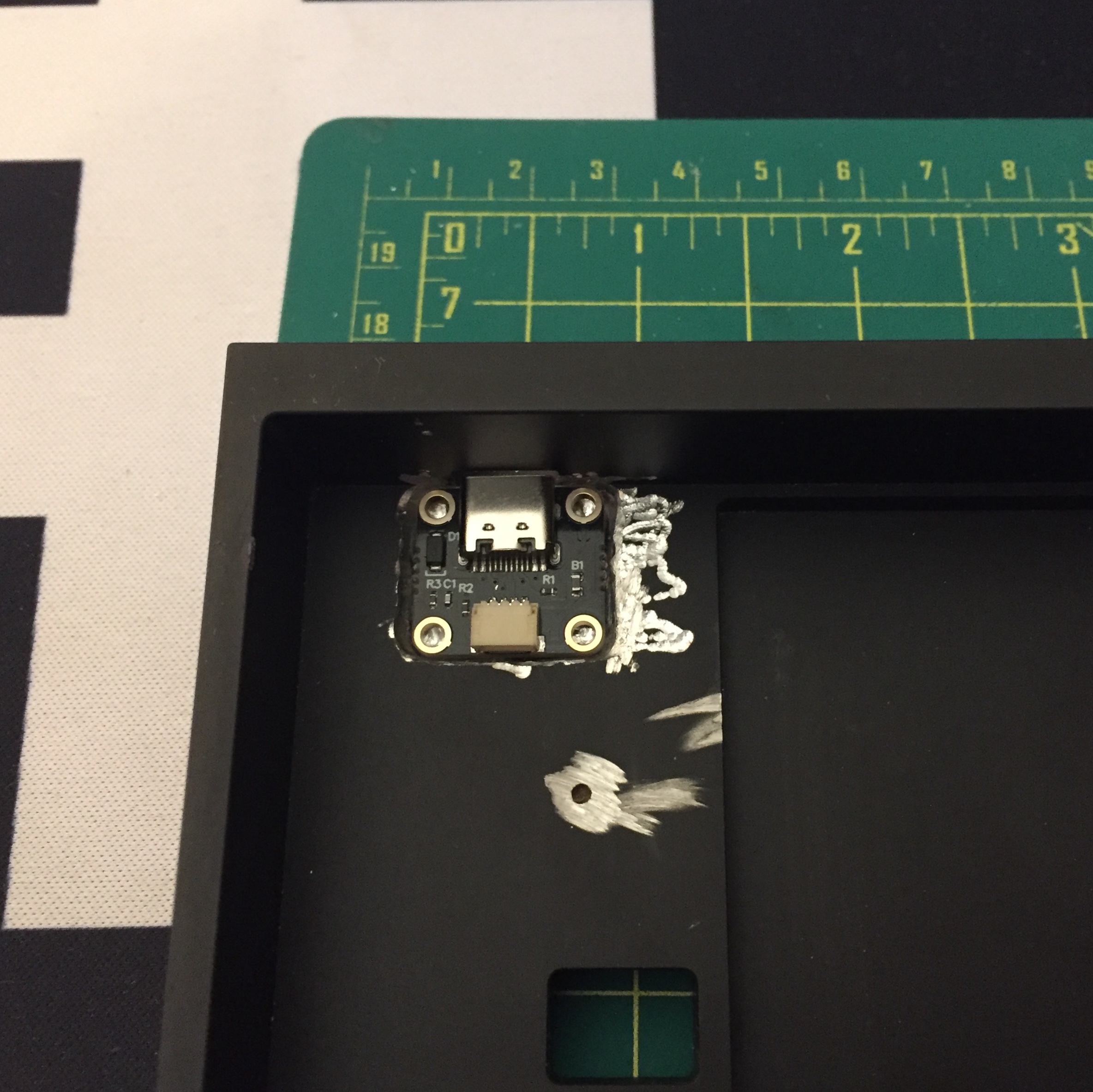

Following up on my shame post from the other day, I took the dremel to my tofu case and cut out space for a USB-C daughterboard…
obviously not very pretty when the board is opened up but I managed not to scratch anything that’s visible when assembled and most importantly it works!
One of the selling points of the plexus PCB I’m using is that it has flex and the newly installed daughterboard does interfere with the flex slightly, though not enough for me to really notice while typing. Eventually I will go back in to make a bit more space so that the port sits bit lower and stops interfering with the flex, but for now I’m happy to have my favorite board back in working order!

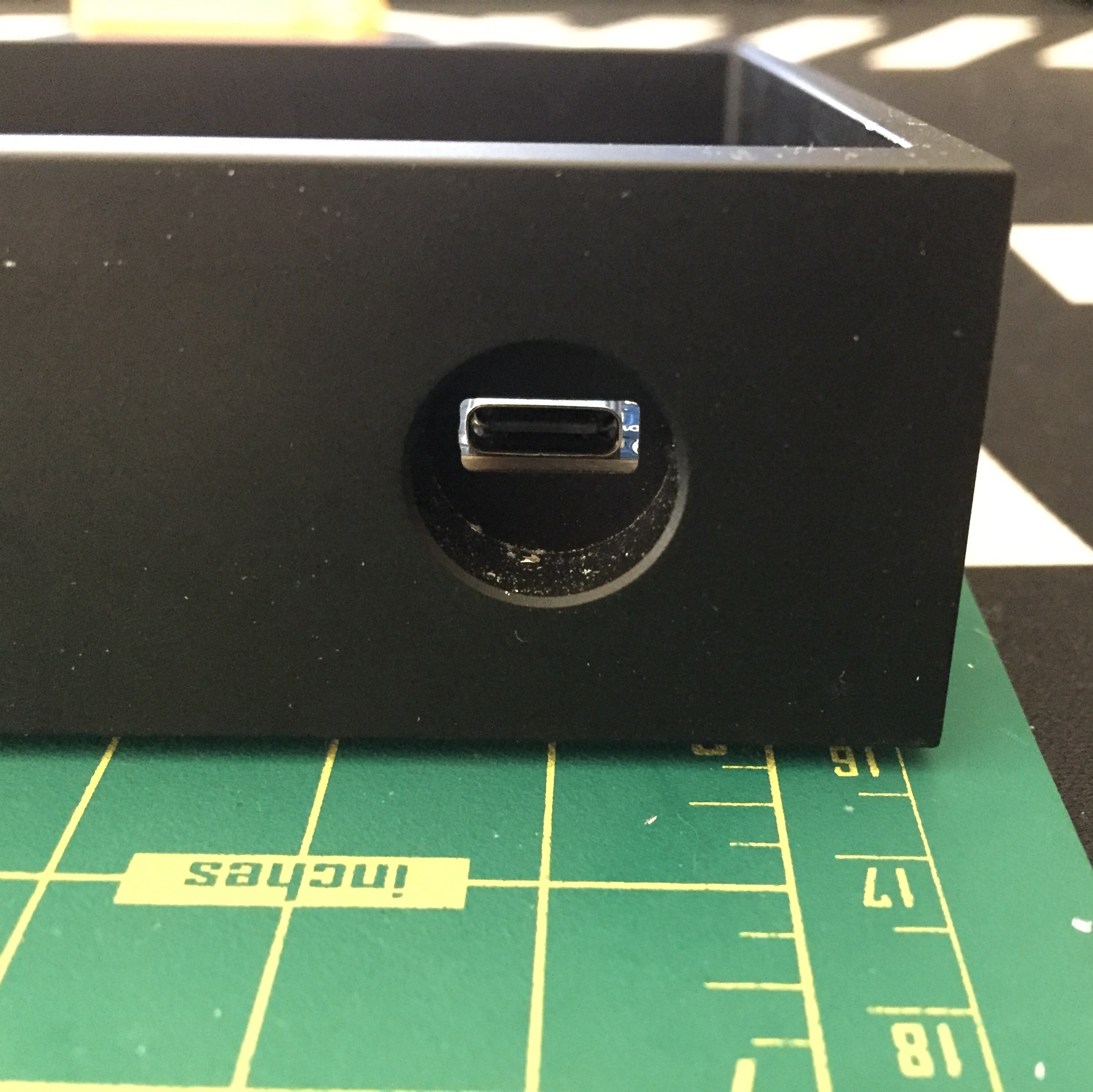

USB-C cable fits through the opening without molding the housing (I am using a zap cable, regular off the shelf cables didn’t fit.

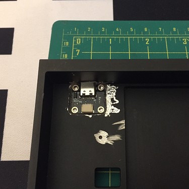

I ran out of screws that were the right size to secure the USB breakout board to the standoff. I had to result to hot glue which I know is lame. But it works and is surprisingly strong. I will swap that out with screws next time I am in there along with a universal usb-c daughterboard

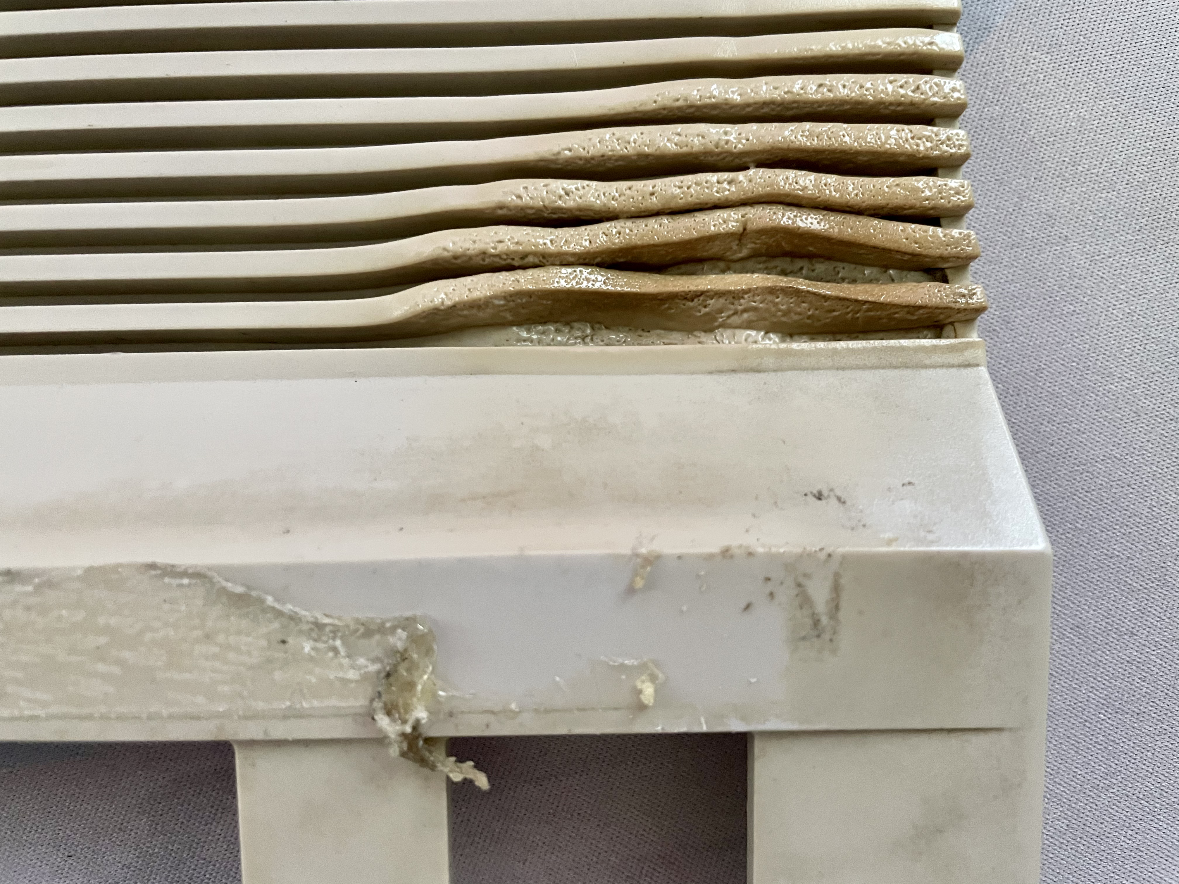

HOT AIR GUN FAIL :cry: :cry: :cry:
I was removing residue from double sided tape with my fancy, new heat gun and was so focused and excited that it was working that I didn’t notice that the hot air was destroying another portion of the plastic.
Argh#@!
oh man. Yeah, that’s the drawback. They work… really well.
Oh no, that poor Commodore 64. :cry:
oh no! goo gone is the key my friend

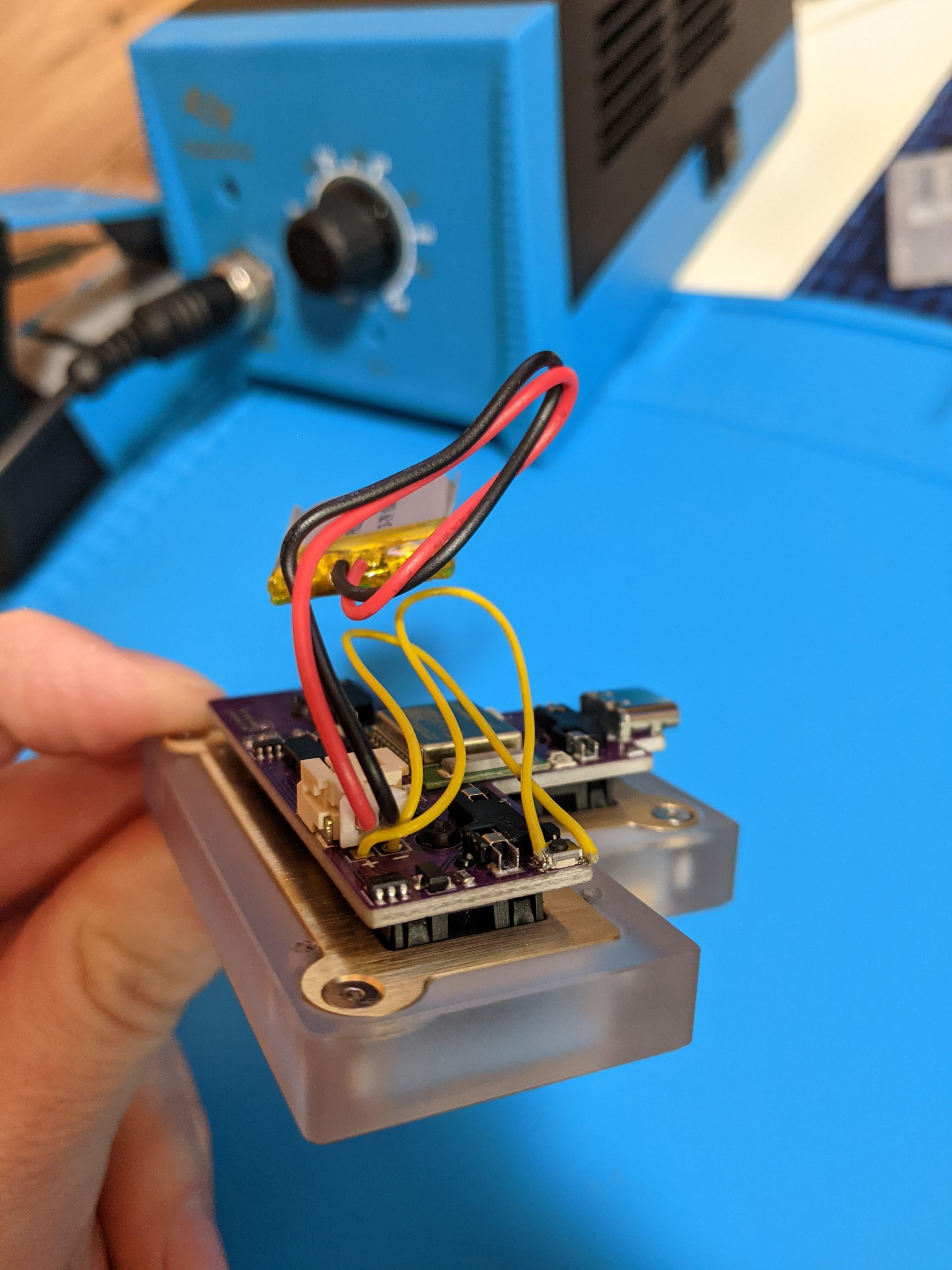

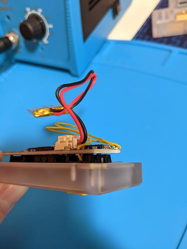

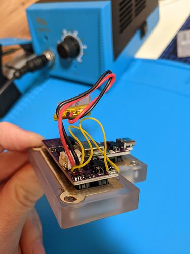

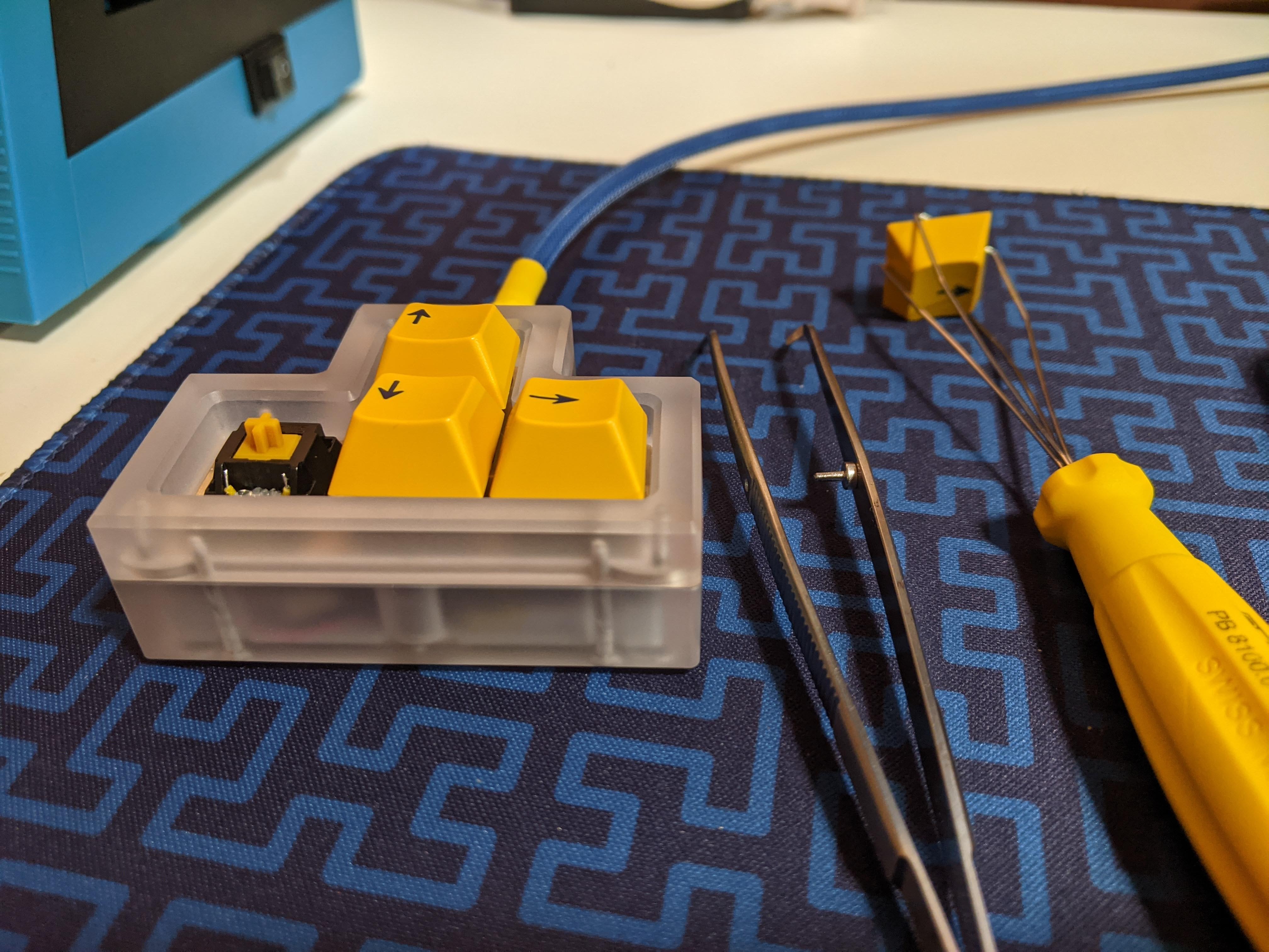

Paw Macropad. Routed the reset button through a switch. Was tired of disassembling the polycarb case every time I wanted to flash it.
Slightly hacky but there was no other way to get to the button unless I wanted to put a hole in the case.
Wiring closeup

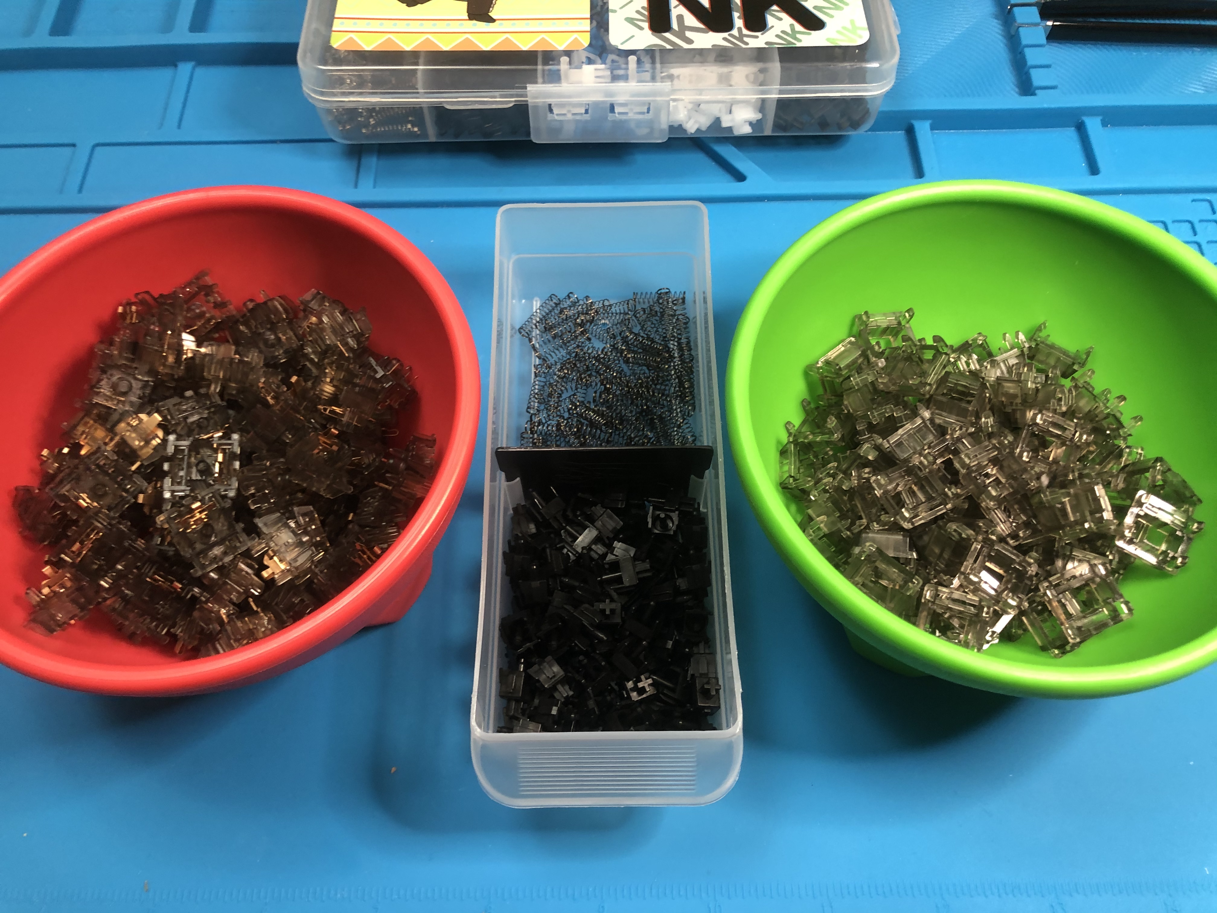

Dis-assembled Ink V2’s, and Kailh Black stems - ready for sonic cleaning.
After that, I’ll be lubing the springs with 106 and the rest with 205g0, and then re-assembling for some very smooth and clacky long-pole linears.
Side note; I’m curious, wondering why the POM stems from Creams smell so much worse in a closed container than other POM stems… I took out my “Creamy Inks” to compare them to a test one of these, and whoof - they stanky. Definitely adding a bit of dryer sheet to the lid of that jar…
And here I thought “creams smell like fish” was just a meme

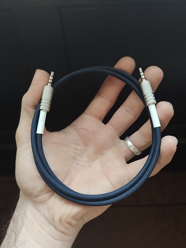

Used Rit DyeMore to dye some clear Techflex black. The black color is not at all interesting. What is more exciting is now you can attempt to better color match your setup more then the 30 or so commonly available colors. Next I am going to do a similar scrap test but with white instead of clear. I want to see if it will help with the depth of the color to reduce any transparency.
Before and After

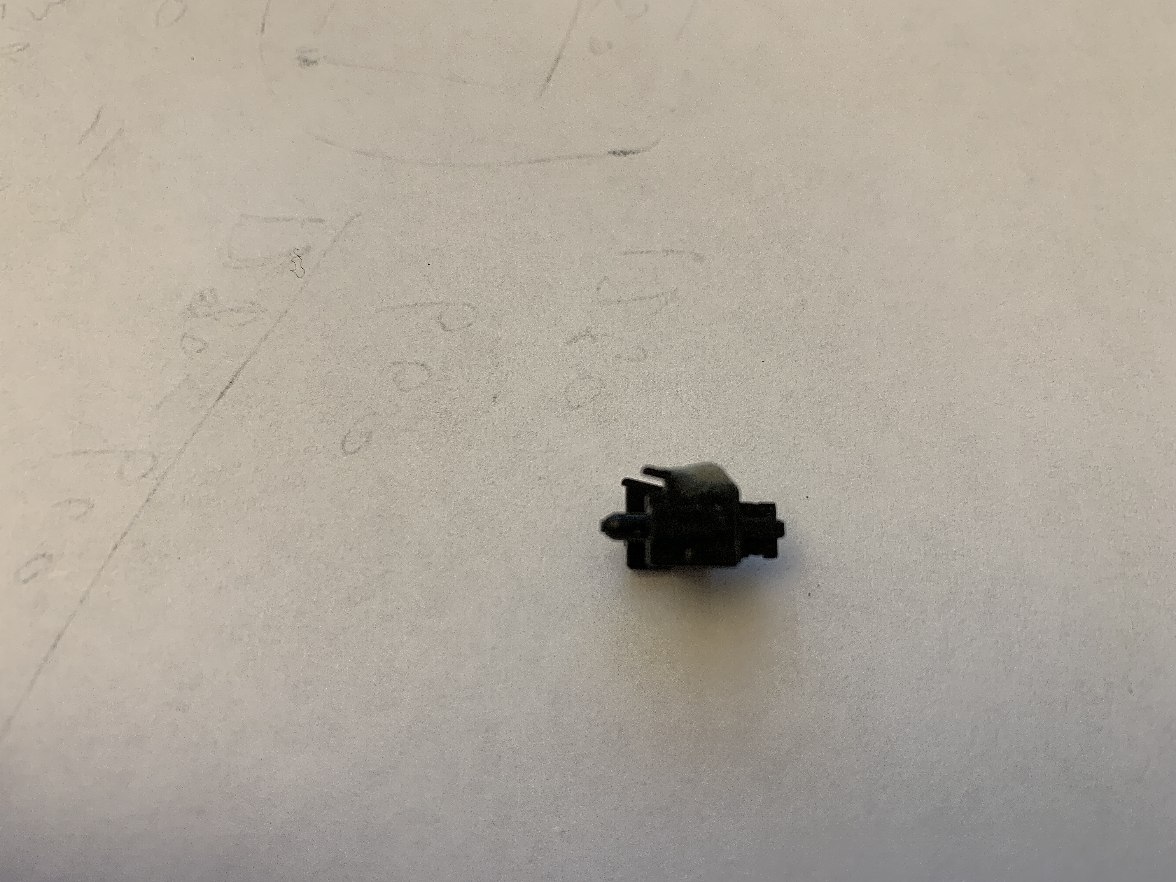

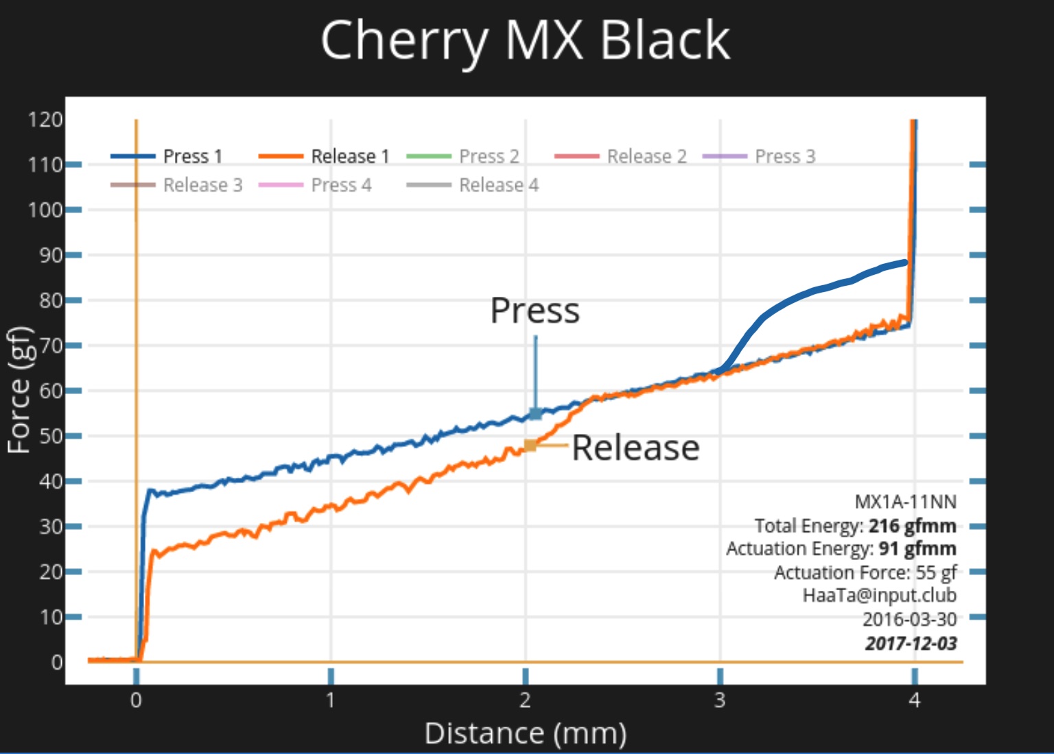

Gentile prototype: I was curious about how a silent linear with abrupt bump near bottom-out feels like. Lack of usual audible feedback on bottom out makes silent linears boring. My design intention is to add a bump to see if that helps. That grey lump is just epoxy clay which will be sanded down after it hardens. It may not bond solidly to POM so :crossed_fingers:.
UPDATE: Expected force graph:
